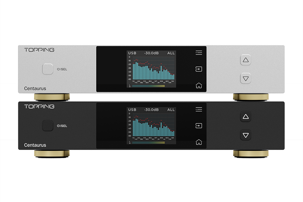

    Enda flere nyheter fra Topping. Denne gangen en R2R-Dac med navnet Centaurus. Ut fra prisen fra Shenzhen Audio vil den ligge på ca. 800 USD. Håper den dukker opp hos Høvdingen også. Absolutt interessant!

    Conclusions
    Objective performance of Centaurus seems to be the best that can be done with R2R technology. Topping brings to the table ultra low noise, equalization and great packaging, offsetting some of the shortcomings of that technology. Ultimately it can only polish that so much. Fortunately, distortion levels are likely still well below audibility, sans the rolled off highs that may be audible to younger folks. They should keep in mind as they change filters that the roll off changes with it.
    Once a month someone asks me what R2R DAC they should buy. They say they have tried all the ESS/AKM DACs and want to play with something new. When I tell them I have nothing to recommend, some accept that, but others downright get angry with me! Now I can tell them to go and get the Centaurus and sleep easy that it at least doesn't compromise much fidelity.
    While I would not buy or use an R2R DAC, I am still going to recommend the Topping Centaurus for those who want an R2R technoloy.
