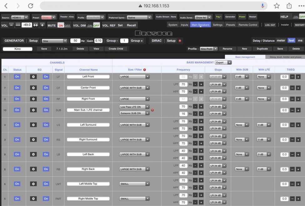

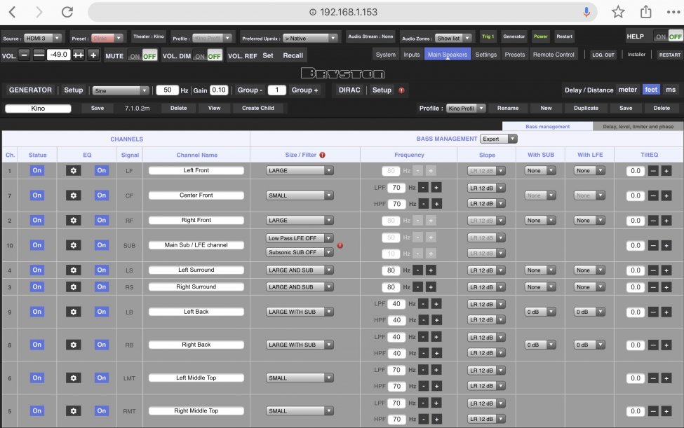

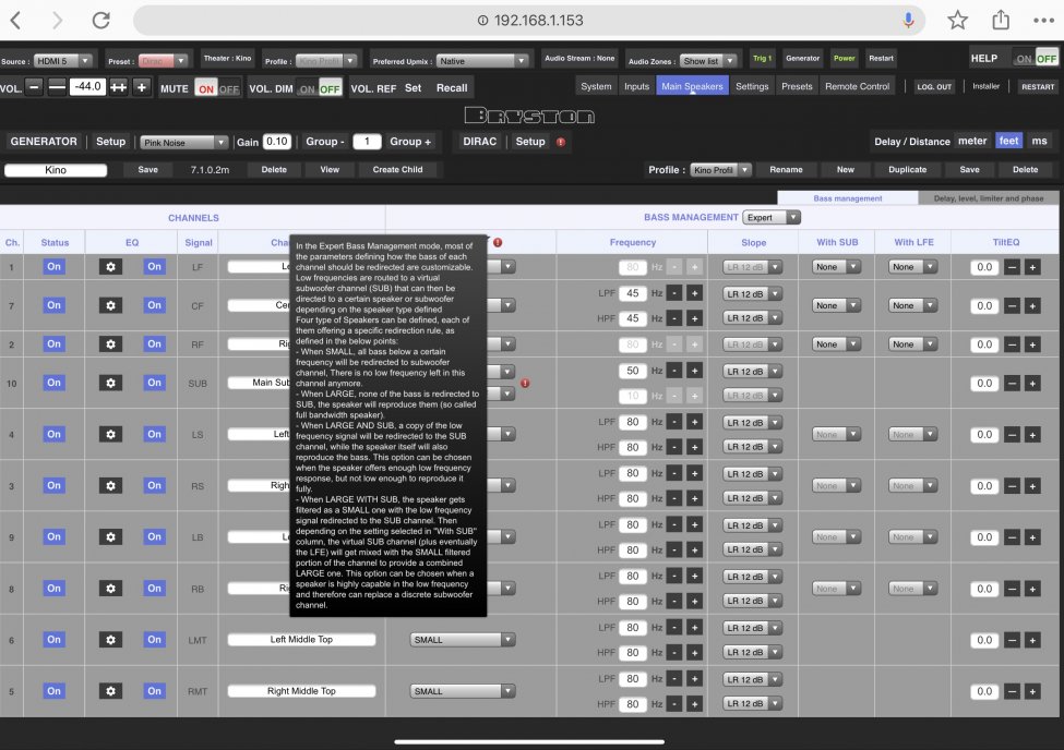

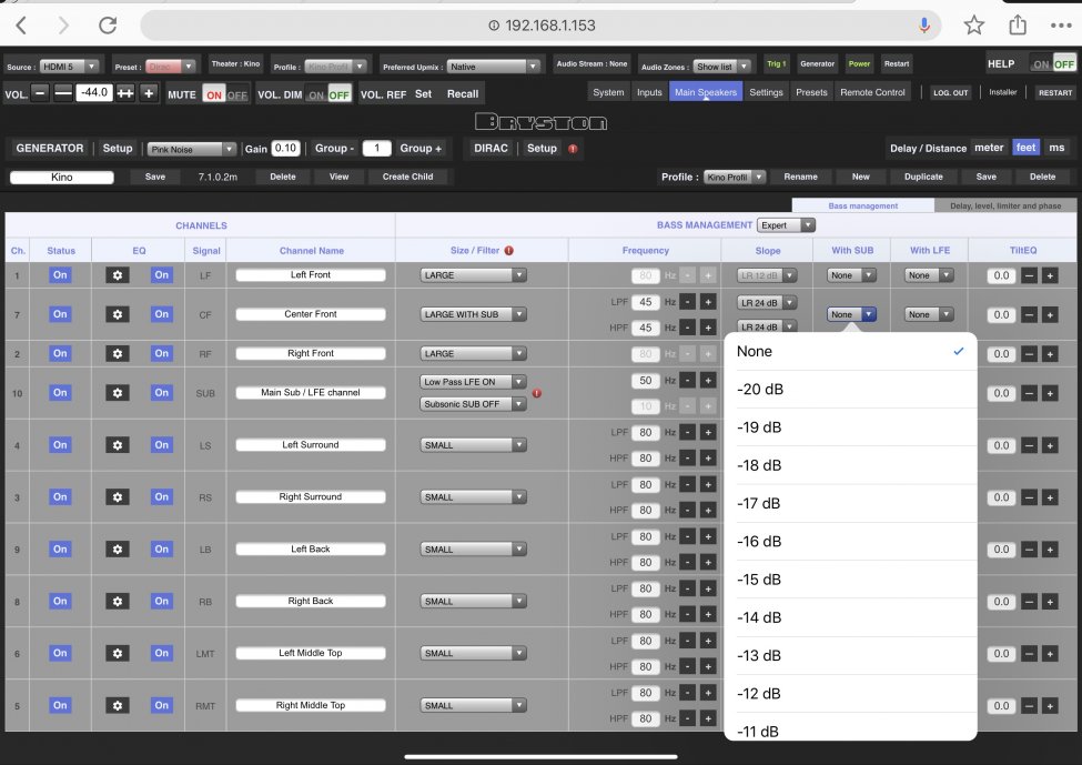

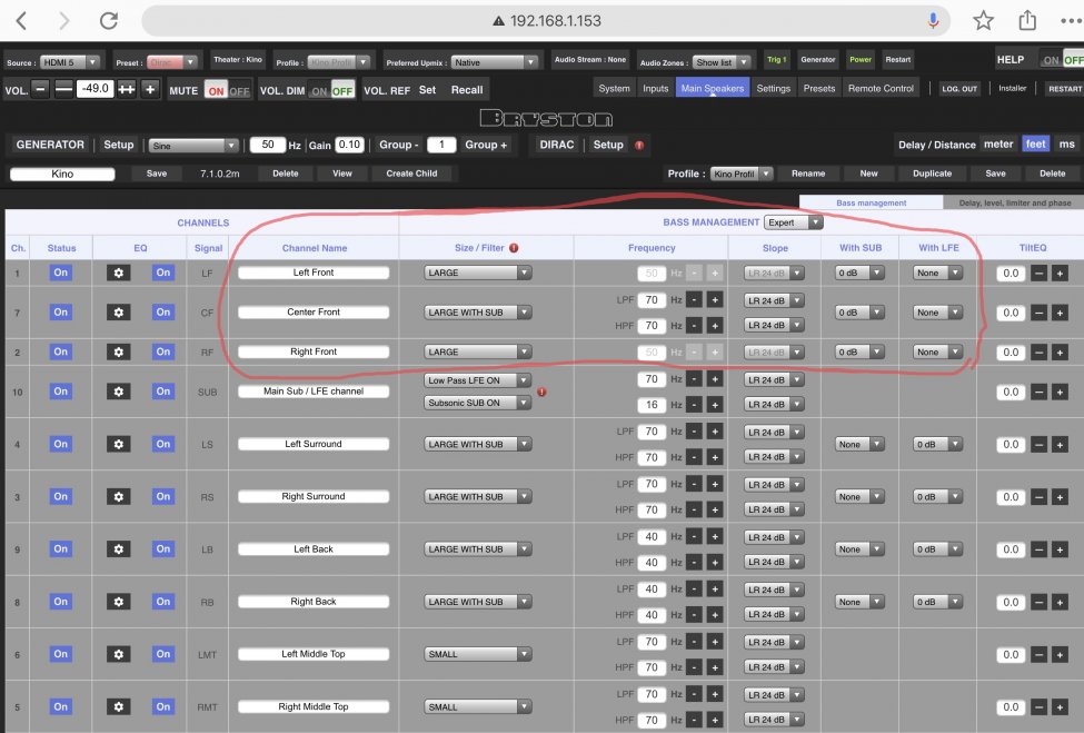

    -Kan du friske opp HPF og LPF med en skjermdump for meg?
    Disse står i dag til 80/80 small for alt untatt mains (large).
    Her er litt mer info fra manual:
    ‘Large with Sub: This special case enables you to effectively split a full range loudspeaker into a “small speaker” plus “virtual subwoofer”. The HPF frequency and slope define the characteristic of the “small speaker” portion. LPF frequency and slope define the virtual subwoofer characteristic.’
    - Iht. min forståelse så skal både HPF og LPF for (eksempelvis) Center settes til 45Hz og slope til 24dB/oktav, men knekkpunkter kan justeres ut fra Dirac sine individuelle resultater, ref. ditt punkt 1.
    14. Frequency
    When the channel is set to Small or Large and Sub, the Frequency defines the point below which bass in this channel is routed to the subwoofer(s). Note that the frequency is the -3dB point along the slope defined in the next column and is not an absolute cutoff point.
    15. Slope
    The rate at which bass is ‘crossed over’ into the subwoofer when the channel is set to Small or Large and Sub. LR 12dB and LR 24dB are 2nd order and 4th order Linkwitz Riley alignments respectively.
    16. With LFE
    When a channel is set to Large or Large and Sub, this channel can optionally reproduce LFE bass which would normally be the sole responsibility of the subwoofer channels. When set to None, no LFE will be mixed into this channel. When set to a figure between 0dB and -20dB, LFE bass attenuated by that figure will be mixed into this channel. This feature is useful when the main channels have sufficient bandwidth AND dynamic range to support the subwoofers in creating an appropriate amount of bass sound pressure in the room.
    Items 16-21 apply to settings found in the ‘Delay, Level, Limiter, and Phase’ section.
    Mains m/stereo sub kan spille sammen med LFE i området fra 50-20Hz.
    Altså for mains kan jeg muligens sette -20dB for a avhjelpe sub og for satellitter må jeg sette None, da alt under knekkpunkt skal penses til LFE sub (samt lekket til mains med nivå -20dB)?
    Sitat: ‘Mains m/stereo sub kan spille sammen med LFE i området fra 50-20Hz‘
    - Når jeg tenker meg om er jeg usikker på om dette er smart å gjøre.
    Årsaken er at Hvis Dirac oppdager at noe nivå fra LFE mangler (lekker over i mains) så vil vel LFE sub boostes av Dirac, men dette blir for mye når mains LFE også spiller med. IOM at Dirac tester kun en kanal om gangen vil ikke dette oppdages.
    Overnevnte fordrer at SPL for sub trekkes ned tilsvarende når mains hjelper til. Dette må evt. sjekkes.
    Generator har ingen info om mediets innhold av LFE (Flageborg var inne på dette) og jeg formoder den heller ikke kjenner til at mains og sub spiller sammen, så sluttresultatet kan fort bli for hot. Jeg har dog en knapp i remote IOS appen som senker LFE output med 10dB.
    Jeg tenker at punktene fra 13 og nedover er i kategorien «fintuning» der du selv må lytte og prøve deg frem.
    LFE er også i den kategorien, men denne fleksibiliteten i bassen er i mine øyne Storm prosessorens store styrke fremfor de vanlige prosessorene så derfor bør du absolutt forsøke å utnytte dette. Enig med din konklusjon. Mains kan nok med fordel hjelpe til i frekvensområdet med sub, kanskje lenger opp også. Det går an å prøve med satellittene også.
    Jeg forstår ikke helt hva du mener med Dirac og «lekker over» i mains. Jeg tror du skaper en problemstilling som ikke er noe å bekymre seg over. LFE kan nok bli for hot, men i mitt hode er det en tuningssak hvor det bare er å justere ned i så fall.

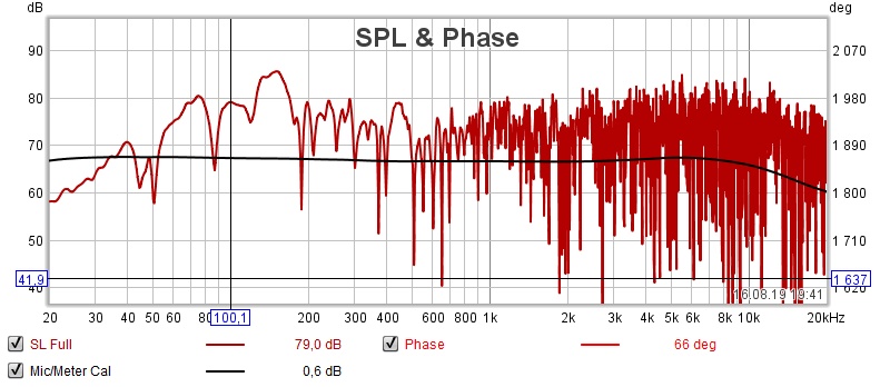

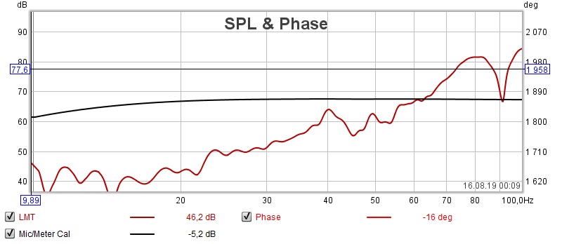

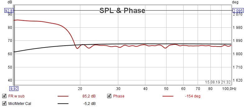

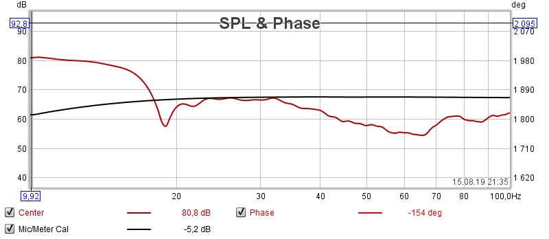

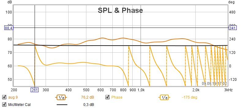

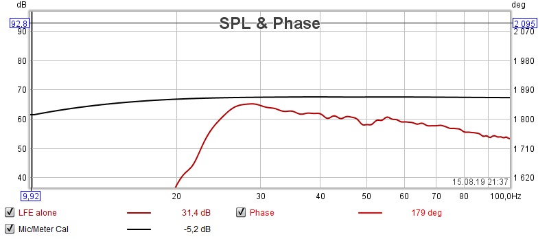

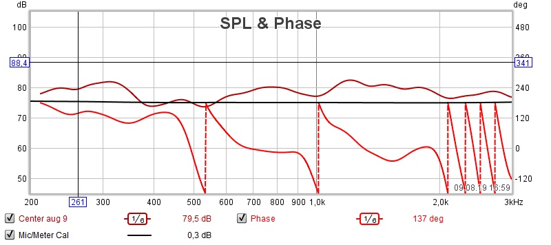

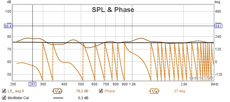

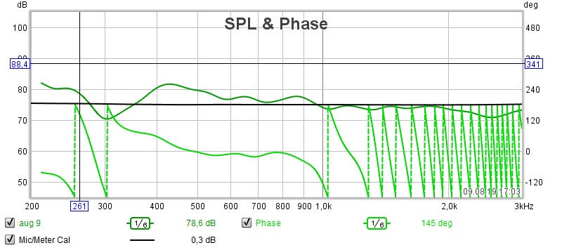

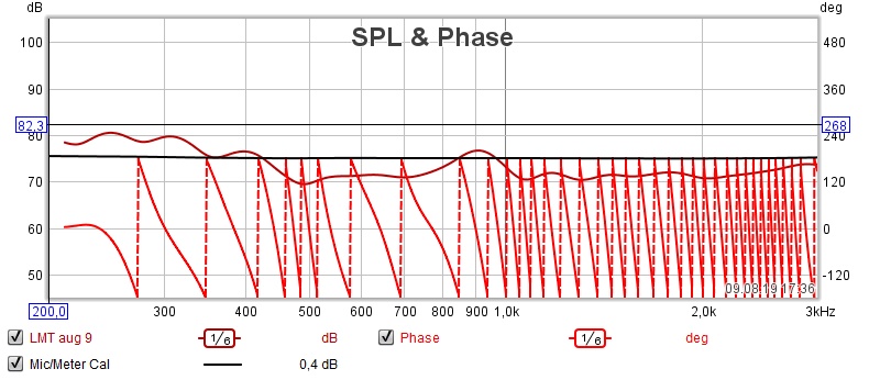

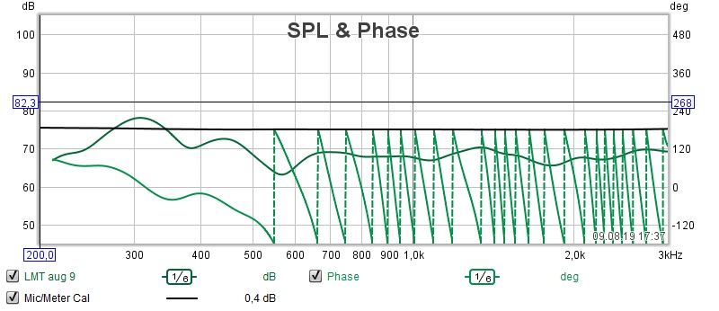

    Surrounds målinger i REW.
    Gikk opp fra 2kHz til 3kHz i range, da surrounds deler på 2.5kHz.
    1/6 glatting.
    SPL vist med fase.
    Overlay-plots på oppfordring.

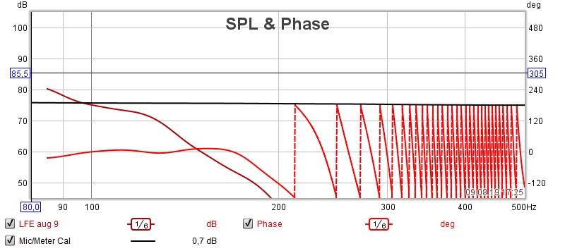

    LFE:
    Vis vedlegget 549782
    Senter:
    Vis vedlegget 549783
    Left Surround:
    Vis vedlegget 549785
    Right Surround:
    Vis vedlegget 549786
    Left Surround Back:
    Vis vedlegget 549789
    Right Surround Back:
    Vis vedlegget 549787
    Left Middle Top:
    Vis vedlegget 549788
    Right Middle Top:
    Vis vedlegget 549791

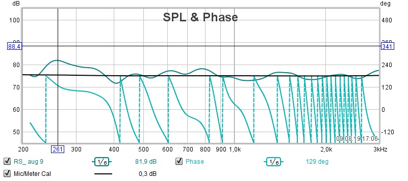

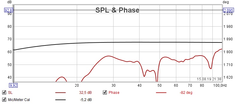

    Hvis du sikter til min oppfordring tror jeg det hersker en missforståelse. Jeg ønsket meg uglattet måling av avrulling. Det du måler her virker å være tipset om nivåjustering.
    Distinctive
    04.12.2006
    11.063
    3.599
    Mottatt. Glatting var etter Coolio sitt tips (for lesbarhet/oversikten og akse-oppløsningen sin del).
    Hvis ikke <All SPL> eller <SPL & Phase> flapp skal brukes - hvilken skal da velges?
    Eller er det en slik graf du ser for deg (i det ønskede frekvensområdet)?
    Skal se på dette.
    Ja, det er mulig jeg ikke har fått den totale ‘grasp of it’
    Så lenge bassen bare ‘dobler seg’ for mains med det nivået som bestemmes (fra 0 til -20dB) uten at nivået synker tilsvarende for LFE kanalen når dette gjøres, så er dette en ikke-sak og ingen nivåkompensering gjøres i Dirac.

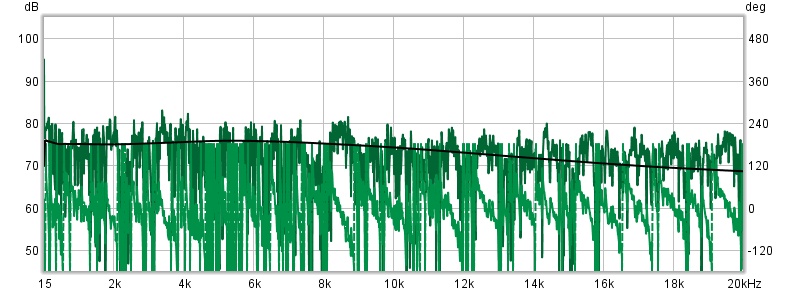

    1.Mottatt. Glatting var etter Coolio sitt tips (for lesbarhet/oversikten og akse-oppløsningen sin del).
    2. Hvis ikke <All SPL> eller <SPL & Phase> flapp skal brukes - hvilken skal da velges?
    Vis vedlegget 549889
    3. Eller er det en slik graf du ser for deg (i det ønskede frekvensområdet)?
    Vis vedlegget 549890
    1. Skjønner
    2. Det er ikke noe galt med visningene, bare innstillingene som kommer an på hva du vil vise eller se etter.
    3. Ja, men pass på at fasevisningen ikke kommer i veien for frekvensresponsen. Du kan dra visningen fase og spl fra hverandre. Ønsket frekvensområdet (fra meg) i visningen er 10-100hz for å se avrulling. Både satellitter og LFE sub.
    Bx
    04.08.2005
    9.443
    4.889

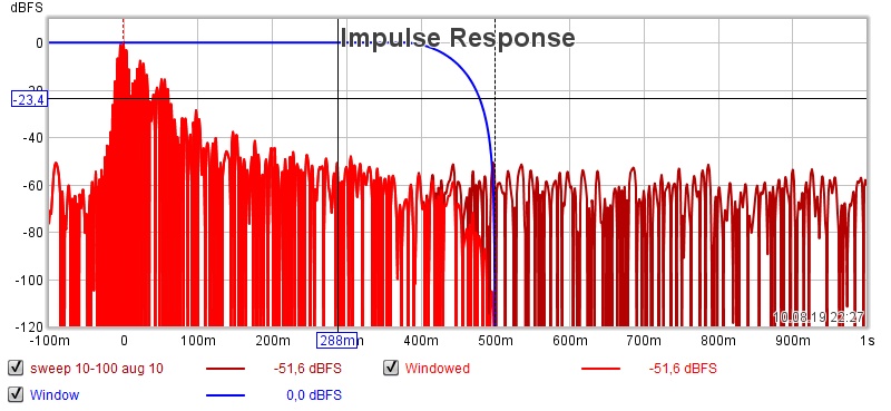

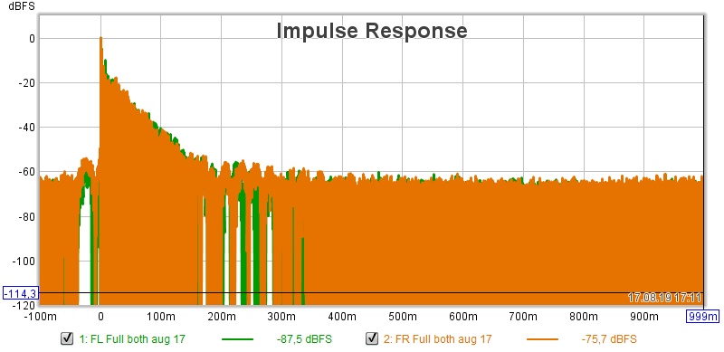

    Slike fasevisninger sier forøvrig lite om lydkvaliteten. Mye bedre å se på impulsresponsen.

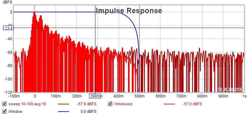

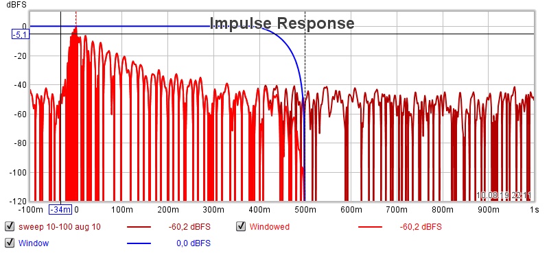

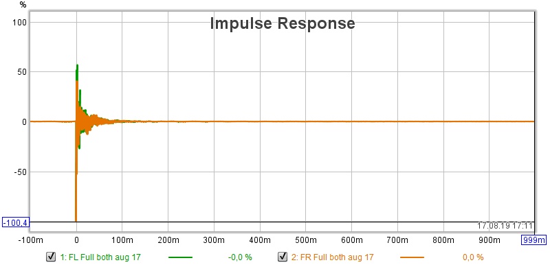

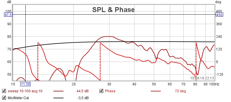

    Ser dette bedre ut?
    Frequency Response for Center Speaker:
    Impulse Response (dBFS) for Center Speaker:
    Frequency Response for LFE Speaker:
    Impulse Response (dBFS) for LFE Speaker:
    Frequency Response for Left Middle Top Speaker:
    Impulse Response (dBFS) for Left Middle Top Speaker:
    Frequency Response for Right Middle Top Speaker:
    Impulse Response (dBFS) for Right Middle Top Speaker:
    Frequency Response for Surround Right Speaker:
    Impulse Response (dBFS) for Surround Left Speaker:
    Frequency Response for Surround Left Back Speaker:
    Impulse Response (dBFS) for Surround Left Back Speaker:
    Impulse Response (dBFS) for Surround Right Speaker:
    Frequency Response for Surround Right Back Speaker:
    Impulse Response (dBFS) for Surround Right Back Speaker:

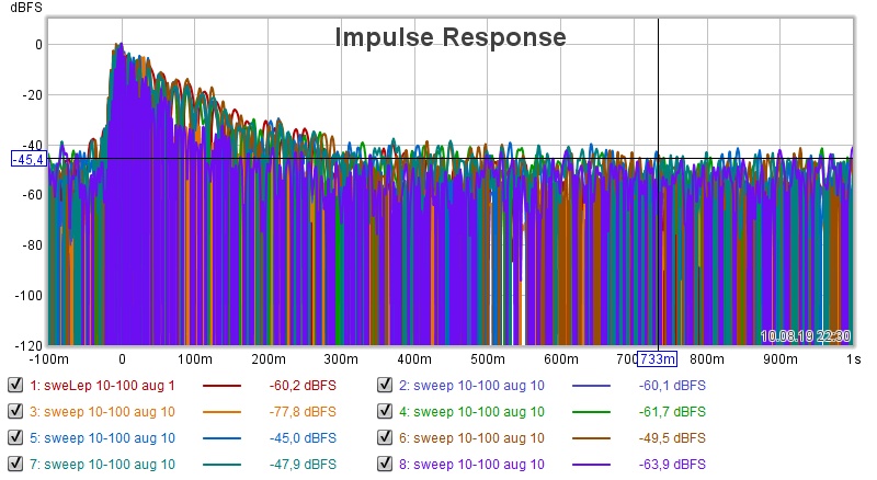

    Frequency Response Overlay:
    Impulse Response (dBFS) Overlay:

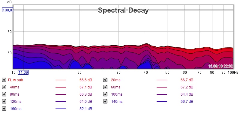

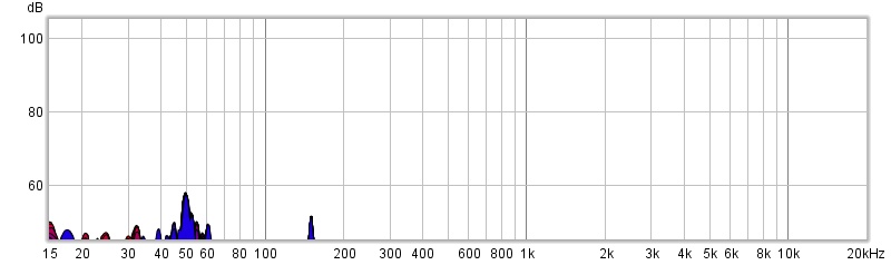

    Logaritmiske ir visninger viser 1-2 ting. Det første er utklingingen i rommet, det andre gjelder kun dsp og viser lydtrykket på artifakter før hovedpulsen. Jeg tror mye av det vi ser før hovedpulsen her er støy i målingen og liten grunn til bekymring.
    Distinctive
    04.12.2006
    11.063
    3.599

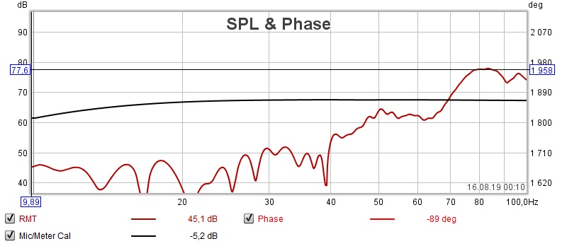

    Jeg klarer ikke å se at det skal være noe fornuftig under 20Hz, så dette stemmer sikkert.
    Alt under 40dB er vel støygulvet. Jeg plottet dette i post #63, men det var visst korrupt, så her er plots på nytt. Som du ser så peaker noisefloor rundt 50Hz, men dette er vel ingen overraskelse. Det er ingen spike ved 100Hz:

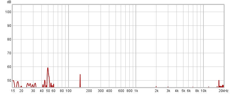

    7.1.0.2:
    50Hz støykilde kommer nok for det meste fra en portabel aircondition som jeg glemte å plugge fra.

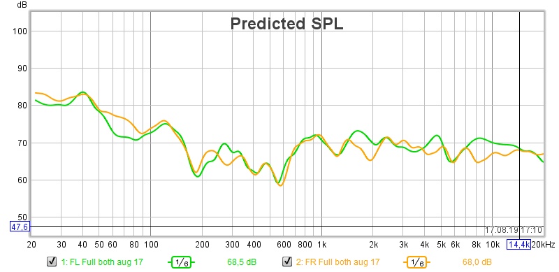

    Dette ser veldig bra ut synes jeg.
    Utifra plottene her ville jeg i utgangspunktet forsøkt deling på 70hz på:
    Center, Left og Right middletop speaker.
    På Surround right and left back speaker så ville jeg ha forsøkt både: «and sub» og «with sub» med med LFE på null.
    Det eneste jeg ikke liker er surround Right speaker som er høyre front ikke sant? Den har litt akustikkutfordringer mellom 60-85 Hz med delvis utfasinger.
    Prøv enten:
    - å justere delefiltre mellom høyre sub og høyre front.
    - flytte høyre sub så den får mer nivå i området.
    - sett «and sub» med lavpass filter 80hz og la LFE suben hjelpe til i området.
    - sjekke små endringer i mikrofonplassering om det lave nivået i frekvensområdet er lokalt eller konstant over et område på 50cm radius.
    - på «overlay» plottet kommer ikke svakheten like tydelig frem så hvis det også er uglattet kan det tyde på at det er veldig lokalt.
    LFE-suben din måler nydelig så den kan bør være til god hjelp for evt å hjelpe til.

    Jeg mener at jeg valgte bort Dirac-korreksjon og satte alle speakers til Large i forkant, men nå ble jeg litt usikker og må dobbelsjekke, hvis jeg finner ut av dette (mangler en snip av menyen).

    Finner ikke ut av dette, da jeg ikke får åpnet log fil i prosessor, så jeg får kjøre seriene på nytt med Dirac bortkoblet og med alle speakers satt til Large for å fjerne delefilter i prosessor.
    Jeg har dog funnet ut at den ene profil-settingen (Kino) ikke innehar Dirac (Baseline):
    Samt at Atmos ht nivåbalanse skal foregå i området 5kHz. Kanskje sinus fra generator bør brukes her:

    Her er nye målinger uten Dirac-korreksjon, men individuelt nivå matchet med full-frekvent pink noise først.
    Output er litt lavere enn 75dBc for måleområdet 10-100Hz.
    Alle speakers er (foreløpig) satt til Large uten begrensninger eller aktive filtre:
    Her er måleserien.
    Jeg har foretatt noen settinger lokalt på stereosubbene, så jeg skal kontrollsjekke i morgen:
    LFE kanal:
    Front Left med stereo sub:
    Front Left uten stereo sub:

    Center:
    Surround Left:
    Surround Right:
    Surround Left Back:
    Surround Right Back:
    Left Middle Top:
    Right Middle Top:

    Impulse All:

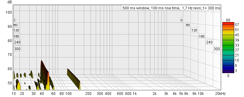

    FL w sub WF:
    FL w sub Decay:
    FL w sub Distortion:
    TrompeteN: Det blir spennende å se hvor store endringer dette medfører!
    TrompeteN
    27.07.2013
    2.518
    5.271
    Ser bra ut. Er dette uglattet?
    Distinctive
    04.12.2006
    11.063
    3.599
    Ja. Jeg prøvde å sette 'Remove smoothing' for å være sikker, men ingenting skjedde.
    Ingenting aktivt gjort mhp. glatting og legenden i footer skal vise dette.
    Merk at siste redigering av post #143 var gjort 01:59.

    Ok. Kan du vise surroundkanalene i fullrange visning? 20hz til 20Khz.
    Surround Left og Right og surround left og right back?
    Distinctive
    04.12.2006
    11.063
    3.599
    Her kommer de fullfrekvente målingene, ukorrigert og uglattet (Large):
    Surround Left:
    Surround Right:
    Surround Left Back:

    Flott! Da holder jeg på anbefalingen om å prøve deling i utgangspunktet på 70 for surround left og Right og 40 på back left og right. Ser ut til å være et veldig godt utgangspunkt dette. :)
    Distinctive
    04.12.2006
    11.063
    3.599
    Takk.
    Merk ellers at SL, SR, SLB og SRB alle er samme type speaker (Sonus Faber Elipsa Auditor).
    De bare plasseres forskjellig og dermed gir forskjellig respons for valgte mic pos. (sweet spot).
    Nedre oppgitte frekvens fra spec sheet er 55Hz.

    -Ville satt alle delingene på 24 db.
    Done.
    -Left og right surround på 70hz og endre til Large with sub.
    Done.
    -Ville begynt med å sette LFE med lowpass på 70hz.
    Done.
    -Får du route bassen til centerkanal til høyre og venstre front tror jeg det vil være bedre enn å route til LFE. Får du velge det ved å sette Center til LARGE?
    Etter det jeg kan lese meg til så er forståelsen min at når Center settes til Large with sub, så vil den lavfrekvente andelen (<70Hz) sent til den virtuelle subkanalen overtas av de ht som settes til ‘With sub’ så lenge denne ikke står til None. Har satt overtakelsen på 0dB.
    Slik ser det ut nå:

    Hvilke valg får du når du ikke velger «none» i routingen av sub?
    Det ser du under. Det er likt for LFE og går ned til 0dB i 1dB step:
    Jeg skal sjekke at frontene spiller med senteren under 70Hz (tar over med 24dB/Oktav) i dag når jeg legger inn et signal på senterkanalen.
    Ellers så jeg at man kunne importere en kurve fra REW. Dette må jeg sjekke nærmere.
    2.Det ser du under. Det er likt for LFE og går ned til 0dB i 1dB step:
    Vis vedlegget 550591
    Vis vedlegget 550592

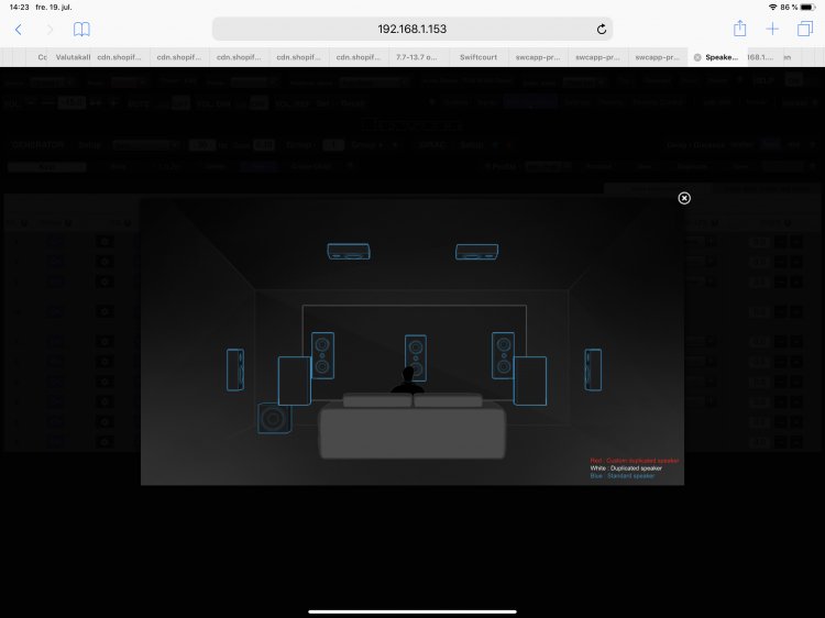

    Har nå brukt hele dagen på å finne ut av problematikken over.
    Hovedproblemet har vært at når intern SP4 signalgenerator brukes, så er det tilsynelatende kun den kanalen som er aktivert som er aktiv. Hvis man fordeler lavfrekvente signaler mellom kanaler så må man inn med et eksternt signal for å sjekke virkemåten. Dette var veldig forvirrende. I tillegg så må man noen ganger ut av editeringsmodus for å registrere en endring, selv om endring ble savet.
    Her er oppsettet nå.
    Center-bass er flyttet over på frontene istedenfor LFE. For de andre kanalene så rutes bass under cut-off til LFE.
    Jeg har også avlastet LFE litt med stereo-subbene (-20dB) men her må jeg prøve meg litt frem:
    Det har også blitt mer komplisert å finne nivåer rundt XO for enkle kanaler når såpass mange spiller i sammen og man bare genererer signaler for single kanaler.

    Noen målinger etter at siste justering var foretatt (fortrinnsvis volum):
    Glattet SPL for begge hovedkanaler:
    Impulse Response for begge hovedkanaler dBFS:
    Impulse Response for begge hovedkanaler %:
    Overlay for begge hovedkanaler:
    Impulse Response for low range:
    Decay for low range FL:
    Waterfall for FR low range:
    Waterfall for FL low range:
    Decay for FR low range:
    Glattet SPL, low range, for mains sammen med LFE:
