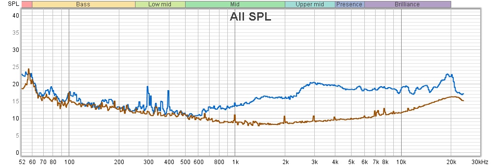

    RÞd er forsterkerens stÞy mÄlt pÄ en cm avstand. GrÞnn er avslÄtt forsterker. AltsÄ rommets stÞygulv.
    Diskantens fĂžlsomhet rundt 3kHz er 104 db/w
    Vis vedlegget 696130

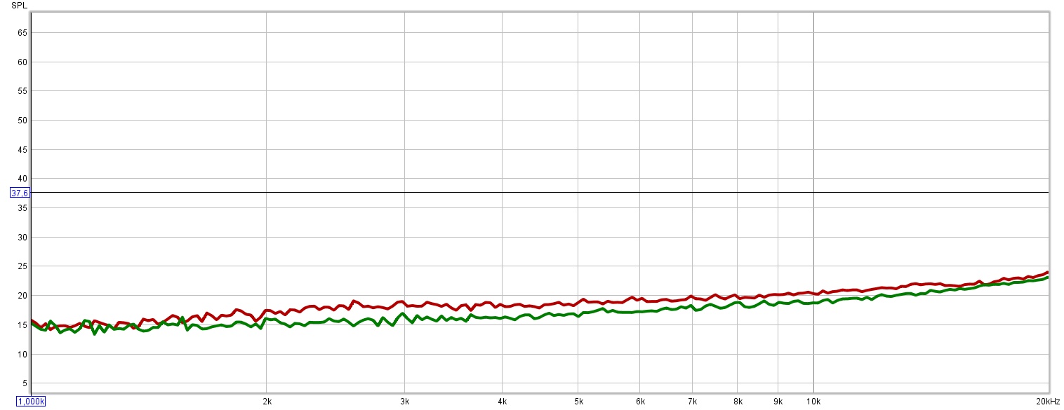

    Crown Cdi 4/1200 for sammenligning. Tilsvarende-ish sensitivitet pÄ diskanten fra 1 cm. Absolutt nivÄ ikke kalibrert.

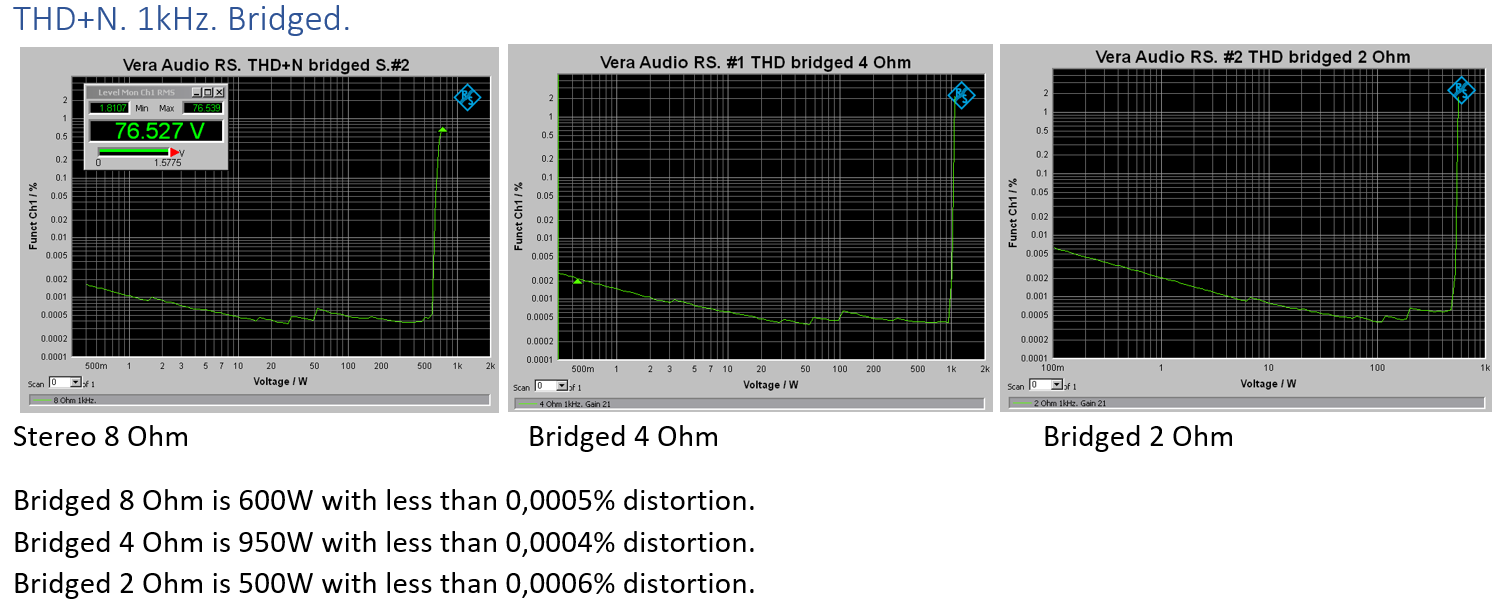

    Jeg blir forvirret nÄr jeg leser om P150/600 RS, stemmer det ikke at den benytter Purifi 1ET400A moduler og at den kan brokobles?
    nÄr jeg leser tech spec fra Purifi pÄ denne modulen stÄr det fÞlgende under 4.3.2 Speaker Output (OUT+, OUT-)
    bridging two 1ET400A Designs will result in performance degradation as the circuit is not configured to sense the voltage differential that exists between the (now unused) OUT- terminals of the two 1ET400A Designs. Bridging is therefore not recommended. All operation and performance specs are void in this configuration.
    Hva er det jeg har misforstÄtt her? :unsure:
    lydogakustikk
    BransjeaktĂžr
    14.06.2014
    1.758
    3.541
    Det er riktig at den bruker Purifi 1ET400A moduler og at den kan brokobles.
    Den utfordringen som nevnes av Purifi er noe som er lÞst. Legg merke til at Purifi skriver at dette beror pÄ det i uthevet tekst:
    "bridging two 1ET400A Designs will result in performance degradation as the circuit is not configured to sense the voltage differential that exists between the (now unused) OUT- terminals of the two 1ET400A Designs.
    Her er hva Armand har skrevet i en annen trÄd.
    The circuit in our Vera P150/600 is made so that it does in fact "sense the voltage differential that exists between the (now unused) OUT- terminals of the two 1ET400A Designs". That is why we can offer the bridging capability. We have of course tested this configuration and also demonstrated the performance as shown in post #32.
    550W into 8 Ohms with less than 0.0005% THD+N.
    This is measured with Rohde & Schwarz UPV audio analyser and we are at the limits of what this instrument is capable of. Probably the numbers are even a tad better, but there is only one instrument that can verify this today and that is AP 555x
    SÄ her det mulig Ä oppnÄ forvrengningsfri lyd med betydelig med watt.
