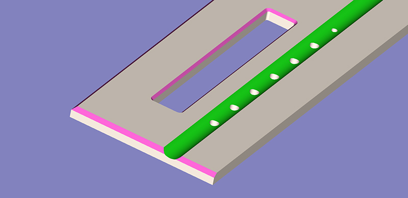

    Kabinetter fra Modu: I produksjon nå. Fikk en mail fra de :
    Hello Johnny!
    Our engineer is importing your drawings and preparing the program to customize your panels.
    He found out that even doing a 5mm radius in the first front panel would be not a good solution. He suggested to go with a 3,5x3,5mm bevel.
    I have attached some images to give you an idea of how the final product will look like.
    Let me know what you think!
    Så da blir det slik:
    Det blir egentlig bedre enn en 5 graders "avrundning". Blir mer Pass style, som jeg var ute etter :).
    Hello Johnny!
    Vis vedlegget 407481
