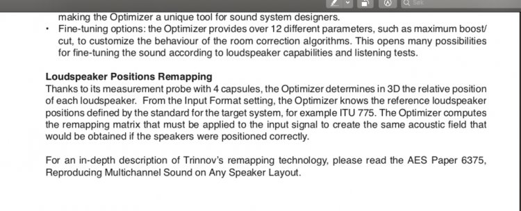

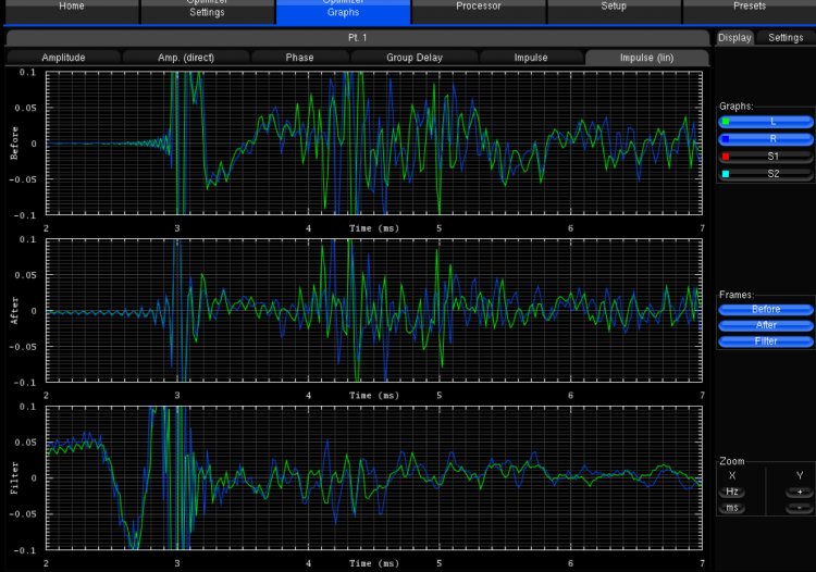

    Jeg kopierte dette ut av ADATEQ 8 sin manual siden jeg hadde den oppe her og tenkte kanskje det var interessant å lese
    mtp hva Trinnov gjør med reflektert lyd, og hvordan den håndteres.
    Dette Gjelder selfølgelig alle trinnovs modeller som bruker mic.
    Quantity of Early Reflection & Resolution of Energy Response:
    The TEQ uses two different approaches for the Optimization of Loudspeaker/Room Acoustics:
    1) A time-based approach for the correction of
    Early Reflections (ER). The main parameter that defines the behaviour of this algorithm is the width of the time-frequency window “Quan- tity of Early Reflections”.
    2) An energetic approach for the correction of Late Reverberation (LR), whose main param- eter, Resolution of Energy Response is the smoothing applied to the energy response.
    • Quantity of Early Reflections (default is 3 cycles)A simple parameter that characterizes the quan- tity of early reflections that the Optimizer tries to compensate is the width of the time-frequency window. The size of this window is defined by a number of cycles, hence the naming “α/f”, where α (alpha) is the number of cycles and f the fre- quency (1/f being one cycle). The meaning of the time-frequency window is as follows: for each frequency a different duration (or width of the time window) is taken into account. At low frequencies the window typically starts at 150ms for 20Hz, and decreases constantly to be as low as 0.3ms at 10kHz.A simple parameter that characterizes the quan- tity of early reflections that the Optimizer tries to compensate is the width of the time-frequency window. The size of this window is defined by a number of cycles, hence the naming “α/f”, where α (alpha) is the number of cycles and f the fre- quency (1/f being one cycle). The meaning of the time-frequency window is as follows: for each frequency a different duration (or width of the time window) is taken into account. At low frequencies the window typically starts at 150ms for 20Hz, and decreases constantly to be as low as 0.3ms at 10kHz.

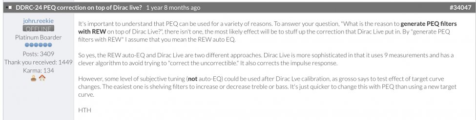

    Den PEQ processen - er det EQ for flere frekvensbånd du legger inn manuelt basert på høyttalerkarakteristikk eller er det basert på målinger fra REW i rommet for deretter automatisk å implementere filtre i Trinnov etter import?
    TGB
    10.08.2013
    3.482
    2.413
    Asker
    PEQ gjøres basert på REW; det legges inn i forkant av optimizer. Finnes ingen automatikk i import - det finnes også verktøy for å liste opp alle PEQ filter man skal legge inn, men min erfaring er at det blir best ved å gjøre dette på den manuelle måten. PEQ er filter man legger inn ved hjelp av frekvens; gain +/- og Q (så har man forskjellige filtertyper). Så den er ekstremt nøyaktig. Naturligvis må man ikke overdrive i positiv gain. PEQ legges på før optimizer/kalibrering.

    OK.
    Etter å ha lest meg opp litt på andre gen. Dirac Live så forstår jeg at PEQ ligger innebygget i DL.
    Det som Trinnov gjør unikt (målemessig) er 3D mikrofon som også inkluderer ‘space’ (i tillegg til speakermappingen i Optimizer, selvsagt).
    Det er mange på HFS som snakker varmt om DSP og forstår ikke min skepsis, men det virker ikke som folk kjenner til multikanal-versjonen av Dirac Live, så her er jeg tydeligvis på litt upløyd mark og må tilsynelatende lande dette selv.....
    https://www.whatsbestforum.com/threads/dirac-live-second-generation.24465/
