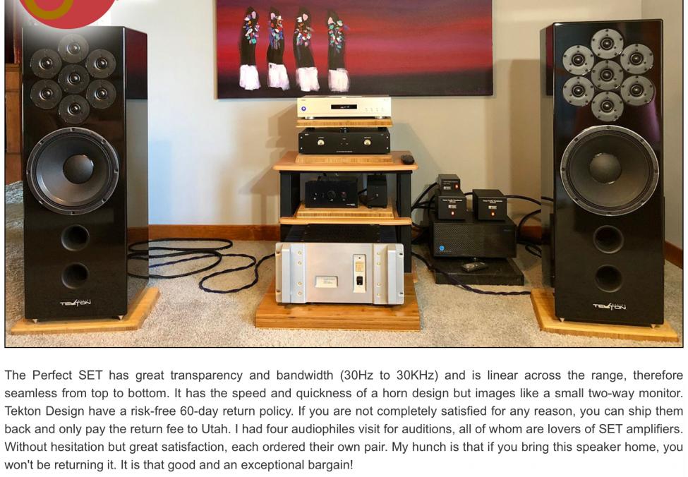

    Jeg har i det siste lest en del om Tekton Design sine Double Impact høyttalere og er mildest talt fascinert/nysgjerring. Det later til at nærmest alle som har hørt de er fra seg av begeistring (merker meg også at det er en del som er kritisk, men som ikke har hørt de).
    Er det noen her som har noen kjennskap til merket og kanskje til og med har hørt noen av modellene (de er det mange av, modeller altså)?
    TektonDesign LLC - Home
    Jason Victor Serinus hos Stereophile sier blant annet:
    " ... the Parasound–Tekton pairing sounds stupidly good. And not just for the price. It sounds STUPIDLY GOOD, period.
    Yes, I'm resorting to capitals, because I want you to take notice."
    https://www.stereophile.com/content...itles-day-three-continues#aUk6iR126hmeKBKk.99
    Terry London hos Hometheater review sier blant annet:
    Because the Double Impact speaker has such an unfair advantage compared with any speaker that I know about in its price range, I decided to jump up to speakers that cost thousands of dollars more to compare their performance. The Acoustic Zen Crescendo Mk2, which retails for $22,000/pair, has been one of my favorite high-end speakers over the last five years. It is great at rendering very natural timbres and tonality, along with excellent soundstaging. Its bass performance is extended but comes nowhere close to the Double Impact's more accurate and tighter bass response. Where the Double Impact really pulls ahead is its overall transient speed and sense of "aliveness" that I don't experience with the Acoustic Zen speaker.
    The next speaker that I have enough experience with to compare with the Double Impact is the YG Acoustics Carmel 2, which retails for $24,300/pair. In virtually every important parameter--soundstaging, bass extension, overall dynamics, and clarity--the much more expensive YG Acoustics Carmel 2 was significantly eclipsed by the Double Impact's performance.
    For more than five years now, I have owned the Lawrence Audio Cello speakers, retail cost $18,000. They have been my reference speakers in my big system. I still love them, and they are great speakers; however, I go where my ears take me. Because of my experience with the Double Impact speakers, I have ordered a pair in a special finish and some internal upgrades that Alexander insists will take this speaker to an even higher level of performance. Yes, the basic Double Impact speakers outperformed my Cellos in ways I already explained in this review.
    https://hometheaterreview.com/tekton-design-double-impact-floorstanding-speaker-reviewed/
    Clement Perry hos Stereotimes:
    Make no mistake, the Tekton Design DIs are among the best loudspeakers I have heard in my home, regardless of price. To say that I have become enamored of them would be only half the truth. I am also enamored of Eric's conscious decision to make products centered on music lovers who happen to not be millionaires. In my opinion he could have easily priced the DIs ten times higher.
    Tekton Designs Double Impact Loudspeakers
    Mike Right hos Stereotimes
    All of my friends would ask me if I would get rid of my Wilson Sashas for a pair of DIs and I would tell them “no.” Why should I, or anyone else who has a pair of speakers you like or are proud to own and enjoy listening to. At the same time, if the question was if I were shopping for speakers, which would I choose between the Sashas and DIs, I can wholeheartedly recommend getting the DIs and buying a car, or whatever your pleasure, with the money you’d save.

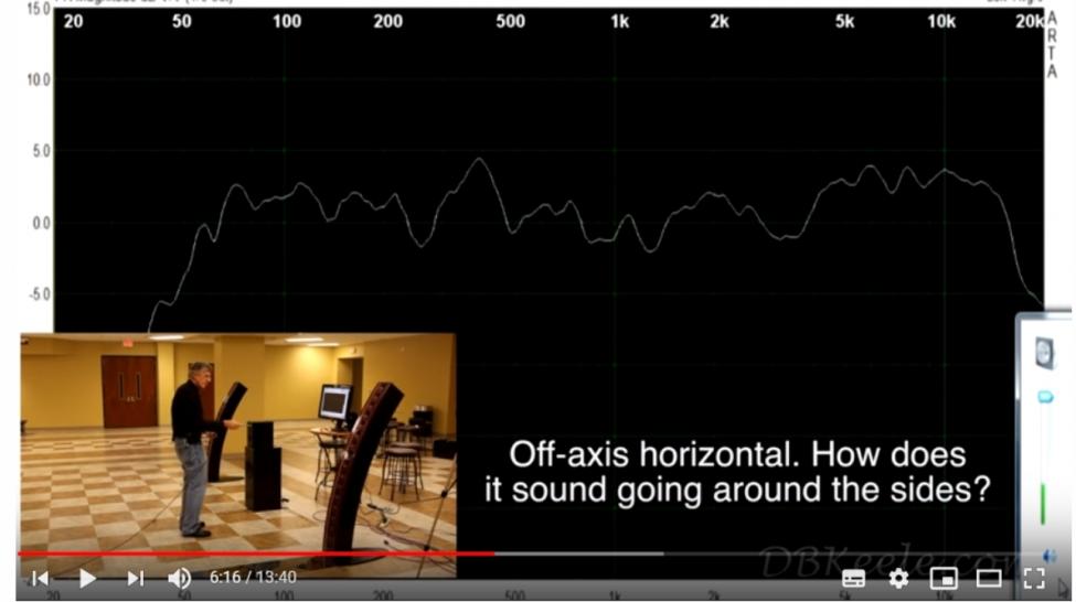

    fyren bak tekton er helt idiot. påstår blandt annet at vekten på membranet i en høyttaler burde vær lettere enn selve gitarstrengen i en bassgitar for å låte naturlig(!) noe av det dummeste jeg har hørt.
    Tekton OB Sigma Design--What?
    alt han selger er helt på jordet akustisk, bare random merkelig løsninger. f.eks den bizarre diskantløsning i nevnte høyttaler. tror det blir bedre spredning når alle vet det motsatte skjer.

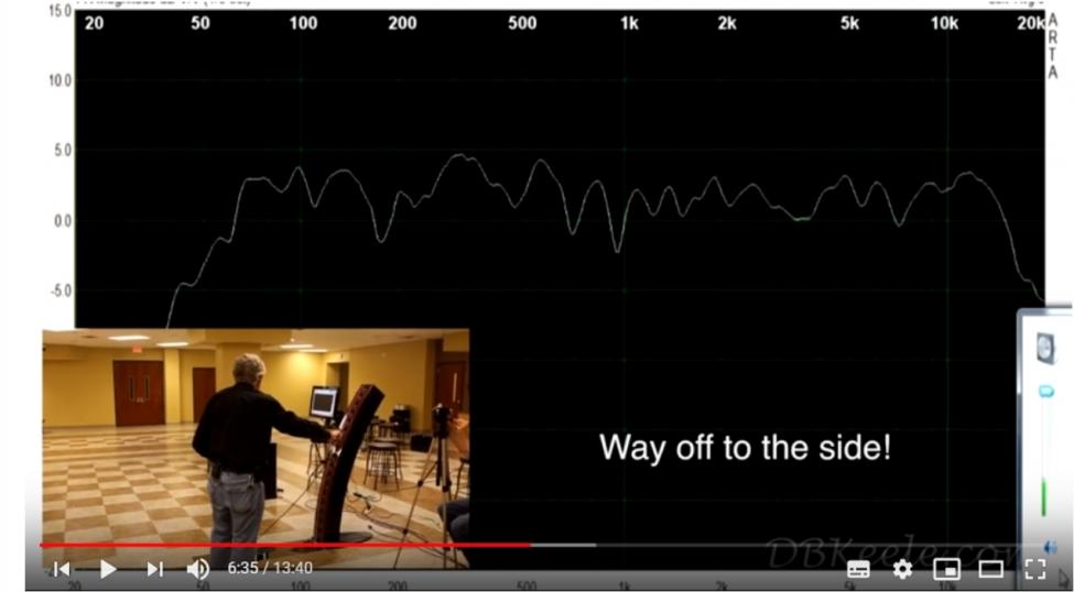

    Hadde vært greit å se noen polar plot. Da blir det jo åpenbart om dette arrayet har noe for seg. Alle seriøse produsenter burde ha slik informasjon lett tilgjengelig.

    Det er ikke sikkert den diskantløsningen er så dum om det er kontrollert spredning man er ute etter. Jeg vet ingenting om disse høyttalerne, men tipper de 6 diskantene som står i ytterkant bare jobber opp til en viss frekvens, for så å la den som står i senter jobbe alene opp i de høyeste frekvensene. Det ser ut til at det er SB Acoustics diskanter som står i dem, og mange av de modellene tåler veldig lav delefrekvens, noe som må være nødvendig ved den relativt store c - c avstanden mellom mellomtonene.
    Så selv om det ser litt snodig ut så er det ikke sikkert at det er så dumt. Det hadde vært veldig artig å hørt dem ihvertfall.

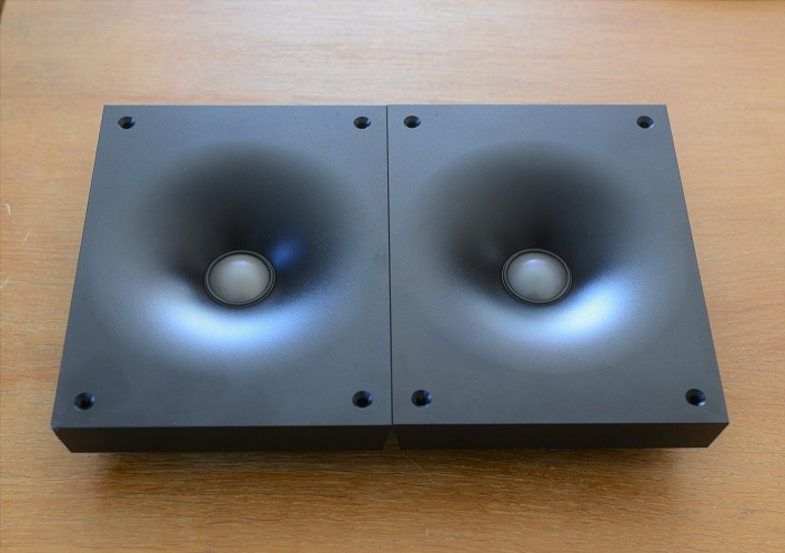

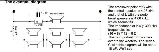

    Umiddelbar tanke er at dette kan være en variant av B&O's filler- driver, men dempet over et bredt frekvensområde (?). Ka du tru ?

    Denne patentsøknaden, patentet eller hva der er, er jo pur nonsens. Prøv å forklar meg hva forfatter mener, eller vis meg en måling som beviser de utrolige påstandene hans rundt masse, så kan vi snakkes. Linken fra diyaudio er iallefall mer oppklarende enn den subjektive "anmeldelsen" hvor eneste spesifikasjoner som er nevnt er pris og følsomhet. Jeg hadde satt pris på om noen prøvde å forklare hva designeren har prøvd på, backet opp med målinger om han har klart det.
    Edit: Det virker som han har klart å oppnå lyd som kundene hans liker, men forklaringene henger ikke på greip. Men det viktigste er jo at det låter bra.

    Det er nok forskjellig fra Polk. Hvis du vil ha Polk-effekt idag kobler du opp en ekstra effektforsterker med volumkontroll til preampen
    + et sett ekstra høyttalere. Disse stilles opp på motsatt side (venstre høyttaler til høyre kanal) og i motfase. Volumet på ekstra-settet stilles ned.
    Tekton hevder noe i den retning at et ekstra diskantsett spiller et bredt frekvensområde 10db under de andre elementene for å bevare overtonestruktur bedre enn hva tyngre elementer kan oppnå. Kun 1 diskant er den egentlige diskanten.

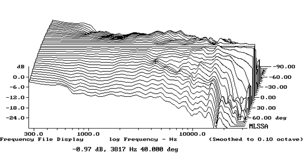

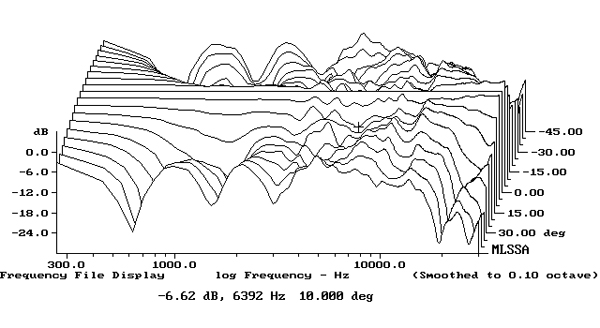

    Da har Stereophile testet Double Impact Monitor - https://www.stereophile.com/content/tekton-design-impact-monitor-loudspeaker
    og gjort målinger
    When I first saw the Impact Monitor's array of seven 1" dome tweeters, I wondered how it could possibly work. But its measured performance shows that this unusual design is not compromised—I keep coming back to that superbly even on-axis response—and that the array works well to control the speaker's treble dispersion.—John Atkinson

    Ikke verre enn at et kobbel diskanter i et slags coax array opptrer som mellomtoner fra 1 khz og opptil til en singel diskant. En vri på å redusere massen på mellomtonen.

    Det ser ut som arrayet fungerer etter hensikten for å kontrollere spredning, samt senke delefrekvens mot bassene. Dette pratet om masse ift f.eks vekten av en fiolinstreng anser jeg fortsatt som nonsens til det kommer noen håndfaste data. Prisverdig at de prøver å lage vellydende bokser til edruelig pris!

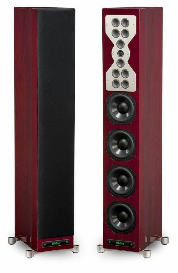

    Mener å huske at WEGG3 sine Surface Mission-modeller hadde noe av det samme? Morel bassmellomtoner og Dynaudio diskanter.
    "...the tweeter configuration used in the Surface Mission One may just be the cleverest design since Edgar Villchur`s invention of the dome tweeter in the late 1950`s. Eggleston and Prathers tweeter arrangement retains the advantages of point and line sources while eliminating the weaknesses inherent in both. The output of the tweeter in the middle of the arc is 6.7db higher than that of the two tweeters flanking it, and those two are 6db hotter than the remaining four tweeters in the array. The effect from the listening position was similar to a line source: all the high-frequency information seemed to come from a single point. Because the treble imformation is spread among seven tweeters, none of them have to work very hard. Even the principal tweeter is configured to produce 9.11 db lower output than if it were the sole source of high frequencies."

    Det finnes vel ikke en eneste "perfekt" høyttaler på markedet. Når noe låter bra til en god pris er det bare å applaudere. Tekton har (som mange andre) antagelig formulert / mystifisert den tekniske beskrivelsen på en slik slik måte at copy-cats skal holde seg på nogenlunde avstand. Det er en kunst å gjøre det enkle vanskelig (og omvendt).

    En liten kommentar til konstruksjoner med en diskant omgitt av flere. Det er sikkert en del som kjenner til CBT-prinsippet? Se for dere at man har en halvkule, og monterer diskantene i denne slik at den i midten står lenger frem enn de rundt. Dette gir jo en velkjent spredningskontrollerende effekt. Om man deler passivt slik at diskanten i midten går hele veien ned til for eksempel 1k, men diskantene rundt begynner å bremse ved 3-4kHz betyr det at man må ha en spole i serie med disse. En slik spole vil representere en ganske konstant forsinkelse, som da altså bare rammer diskantene rundt. Denne forsinkelsen er rimelig konstant, og er sammenliknbar med en løpetidsforsinkelse. Dette gir en virtuell kule da forsinkelsen ikke rammer diskanten i midten.

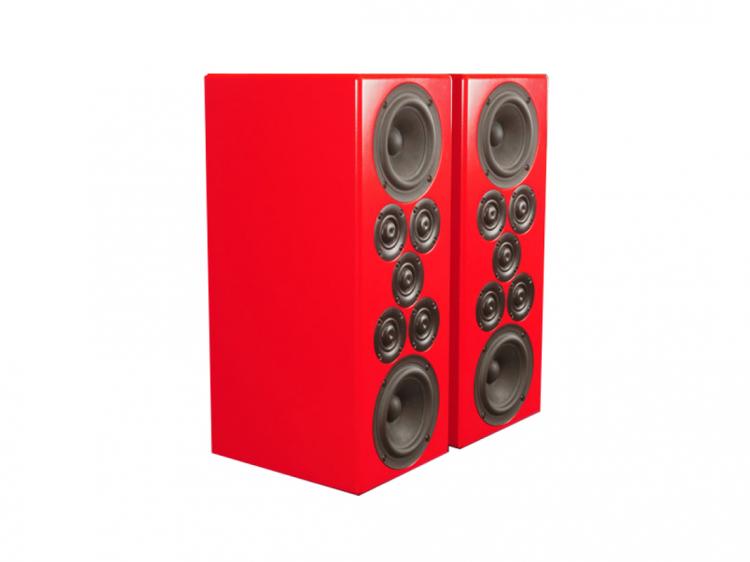

    Nok en spennende modell fra Tekton Design - Encore
    Clement Perry i Stereo Times skriver blant annet følgende (generelt om Tekton)
    I reviewed the Double Impact speaker (reviewed here). With its $3,000 asking price, it catapulted Alexander into iconic status. Not since Albert Von Schweikert introduced his VR-4 in 1993 has a loudspeaker been so well received by so many music lovers with so little monetary outlay. As of this review, Stereo Times writers Dave Abramson, Frank Alles, Mike Wright, Mike Girardi, Ron Cook, Greg Voth, Ed Van Winkle, Moreno Mitchell, as well as myself, use Tekton loudspeakers in their reference system.
    Og mer spesifikt om Encore
    As acclimated as I had become to the Double Impact SE's after nearly of year of listening, I was not prepared for the Encore's superior impact, dynamic expression and incredible lack of distortion. The ability of images to pop out of nowhere, instruments locked in a vast soundstage, accuracy of timbre and intimacy had me almost giddy with delight.
    https://www.tektondesign.com/encore.html
    Hele anmeldelsen kan leses her
    Tekton Design Encore Loudspeaker

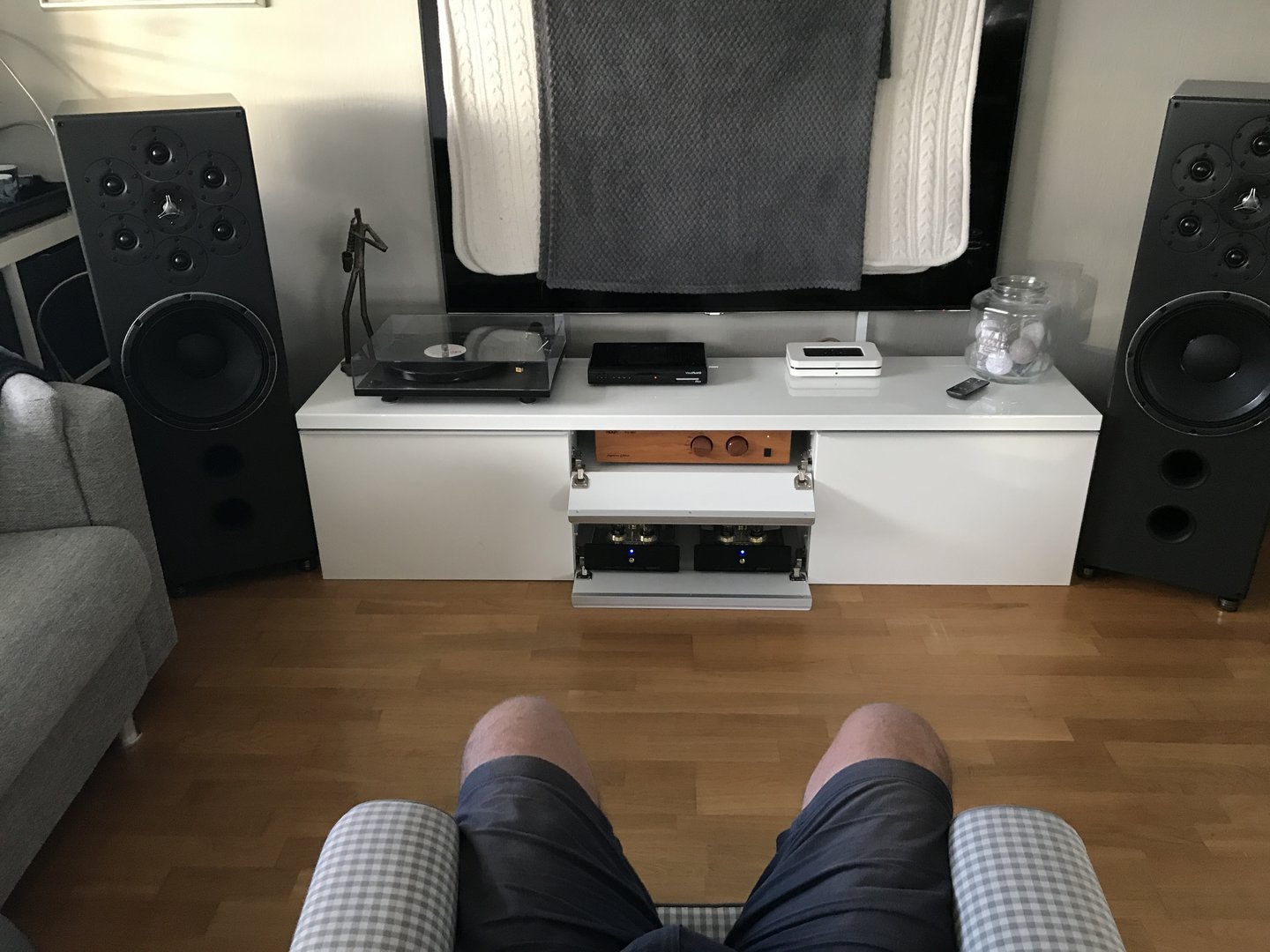

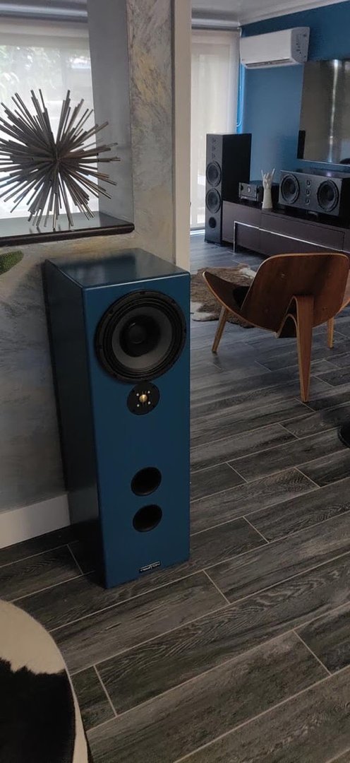

    Noen som eier høyttalere fra Tekton her?
    Jeg har et par små høyttalere av en utgått modell som jeg tror heter Model4.1. Bruker de på kontoret. Knallgode høyttalere. Har hatt et par M-Lore som jeg også likte godt.
