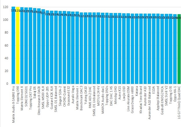

    Her er testen til ASR med alle målinger: https://www.audiosciencereview.com/...ds/topping-d90-balanced-usb-dac-review.10519/
    Vi snakker her om den absolutte verdensklasse uansett prisklasse.
    Conclusions
    The Topping D90 produces lowest noise and distortion than 220 DACs tested so far. It shows that AKM is ready for business to compete with ESS on top of the performance charts. It has excellent build quality and comes from a manufacturer that believes in verification of design with measurement. Its measured performance is nearly flawless. To get rid of last few niggles, would cost you a few hundred dollars more. You decide. :)
    I live for such discoveries where a company cares about giving us the maximum performance they possibly can. And at a cost point that is thousands of dollars if not tens of thousands of dollars than high-end DACs.
    -BB-

    Jeg ser ikke noe ved testen på ASR som tyder på at den har nevneverdige utfordringer med USB, men det kan godt hende at andre USB-kilder gir andre utslag.
    Den største flaskehalsen for å få ut potensialet i den dacen vil jeg forøvrig mene er utvalget av musikkhermetikk som utnytter det samme potensialet, foruten det husalteret den skal inn i.
