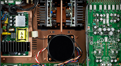

    Dere som nå har litt synspunkter rundt forsterkere og slikt noe...
    Marantz leverer en PM-10 forst.erker til ca 80K som ser ut til å være basert på 2 brukoblede NC500 OEM moduler.
    Også skriver de ting som dette:
    For the PM-10, Marantz wanted the purest possible sound, plus the power and dynamics to drive and control some of the world’s most demanding speakers...
    What is the bridged amplifier about? In a conventional amplifier, one speaker is driven by the positive and negative part of one single output stage per channel, but a bridged amplifier does things differently, using two separate amplifier stages per channel to drive one speaker. To greatly simplify things: one amp pushes the speaker cones and domes, while the other pulls them back.
    That much greater control over the way the speaker drive units behave, in that the amplifier can make them start moving, and stop, much more precisely is very important for definition and the ‘speed’ of the system,...
    Ref: https://www.marantz.co.uk/uk/produc...?catid=hifi&subcatid=amplifier&productid=pm10
    Også kan vi gå på Hypex sine sider og lese dette:
    11 Q: I need double the power in an 8Ohm load than a UcD amplifier can produce. Is there some way I can bridge two, for example, UcD400’s?
    A: You need to drive one of the modules 180 degrees out of phase by simply swapping the negative and positive input signal wires. Tie the loudspeaker between both positive loudspeaker outputs of the amplifiers and connect a 100n/200V capacitor across the loudspeaker terminals at the amplifiers’ side. This set-up is most applicable for 8 Ohm loads since each amplifier ‘sees’ 4 Ohms with an 8 Ohm load attached. A 4 Ohm load might trigger the current protection leaving you with not nearly as much power as you might have expected.
    Ref https://www.hypex.nl/faq/
    (jeg gjør en antagelse om at dette svaret også gjelder for NC500/NC500 modulene - her kan jeg selvsagt ta feil)
    Så Marantz lager en brokoblet forsterker med NC500 og skryter av at den passer til å "drive and control some of the world’s most demanding speakers".
    Mens man får inntrykk fra Hypex om at en slik løsning kun passer for HT'er med relativt jevn 8 Ohms load.
    Hva tenker folket - burde man brokoble NC500/NC400 amp'er og komme til Marantz forsterker-nirvana, eller er det egentlig lite poeng?

    Sitter og filosoferer her - to stykk Nc400-moduler á €325 + to trafoer á 750kr + kabinett+++ eller to stykk Hypex Fusion plateforsterker montert i kabinett? De større utgavene med tre kanaler og dsp i hver frister...
    Johan-Kr
    MusicBear
    Da denne Marantz forsterkeren kom tenkte jeg; er dette verdens første "perfekte" forsterker - alt som er beskrevet om den som grunnlag for mine egne refleksjoner. Men, så har jeg også lest en rekke tester av den - "steikje god" - men ikke magi for ørene på øverste hylle. Derimot er det mange opp gjennom som har ment dette om Devaliet's sobre produkter, folk som kommer fra både rør- og klasse A-amper i høy prisklasse.
    40.697
    44.582
    Jeg ser ikke helt poenget med å brokoble UcD’er eller NCore. Brokobling gir høyere spenningssving på bekostning av strømstyrke, veldig forenklet. Det kan gi bedre signal/støyforhold og kansellere enkelte forvrengningskomponenter, men det gjør definitivt ikke forsterkeren bedre i stand til å håndtere vanskelige laster.
    Bifrôst er balansert brokoblet, og det er en grunn til det, men det er også en grunn til at høyttalerne de skal brukes sammen med har 16-ohms mellomtoner og mellombasser. Det er også en grunn til at det er ikke-brokoblede nCore som driver de 8-ohms kardioidebassene med 101 dB følsomhet. Horses for courses, som britene sier.

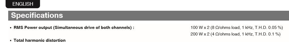

    Du vil få 1000 W i 8 ohm, om det er hva du behøver. Tommelfingerregelen for brokobling er dobbel effekt i dobbel impedanse. Det er ikke helt klart for meg hvorfor du skulle behøve å doble strømforsyningen også. En av fordelene med en balansert brokobling er mer effektiv utnyttelse av strømforsyningen.
    Hmm, det hørtes vel litt optimistisk ut... Da snakker du vel om peak output - som kanskje ikke er den vanligste måten å angi watt for en effektforsterker?
    En NC500 med en SMPS1200A700 gir 100W@4Ohm continious output etter hva jeg forstår, ref kap 2.4 i https://www.hypex.nl/img/upload/doc/ncore/nc500/Documentation/NC500_OEM_02xx.pdf
    Den er kapabel til å drive laster ned til 2 Ohm (ref features på side 1).
    Kan godt hende jeg misforstår, i så fall - forklar gjerne!
    Betyr det at man ved brokobling vil få ca. 200w@8ohm og en forsterker kapabel til å drive 4ohmat nedre impedans ikke bør være under 4ohm?

    Det er ganske mange feil betraktninger i dette. Men la meg først begynne med en kommentar til Asbjørns innlegg som du quotet:
    Om man lager en forsterker med 2 stk NC500 kan den for eksempel gi 2x700W i 4 ohm som maksimal effekt. Lager man en forsterker med 4 stk NC500 ville jeg samtidig doblet PSU fordi forsterkeren nå man levere 2x1400W i 8 ohm. Så det spørs jo sånn sett hva man sammenlikner med. Begge forsterkerne har fortsatt samme current limit, men man kan få ut dobbelt så stort spenningssving.
    Når det gjelder utnyttelse av PSU er det viktig å se på ulike betraktninger. En energibetraktning vil slå omtrent likt ut. Om du tenker på back EMF som en konsekvens av impedans så handler det plutselig mer om hvordan PSU er konstruert. Jeg tenker det er mer presist å si at en brokoblet forsterker stiller litt andre type krav til PSU.
    Den effekten som er oppgitt i Hypex sitt datablad er absolutt å anse som "kontinuerlig effekt". Når de oppgir 100W er det for å illustrere at de mener at 1/5 av effekten kan leveres kontinuerlig i en ubegrenset tidsperiode så så lenge man ikke forbedrer kjølingen. Det er vanlig å dimensjonere kjølingen til å klare ca 1/8 av maksimal effekt kontinuerlig, så 1/5 er ikke et svakt tall.
    Hvor lav impedans de kan drive er en direkte funksjon av den innebygde current limit-kretsen. Det skal gå fint å brokoble den og koble den til 1 ohms last. Utfordringen er selvsagt at det kreves mye strøm og lite spenning for å drive lave impedanser, mens en brokoblet forsterker har den fordelen at den kan levere høyere spenning, men strømkapasiteten er uendret.
    Ved brokobling av NC500, og riktig PSU, får du lett 1400W i 8 ohm. Har du god kjøling kan du trekke det kontinuerlig, men hvem behøver det? Du kan også fint drive en 2 ohms last, men du får ikke fullt utbytte av spenningen fordi current limiter slår inn først.
    Peak effekt er det man kan hente ut ved svært høy forvrengning. Alle tall jeg har gjengitt her er godt under 1% THD, og man skal ikke gå mye ned i effekt før tallene er under 0,005%. Betrakter man 10% THD vinner man fort et par hundre watt ekstra, og ærlig talt så betyr det en del at forsterkeren har en headroom på noen decibel uten at den kneler helt og nærmest går i shutdown.

    Så blir oppfølgingsspørsmålet - Marantz påstår i sin kreative beskrivelse at brokobling medfører push/pull kontroll med elementet, Det tenker jeg betyr bedre kontroll på elementene også når man ikke ligger på grensen av hva forsterkeren tåler.
    Det egentlige spørsmålet blir om det er noe poeng å velge å lage en brokoblet nc500 amp når den skal drive en 3-veis ht med en følsomhet på 86db/w/m i en normal stue og målet er kvalitet - gitt at man ser bort fra kostnadsspørsmålet.
