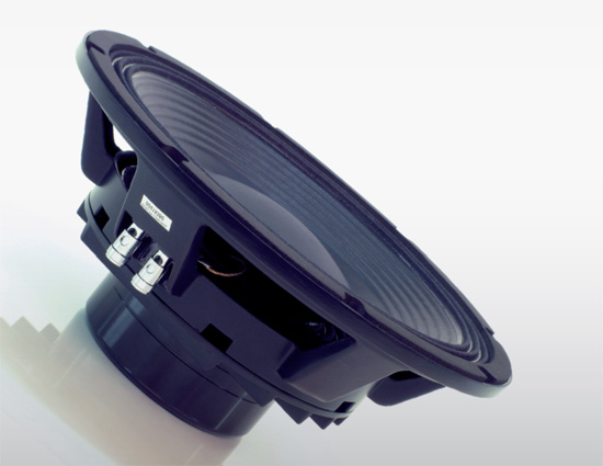

    Salget av Tractrix riggen går tregt. Jeg lager heller en fiks ferdig treveis halvpassiv løsning med miniDSP 2x4HD mellom horn og bass. Tar ut TD12M og monterer enten en 12» med bassrefleks eller en eller to 12» lukket. Må bruke eksisterende basskasse, har ikke råd/tid/lyst til å kassere den.
    Noen forslag på lignende driver som takler så lite lukket kassevolum som mulig?
    THE SUBWOOFER DRIVER
    The Duo Mezzo is supplied with the active Short Basshorn subwoofer, which is driven by two powerful 30 cm (12 inch) 600 watts (RMS) long-excursion drivers.
    The 12–ND600 is the result of an extensive and intense research of every single constituent part of an electro-dynamic loudspeaker, rethinking the basics and taking care of every detail, to withstand the extreme power conditions it has been designed to work in. All this investigation is reflected in the new and innovative technologies developed by Avantgarde Acoustic™ and applied in this new transducer.
    The 12–ND600 features a 4 inch voice coil with laminated former combining two different advanced technology materials to enhance the voice coil life and to ensure an optimum force transmission. A forced convection mechanism results in low power compression. This design has been optimized with the extensive use of miniature high temperature probes and real-time temperature acquisition systems, together with a thermographic camera to obtain real images of the heat distribution in the voice coil and forced convection effects.
    The Double Conex Spider with its diaphragm surround and the double spider have been carefully designed with the assistance of Finite Element calculations in order to match coherently, enabling long and controlled cone displacements.
    The 12–ND600 long excursion drive unit is characterized by its extremely high efficiency and utmost power handling capabilities. The extended controlled excursion is +/– 8 mm. Exclusive neodym magnets with a special under–pole magnet topology are used to maximize the flux density in the air gap and to eliminate energy leakage of the magnetic field. The powerful neodym magnet with a very strong BL power factor and the very stiff but light membrane will ensure highest resolution and authority even with complex signals at extreme sound pressure levels.

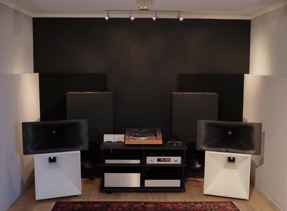

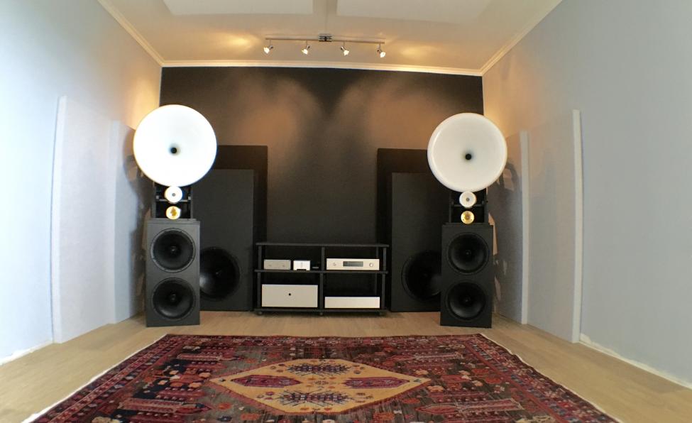

    Det siste bildet er slik det var.
    2384 med FLH er sånn det er.
    Ingen annen endring enn «satelitten».
    Litt forskjellig inntrykk med/uten vidvinkel.
    Rommet har en liten tøtsj av diger hodetelefon he he.
    Akkustikkpanelene er nødvendige. 12 av dem fra RPG*, 2 store DIY og 2 fra GIK med meget høy kvalitet og effektivitet. DIY og GIK er trukket med stoff fra RPG for match. Veggene er malt i lys blågrå nyanse og matt sort tilsvarende absorbent stoffene. Flåtene i taket har hvitt stoff. Snickers har målt etterklangen og han var positivt overrasket.
    * Modex Plate trykkbasert bassfelle, Absorbor absorbent og BAD panel hybrid diffusor.
    Majoriteten av rommene på Horten messa, på tross av at de er dobbelt så store, låter mye dårligere enn mittt.

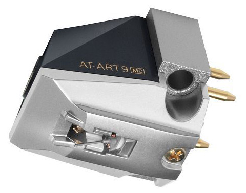

    hva skjedde med ART 9
