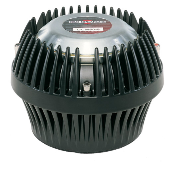

    Hei! Tittet litt på den B &C driveren, synes 5" hørtes sexy ut. Er databladet feil? Der står det voicecoil diameter 2"? Det er kanskje et std kont høyttalermembran inni, ikke en dome?
    permorten
    08.10.2005
    3.616
    1.751
    Stor mulighet for akkurat det ja, blir spennende å høre Hornlyd`s erfaringer med de.
    Hornlyd
    Musikkglad
    01.04.2005
    21.070
    13.555
    Yes. 5" dynamisk konisk driver med 2" voicecoil. Membran av "kompositt", papir har jeg lest et annet sted.

    Mer om B&C DCM 50
    GoodSoundClub - Romy the Cat's Audio Site - DCM50 and 1428
    [I]
    Romy,
    To clear up a few things about the Kilimanjaro RCA1428 clones.
    The B&C DCM50 is a modern, neodymium clone/copy of the RCA MI-1428B. It was designed and built by B&C in Italy after Bill Woods of AHhorns talked the CEO into it.
    The DCM50 is not an exact copy of an RCA1428 obviously, with a different case, different diaphragm, different phase plug and a different motor but it's very close basically to the original design. The large center suspended paper diaphragm is the main reason it sounds so good.
    It real does sound good. Bill Woods says the DCM50 on his 300 Hz AHhorn makes the most natural sound he's ever heard. That's a direct quote.
    A few years back, I commissioned Von Langa to modify a pair of DCM50s to field coil operation for me. That is the genesis of the so-called A1428WVL.
    That Wolf marketed them the way he did, has nothing to do with me, but I agree he should have mentioned they were modified B&C drivers. I notice he no longer markets them at all, perhaps B&C objected.
    By the way I researched and provided the information on MI-1428s to Herr Von Langa back when we were planning the build.
    As for f.c. voltage, my modified B&C DCM50s are fitted with 14V f.c. motors and work just fine with my inexpensive solid state PSs.
    My drivers are on 12-sided conical 300 Hz AHhorns and they sound great - beautiful upper bass/lower midrange, very realistic sound overall.
    The modded B&Cs replaced JBL 375s on 300 Hz tractrix horns. Compared to my 1428 clones the 375s sound tinny and artificial.
    I am very very pleased with the way my 1428 clones sound. However, I would not be surprised if the unmodified neodymium magnet DCM50s sound just as good or even better.
    Would be pleased to have you over Romy if you're ever on the West Coast and would like to check out the new horns and drivers.
    Peace,
    Kerry
    [/COLOR][/COLOR][/COLOR][/I][/I][/COLOR]

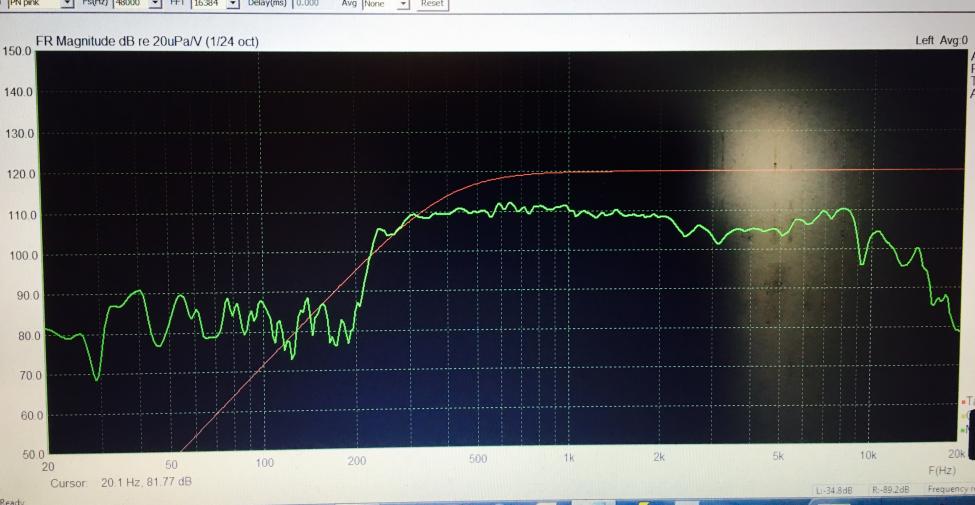

    Målt 35 cm foran hornmunningen.
    48 dB aktiv høypass ved 200 Hz pluss kondensator på 80 uF som DC beskyttelse.

    Jeg kjenner jeg blir på grensen til litt skremt av at han uttaler seg om øvre bass i et 300Hz horn. Normalt bør jo ikke et 300Hz horn deles i nærheten av 300Hz, spesielt ikke et konisk horn. For min del står vi dessverre da igjen med veldig lite troverdighet i en slik uttalelse. Enten passer dette tilfeldigvis utmerket i hans rom, han er ikke spesielt godt vant mht jevn spredning, eller han er bortimot døv.
    Uansett, det trenger ikke være noe galt med driveren av den grunn, den kan godt være helt fantastisk, men personlig skulle jeg likt å se den matchet med et enda større horn enn T200.

    Skjønner det. Kompromiss, kompromiss, kompromiss :)
    Kjører nå 400 Hz 24 dB og 7000 Hz 48 dB mot Fostex T500.
    Radian 475be i Tractrix 1000 står fortsatt i riggen men er enda ikke testet, vil gjøre meg kjent med B&C drivern først. Nå er det 50 cm vertikal c/c mellom Tractrix 200 og Fostex T500, ikke helt ideelt mtp loobing, vel vel.
    Dette her låter veldig fint, mer detaljer nedover og smoothere oppover. Jeg liker det.

    Beskrivelsen er litt samme som jeg kjenner da jeg gikk fra 2446 til BMS.
    Myke membraner, myk lyd :D
    Ser ut som det er noen oppbrytninger rundt 6-8k?
    Men den klarer vel fint 5k?
