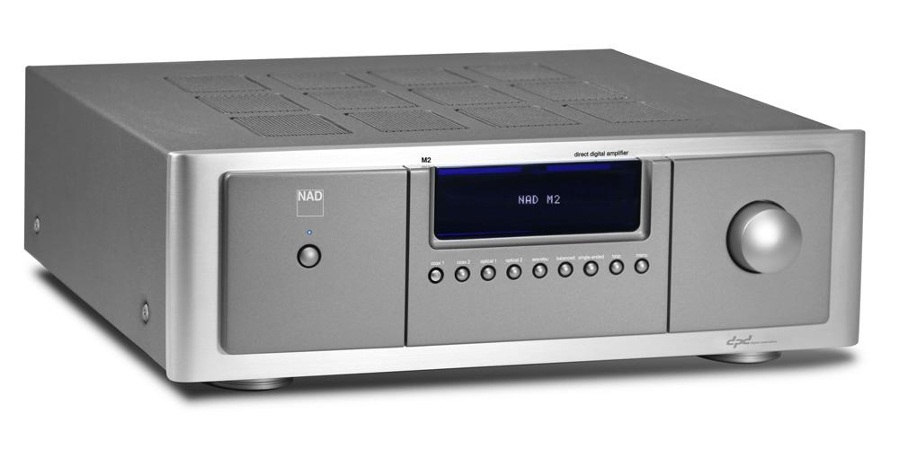

Breaking News! NAD M2 Direct Digital Amplifier
Espen R
25.03.2002
11.456
3.985
Kommer til en Hi-Fi Klubben butikk nær deg, snart!
NAD hevder at alle tidligere D-class amps har kommet til kort sammenlignet med tradisjonelle forsterkere, målemessig og lydmessig. De mener nå å komme med en D-amp som skal låte like bra, eller bedre enn de beste A og AB-forsterkere. Dette i samarbeid med Diodes Zetex Semiconductor. PCM signaler fra CD-spilleren omformes til et 108 MHz PWM (Pulse With Modulation) signal.
PRODUKTDATABLAD
Endelig noe nytt! :)
Espen R hører svært god lyd fra NAD M3, kan M2 spille like bra, eller bedre??
Espen R
25.03.2002
11.456
3.985
Available Late Summer 2009
The NAD M2 Direct Digital Ampli?er represents a new level of ampli?er performance. Combining the ultra low distortion and noise levels of the ?nest linear Class A and Class AB ampli?ers with the ef?ciency and streamlined signal path of the digital ampli?er, the M2 is the ?rst implementation of a new ampli?er technology called Direct Digital Feedback. Co-developed with UK based Diodes Zetex Semiconductor, and using a unique implementation of their patented DDFA architecture, the M2 rede?nes what is possible with digital ampli?er technology.
The M2 Direct Digital Ampli?er represents the culmination of a decade long NAD research project, capped by three years of intense development. The resultfully justi?es the investment. We believe that the M2 sets new benchmarks for both measured performance and subjective musical quality.
M2 Direct Digital Amplifier Features
?Direct Digital Amplifier
?2 X 250W Continuous Power at 8 and 4 Ohms
?>500W IHF Dynamic Power
?<0.004% THD 20Hz – 20kHz from 500mW to 250W
?>120dB Dynamic Range
?40uV Residual Noise
?>2000 Damping Factor at 50Hz +0/-0.5dB Frequency Response 20Hz – 20kHz, -3dB >85kHz
?Channel Separation >90dB @ 1kHz, 80dB @ 10kHz
?Digital PowerDrive
?Digital Soft Clipping (switchable)
?5 Position Digital Impedance Compensation Filter
Analogue-to-Digital Conversion
?A/D Conversion for Analogue Inputs
?Multi-bit Delta/Sigma 24/216kHz
?0.0004% THD
?Sample rate 32kHz - 192kHz
?124dB S/N Ratio
?High Resolution 120dB Digital Attenuator

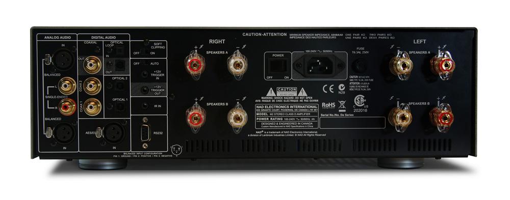

Ins and Outs
?Inputs Digital SPDIF: AES/EBU, Coaxial X 2, Optical X 2
?Inputs Analogue: Balanced, Single Ended
?Processor Loop: SPDIF Optical (Mac PC compatible) out/in
?2 Sets of Speaker Binding Posts to facilitate Bi-wiring
?Remote Control
Control Options
?RS-232 serial data port
?IR Input
?12V Trigger Input and Output
?<1W Standby Consumption
?90% Amplifier Efficiency
