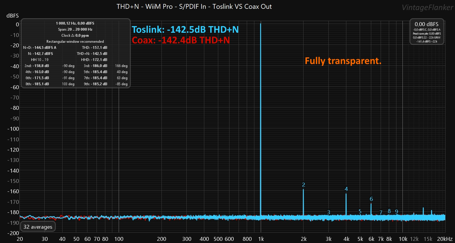

    Enig! Tro er noe man gjør i kirka. Objektive tester viser at Wiim Pro digital utganger er av ypperste klasse. Her er testresultatene av både tosling og coax lagt oppå hverandre:
    Wiim Pro Plus har samme resultat på sine digitale utganger men har en langt bedre innebygget DAC.
    Her er konklusjonen:
    Conclusions
    I will try to isolate both my subjective thoughts and objective findings each others for a little... If looking only at overall pure performance, the WiiM Pro is kind of a mess. While not being the worst I have seen, the DAC portion is nothing near suitable for 24 bits content, far from what we should expect from a product launched in late 2022 (at whatever price), and actually surpassed by some dongles. The ADC is even weaker, not to mention almost useless if you do not have a variable output, thanks to its 1Vrms rated max input. Among other scenarios, it will probably not degrade (even more) some phono signal, but what would be the point to use a turntable for ending in the digital domain that way? You vinyl guys tell me...
    On the other hand, we got the digital side. First, the app is cool, it works great, without noticeable bugs or lags. I enjoyed using it on a daily basis. Then, we have the unquestionable performance. It is indeed perfectly transparent when using Wi-Fi, and remains always stable even when streaming 192kHz tracks. The S/PDIF inputs/outputs are a great addition if you want, like me, a streamer feeding your DAC (with only one optical input), that may also catch a signal from a TV or another source. If I forget the (expected to be) poorly Bluetooth measurements, all digital inputs just work and measure great. Chromecast is one of the best addition over the regular WiiM Mini, since you may choose to bypass the WiiM Home App, using either Roon, or any major streaming service's dedicated app. I am personally still waiting for Roon Ready update, and would be glad to re-measure if the digital performance remains the same that way.
    Weighting the pros and cons, I will give the WiiM Pro my recommendation, based on how I would (and will!) use it for myself. For the price, it just does its job, and in a great manner. Period.
    Rating:
    WiiM Pro (analog in & out): Mediocre
    WiiM Pro (digital transport):
    Excellent
    Vis vedlegget 1101307
    Vis vedlegget 1101305
    Wiim Pro Plus har samme resultat på sine digitale utganger men har en bedre innebygget DAC.

    Bra? Samtlige Wiim streamere tilbyr referanseklasse når det kommer til kvaliteten på de digitale utgangene. Dette gjelder også Wiim Mini. Med andre ord, uansett hvilke Wiim streamer man velger så er det DAC`en dem er koblet opp til som vil være "flaskehalsen" og begrensningen. Her er toslink ut fra Wiim Mini:
