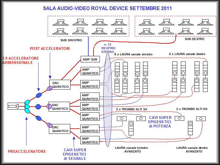

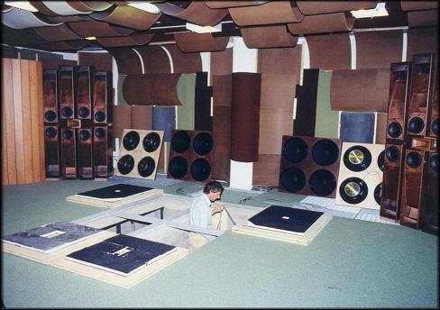

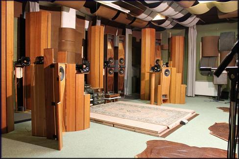

    Slik,full output til 10Hz,betong gulv,vegger og tak = ingen vegger,gulv eller tak som vibrerer
    [h=2]World record claims[/h]
    16 stk. som her,klar til montering
    Subwoofer - Wikipedia, the free encyclopedia
    Royal Device custom installation[edit]
    Another subwoofer claimed to be the world's biggest is a custom installation in Italy made by Royal Device primarily of bricks, concrete and sound-deadening material[14] consisting of two subwoofers embedded in the foundation of a listening room.[80] The horn-loaded subwoofers each have a floor mouth that is 2.2 square meters (24 sq ft), and a horn length that is 9.5 meters (31 ft), in a cavity 1 meter (3 ft 3 in) under the floor of the listening room. Each subwoofer is driven by eight 18-inch subwoofer drivers with 100 millimeters (3.9 in) voice coils. The designers assert that the floor mouths of the horns are additionally loaded acoustically by a vertical wooden horn expansion and the room's ceiling to create a 10 Hz "full power" wave at the listening position.
    Her lekes det ikke.Skal det være så skal det være.
