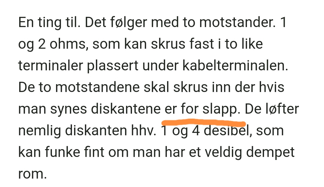

Fra manualen:
  1. Attenuation is accomplished by placing a resistor in the attenuation position on the connection plate (see Figure 1 on next page). Provided with your speakers are 1 and 2 ohm resistors for this purpose. These resistors will provide 1 to 4 dB of attenuation.
 If you continue to have a brightness problem you might consider room treatment.
Attenuation skal forstå´s som senkning, IKKE økning av niveau. Bad translation :LOL:

Ang.motstandene:
  1. Tweeter attenuation-- The tweeter attenuator jumper provides maximum tweeter volume for heavily-damped rooms. Your room may require tweeter level reduction by inserting a resistor in place of the jumper.
