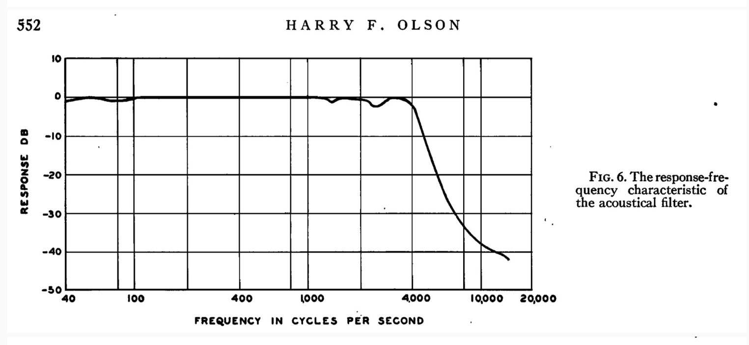

    Som jeg skrev tidligere svart-hvitt har du gjort deg skyldig i (bevisst?) feiltolking av Olsons eksperiment. Grunnen til at han gjorde det live var dessuten en dyd av nødvendighet som fremgår klart i intervjuet.
    Intervju av Harry F Olson gjort i 1975 av Mark Heyer
    We set out to perform what is now considered a classical experiment. We arranged an acoustic filter between a live orchestra and the listeners. The acoustic filters were in the form of doors that could be turned in and out. In other words the filter could be placed in or out of operation. A light opaque sound transmitting curtain was placed between the listeners and the acoustic filters so that the listeners could not see the filters or what transpired behind the screen. The high-frequency cut-off of the filters was 5,000 hertz. When the filters were turned out, the listeners received the full frequency range from the orchestra or speech. Tests were performed with people from all walks of life. The experiments indicated a preference of 70 percent for the full frequency range. This showed that there was something wrong with reproduced music and speech. An investigation indicated that it was indeed distortion which brought the people to prefer a limited frequency range. When the distortion was eliminated, high-frequency sound reproduction took off and burgeoned during the following year. Today, reproduction of sound occurs over the entire audio frequency range.
    . Later we started work on improving the frequency range of loudspeakers. We ran into the difficulty that the people did not prefer this due to distortions in the system. We did develop these for NBC, for monitoring loudspeakers. From the microphone through the amplifier we had very low distortions, so there was no problem there. But in the case of the phonograph and the radio, in order to produce instruments of low cost, the distortion was indeed high.
    Olsons filter er temmelig skarpt og representer ikke noen form for relevant preferanse for dagens lyttere da årsaken, nevnt flere steder i intervjuet, forlengst er historie.

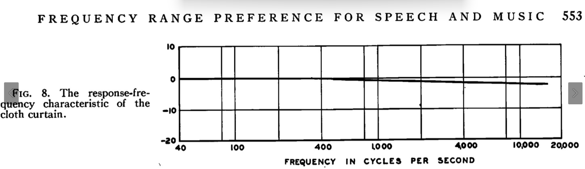

    Også verdt å merke seg at forhenget man brukte til å skjule eksperimentet også påvirket lyden. Noen øvelse i nøytralitet var det altså ikke.

    1. Ja. Det bekrefter jo poenget mitt. Sett den også i sammenheng med diskusjonen om X curve som jeg postet. Jeg fokuserer på energibalansen mellom topp og bunn. Dvs at en tidlig avrulling i topp eller heving i bunn kan være akkurat det samme.
    2. Absolutt, men Olsons eksperiment som du mener dokumenterer publikums preferanse for flat bass var med et levende orkester. Poenget mitt er at eksperimentet til Olsons strider mot liknende forsøk med orkester der publikum foretrekker heving i bassen. Et orkester er vel heller ikke pink noise eller et testsignal?
    Ad 1: Du skrev: "...en tidlig avrulling i topp eller heving i bunn kan være akkurat det samme".
    Har du tenkt over at kurven med avrulling i Olsons forsøk kan være det samme som heving i bassen?
    Ad 2: Orkesteret i Olsons forsøk spilte på en måte som ga et naturlig rombidrag, og potensielt en like naturlig "heving i bassen". Det folk hørte med det akustisk transparente filteret, var en avspilling med et naturlig rombidrag. Hvis man tar opp denne lyden, får man med seg hele pakken av orkester pluss rombidrag. Ved avspilling ønsker man ikke å oppnå et slikt rombidrag én gang til, og derfor er nesten 100 år gamle romkurver helt flate i bassen.

    From the horses mouth
    Vis vedlegget 926431
    Vis vedlegget 926432
    Igjen: Olson viste at folk flest (7 av 10) foretrakk lyd helt uten filter. Han skjønte naturligvis dette på forhånd, så jeg tror ikke man skal lese Olson som en som erstatter vitenskap med preferansestudier.
    Snart 100 år gamle romkurver er flate i bassen fordi man ikke ønsker å oppnå rombidrag i bassen to ganger; på opptak og på ny ved avspilling.
    Nei, jeg leser den som en konsekvensanalyse.
    Han forklarte veldig godt årsaken til at den tidens lærde hadde kommet frem til feil konklusjon vedrørende tilstrekkeligheten av en båndbredde på 5kHz.

    Nei, det var jo ikke det han viste. Har ikke sett ham presentere annen responskurve enn den på filteret og den på forhenget. Han har dessuten ikke nevnt flat kurve med et eneste ord, det er din omskriving.
    Og om du ikke ser forskjellen på å øke basskraften og dempe toppen i en live uforsterket opptreden...Et stikkord, ingen volumknapp.
    Den ene kurven til Olson er helt flat.
    Du har ennå ikke klart å forklare hvorfor nesten 100 år gamle romkurver, moderne standarder og kjente lydfolk kjennetegnes av helt flat bass. Gjør et forsøk.
    Her er misforståelsen din, tror jeg. Du forutsetter følgende prosess:
    1. Opptak av orkester sånn det låter i konsertsalen (med litt rombidrag i bassen), gjort med "flat" mikrofon
    2. Miksing/mastring i et rom uten rombidrag, der man kun hører det som er på opptaket
    3. Avspilling i et rom der bassen får litt naturlig forsterking
    for da får man rombidraget "to ganger" eller dobbelt opp, der det er rombidrag i opptaket og i avspillingsrommet, og ingenting er avstemt med hverandre.
    Men realiteten er noe i retning av følgende, og dette har du sitert Bob Katz på ca. en million ganger:
    2. Miksing/mastring i et rom med rombidrag, der man hører omtrent det man vil høre i en gjennomsnittlig stue. Se også standardene du stadig viser til, de åpner for rikelig med rombidrag i bassen.
    Og da får du rombidraget to ganger, men på en god måte, fordi det skal være der.

    Jeg tror du "tror" og legger ALT for mye i den eldgamle studien @svart-hvitt, som absolutt ikke var tenkt som en besvarelse på de spørsmålene jeg opplever at du er mest opptatt av, men som er gode spørsmål. Og så kan man sikkert generalisere og ekstrapolere men det finnes grenser, og de er for lengst overskredet, det forstår de fleste som selv har gjennomført empiriske studier av denne typen, og det inkluderer meg selv. Du mangler liksom metastudiene som bekrefter dine generaliseringer. På tide å gjennomføre noe slikt selv kanskje? Abonnerer du på AES? Jeg tror du med fordel kan vinne på å åpne øynene for den forskningen som foregår i dette århundret, spesielt siste 20 år kanskje, rundt akustikk og lyd.
    Jeg synes Olson-eksperimentet er artig fordi han utfordret manges antakelser om «riktig» lyd for 80 år siden.
    For øvrig har jeg vært medlem av AES i flere år.
    Når jeg har vist til artikler, standarder mv. fra AES tidligere, har jeg blitt møtt med kritikk om «name dropping», ikke å kunne tenke selv osv. Det er kanskje å forvente i diskusjoner på nett?
    Poenget mitt med å ha tilgang til materiale fra AES, er ikke å kunne skryte - men veie fagkunnskap opp mot myter og påstander som dukker opp på nettfora.
