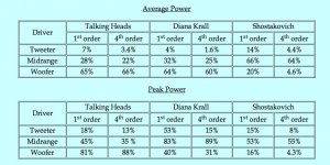

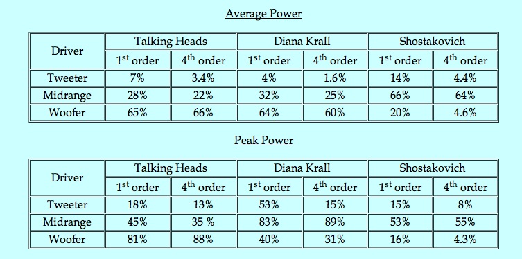

Du stiller en mengde gode spørsmål i ditt åpningsinnlegg. Jeg likte hvordan Ludwig tar for seg forvrengning.
Art Ludwig om emnet:
When I play the Talking Heads cut, my CLIO sound measurement system shows a peak sound level of 100 dB SPL in the room, and an average of around 95 dB. Judging from the oscilloscope connected to the amp outputs, the average amplifier output power appears to be about 17 watts. The ratio of peak power to RMS power was 40:1, 40:1 and 30:1 for the Talking Heads, Diana Krall, and Shostakovich cuts respectively. Therefore, for 17 watt RMS, the peak power demands are on the order of 700 Watts. This indicates that either my amps can put out peaks much higher than their rated power (possible, but I'm not sure), or they are clipping. There are demo files In the sound demo section which simulate clipping by tube and solid-state amplifiers. For more on this subject see the section on amplifier distortion.
Jourdain (page 41) states that an orchestra produces 67 watts of acoustic power at full blast. Loudspeakers have efficiencies on the order of 0.5 to 2% converting electrical power to acoustic power. Even at 2% efficiency this implies that well over 3,000 watts of electrical power would be required to duplicate this sound level. Of course an orchestra plays in a large auditorium, and no doubt less power is needed for a small room. This still indicates that power requirements should not be underestimated
Dette var grunnen til at det var 2500W forsterkeri i hver av mine forrige høyttalere. De skulle ha tilstrekkelig headroom til at alle slike overganger ble bedre tegnet.
.......the average amplifier output power appears to be about 17 watts. The ratio of peak power to RMS power was 40:1, 40:1 and 30:1 for the Talking Heads, Diana Krall, and Shostakovich cuts respectively. Therefore, for 17 watt RMS, the peak power demands are on the order of 700 Watts. ......
Forholdene 40:1 og 30:10 mellom rms og peak er da veldig mye. Slik han bruker dette i sine beregninger er dette forholdet i Watt og ikke i db. Fra loudnesstråden ser vi at det i beste fall kan være opp mot 30 db mellom rms og peak. Mellom 10 og 15 er det vanlige dessverre. Men dersom vi fastholder 30 db er dette en 10 dobling av effekten (6 db er en dobling etc.).
Da trenger vi "bare" 170 Watt i Ludwig sitt eksempel.
Så, om man har horn...... lettdrevne.....

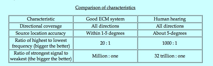

Her er Ludwigs oversikt over følsomhet:
At one point in my life I designed Electronic Counter Measures (ECM) systems for the U. S. military. The primary function of an ECM system is to detect an enemy before he (it's rarely a she) detects you, for self-defense. It is interesting to compare the characteristics of a good ECM system and human hearing:
Og målingene som ligger til grunn for forholdstallene på Talking Heads, osv.
Hans vurderinger omkring disse er lærerike.
http://www.silcom.com/~aludwig/EARS.htm
