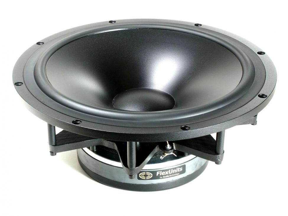

    8x12_TOM
    Mye bra her men alt for lav Qms
    Flexunits 15 E 102 25 10
    Resonance frequency - fs:18 Hz
    Equivalent volume - Vas:600 liter
    Qms1,5
    Qes0,26
    Qts0,22
    Nominal resistance - Zn8 Ohm
    DC resistance - re:6 Ohm
    Effective cone area - Sd:835 cm2
    Compliance – Cms:0,615 mm/N
    Mechanical resistance – Rms:9,59 kg/s
    Moving mass – mms:127 g
    Inductance 1 KHz – Le:0,98 mH
    Force factor – Bl:18,22 N/A
    Winding height – Hc:25 mm
    Air gap height – Hg:10 mm
    Nominal power – Pn:400 W
    Acceleration factor:143
    Efficiency – SPL:93 dB
    Linear excursion (x-max) 8.6 mm
    Max. excursion (P-P)46mm
    Vis vedlegget 293865 Flexunits 15 E 102 25 10
    18
    Hz
    600
    liter
    Qms
    1,5
    Qes
    0,26
    Qts
    0,22
    Ohm
    DC resistance - re:
    Ohm
    835
    cm2
    Compliance – Cms:
    0,615
    mm/N
    9,59
    kg/s
    Moving mass – mms:
    127
    g
    0,98
    mH
    Force factor – Bl:
    18,22
    N/A
    25
    mm
    mm
    Nominal power – Pn:
    400
    W
    143
    Efficiency – SPL:
    93
    dB
    8.6
    mm
    46
    mm
