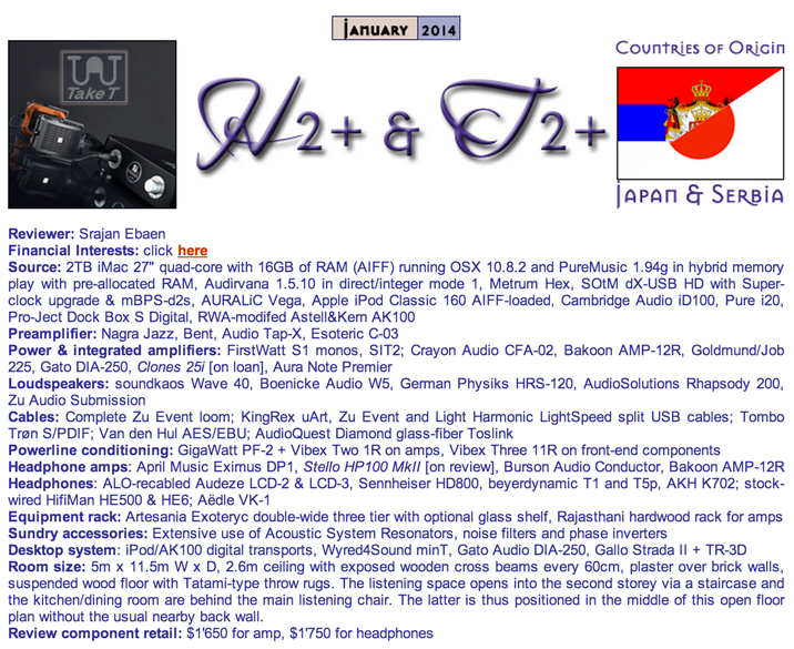

    Siden sist så har 6moons kommet opp med to nye sider - uten noe fysisk å ta utgangspunkt i, skrivelyst har dem.
    6moons audio reviews: TakeT H2+ & Trafomatic Audio T2+
    Det som jeg trodde i utgangspunktet var det ferdige produktet, omtales nå som "Early prototype"
    Side 3 (6moons) viser en del spennende ting:
    Funny we already knew to be Sasa code for challenging. For the T2+ he had another. Bullshit. That's Serbian for when things that should work don't work. This project had a lot of it. Had he known in Norway's Bergen what he'd learnt since, he'd not have volunteered. Apparently the wicked TakeT load made ultra-specific demands on his circuit and was rather diva-esque about obeisance. The H2+ did not like Sasa's toroidal power transformer, his 20-Henry choke-filtered power supply, his 6S45 driver tubes, his triode output stage, his purist zero feedback or convenient auto bias. The power trafo had to go EI, the chokes became Fet stabilizers, the double C-core output transformers insisted that their silicon-steel cores be ground isolated, the driver tubes became ECC88 and a final <3dB global feedback loop between triode input and single-ended now ultra-linear output stage was necessary to tweak the headphone's frequency response and boomy bass.
    Litt usikker på om dette var noe Sasa fant ut etter vinterferien, men det resulterte i ny design.
    The 1:1 ratio output transformers grew in size over the prototype units and the final output power into 6KΩ was fixed at 4.1 watts. (Direct-heated triodes with usual 3KΩ Z-out would have needed a 1:2 step-up ratio whose associated sonic compromises rendered their lot unfit for the TakeT.) The fixed bias on the EL34 had to lock at precisely 3mA as anything even slightly over or under reflected poorly on the H2+'s treble response. The coupling caps between valve stages wanted to be Auricap, the power supply asked for Mundorf. The enclosure's original footprint stayed put but grew in height just a tad to accommodate the beefier output iron. After wading through his personal brand of bullshit, Sasa was beginning to feel happier. "Much better than with the Japanese step-up transformers".

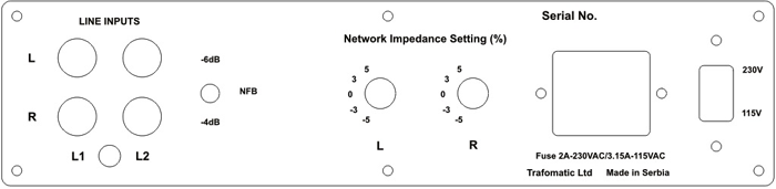

    Just when I thought our tech facts were a wrap, Sasa had this: "Development finally finished a few days ago. The drawing below shows how I had to leave the impedance correction settings at the back separate for both channels. On the H2+ each side measures almost 10% different. I must suppose that's standard and account for it. With my dual-mono settings both channels can be perfectly balanced. For the NFB settings I couldn't decide whether 4dB or 6dB of feedback were better. Now I let the end user make that determination. I'll start production next week and after some 50 hours of burn-in here at the factory, I'll ship the review loaners to you."

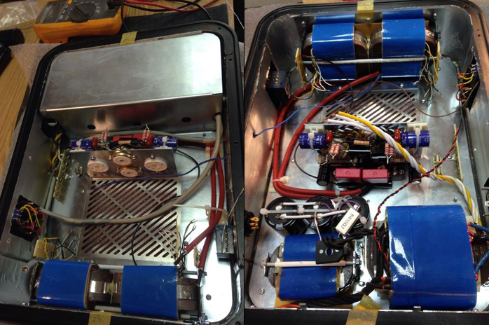

    Begynner å ligne ferdig.
    Tar jeg ikke helt feil så er utgangstrafoer plassert i metallboksen, inngangstrafo den vi ser oppe til høyre. AC/DC nede til høyre. Impedansnettverket er forseglet i en ramme av finér. Rør og forsterkerkrets nede til venstre.
    Monsterforsterker, helt klart ikke portabel.

    Bilde av baksiden.
