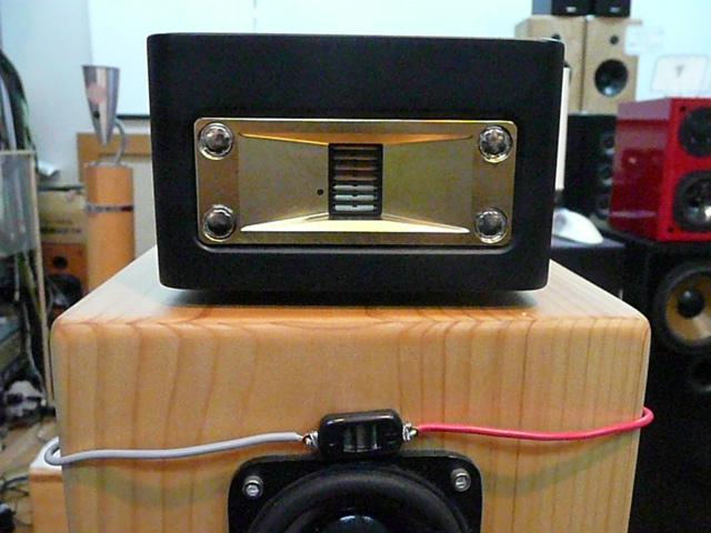

Hva med denne?
SPEC:
Maximum Rate100V(However, the test signal by 20kHz or more: should be under 20V).
The protection circuit operates over 100V. It return to the origin when you turns off power and
a few minutes pass.)
Impedanceinfinity-140Ω-28Ω(direct current-20kHz-100kHz)
Frequency Response18kHz~150kHz or more(It is cut steeply under 18kHz by Heil type structure and capacitor.)
Maximum Output Sound Pressure100dB/W/m( selectable five stages)
Drive System TAT-driver(Heil type bailiff polymer Pietro-electric driver)
Dimensions110x70x100mm
Weight720g
Pris: kun GBP 860.00
