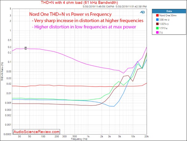

    Nord med NC500 ble testet av Audioscience med greit resultat:
    https://www.audiosciencereview.com/...-and-measurements-of-nord-one-nc500-amp.7704/
    Conclusions
    I went into this review expecting better results than I achieved. Despite higher designation, the NC500 seems to be a lower performing module than NC400. How much the input buffer board adds to this, is unknown until we test other variations.
    That aside, you are getting huge amount of clean power here that outdoes all of the bargain amplifiers we have tested so far (switching or not). At nearly 500 watts into 4 ohm, you should have ample power to drive anything from subwoofers to main speakers. The extremely high signal to noise ratio should be silent in use. Price is reasonable assuming shipping is not too expensive and it includes the input buffer.

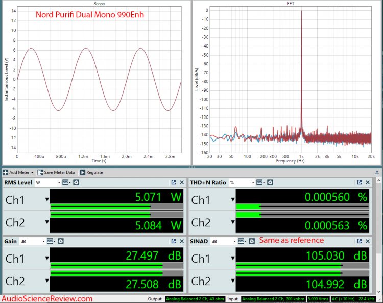

    Conclusions

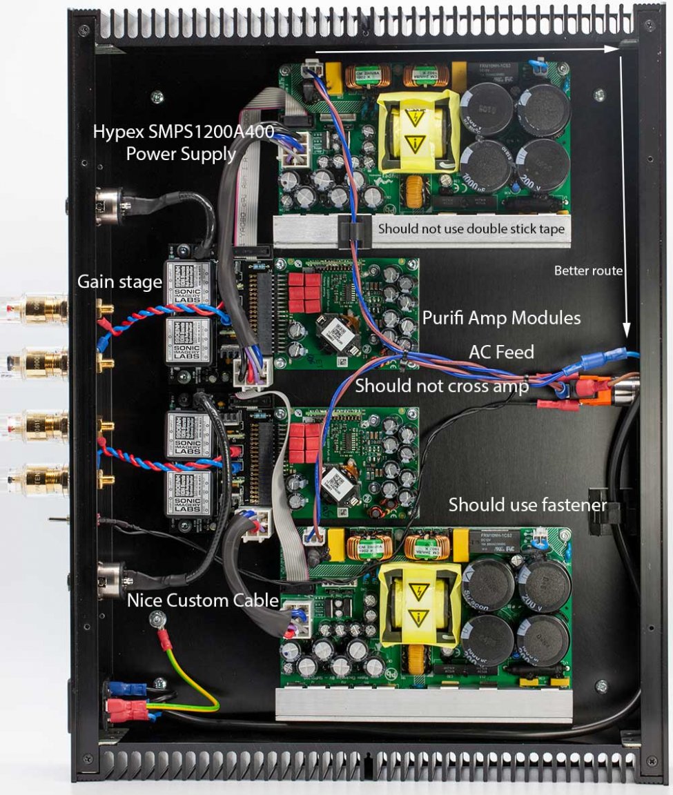

    The Nord Three SE 1ET400A Dual Mono Stereo Amp is an attractive build of the Purifi class D amplifier technology. The dual mono configuration raises the price fair but but my belief is that it will last a lot longer than the single power supply version. Measured performance is just a bit worse than Purifi reference design as power increases beyond 25 watts or so. Not an audible difference but would be good to figure out where this is coming from. I can't detect any improvement from Sonic Imagery discrete 990enh opamps. So personally I would go with the stock gain stage and save enough money for a night out alone.
    I am happy to recommend the Nord Three SE 1ET400A Dual Mono Stereo Amplifier. It builds on state-of-the-art Purifi amplifier modules and delivers it in nice packaging.
    NC500 er ikke dårligere enn NC400, men det handler om implementeringen og da spesielt i forhold til buffertrinnet og strømforsyningen. NC500 selges uten buffer og dermed er det opp til produsentene hva de bruker her. NC400 har innebygget buffer av god kvalitet.

    Målingene kan skille en god del. Spesielt relatert til støy og evne til å dra vanskelige laster.
    Ser du f.eks på THD+N målingen til audiosciencereview av Nord One med 440W (rosa graf) og sammenligner den med P400/1000 med 500W, så ser du markant forskjell i forvrengningen i lavere frekvenser.
    Nord One NC500 Amplifier THD vs Level vs Frequency Audio Measurements (Tilpasset).png

    Det er litt interessant å sammenligne Nords implementasjon av Hypex NC500OEM med Purifi 1ET400A. For meg ser det ut til å være samme strømforsyning og samme layout innvendig, men likevel en ganske stor forskjell i ytelser.
    NC500OEM:
    1ET400A:
    https://www.audiosciencereview.com/...easurements-of-purifi-1et400a-amplifier.7984/
    https://www.audiosciencereview.com/...rd-three-se-1et400a-dual-mono-teardown.10010/
    Nord Three SE 1ET400A Dual Mono Stereo Amp With  Sonic Imagery 990Enh Teardown.jpg
    Nord Three SE 1ET400A Dual Mono Stereo Amp With  Sonic Imagery 990Enh Audio Measurements.jpg
    Det er eksakt samme strømforsyninger og samme layout. I databladene har 1ET400A ca 4 dB lavere THD+N enn NC500OEM ved 10 W ut, så resten må være på grunn av inngangsbufferne.
