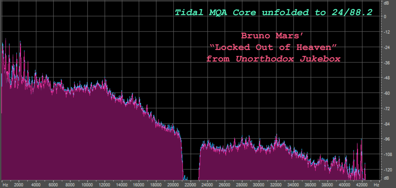

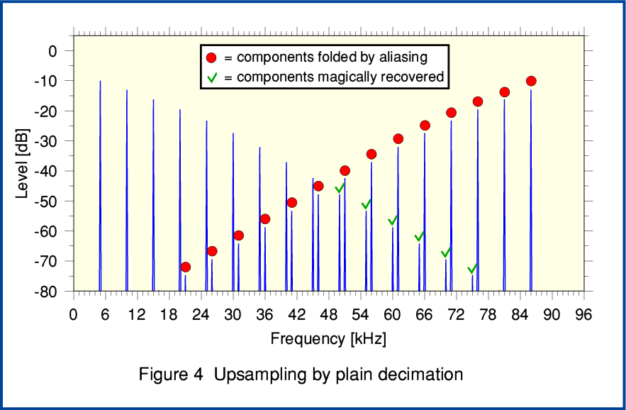

    ... for så å «brettes ut» igjen ved oppsampling når det skal avspilles:
    Vis vedlegget 726165
    Jeg tipper det er hva som skjer i «first unfold». Nye ultrasoniske frekvenser skapes fra både de nedfoldede aliasene og fra det egentlige audiosignalet. Neste steg er en filtrering av de ultrasoniske frekvensene for å redusere nivået til noe som ligner mer på det opprinnelige signalet. Resultatet kan bli noe slikt:
    Vis vedlegget 726167
    Tror dette stemmer bra. En fyr på ASR som satte det sammen sånn:
    Folded…
    "See whats going on here? The HF is a perfect mirror image of the LF, just with a lower level and a sloping.
    You know what they call that in circles outside of MQA: aliasing... of the worst kind! So please stop telling us that MQA somehow solves aliasing, because all evidence points towards the expact opposite."

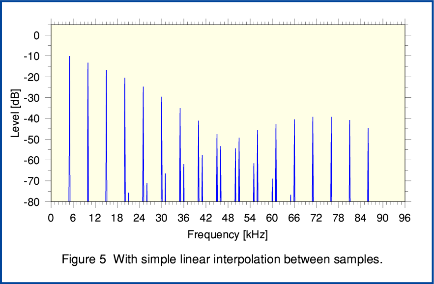

    Hva betyr «post-Shannon developments in sampling theory» i denne sammenhengen?
    Ikke så mye om MQA her: https://ece.uwaterloo.ca/~ece413/MISC/Shannon.pdf
    Her, derimot: http://www.iar-80.com/page170.html
    MQA's 'impulse response' is indeed extremely short, and indeed uniquely so, just as MQA boasts (even rivaling air itself). In fact, MQA's intrinsic impulse response is uniquely so very short (as shown in the Stuart/Craven AES paper) that it extends only 5us to at most 8us (at its -10 dB point) into each sample interval, thus does not even span the 20us sample interval (48 kHz sample rate). But this technical feature, instead of truly being MQA's greatest technical asset, is actually the complete opposite, its worst technical liability, which causes its worst sonic defect. MQA's very short 'impulse response' means that its coefficient function, which is the guiding template for the playback reconstruction filter, cannot gather the information required for reconstruction, not even over the entire span of one sampling period. Thus, MQA's reconstructed time domain signal waveform cannot effectively even span one sampling period. This might not be a severe problem when connecting the dots for a low frequency repeating sine wave. But it is deadly when trying to reconstruct a single transient attack that does not repeat (that's what makes it transient) and that contains high frequencies (that's what makes it an attack).
    Consider a transient attack's sharp and narrow single peak, from a Bob Dylan guitar pick, just as we heard it in MQA's own MQA vs. PCM A-B. Suppose the signal waveform of this sharp, narrow peak happens to be initially sampled unluckily (just as most high frequency peaks are likewise unluckily sampled). The sample dots will be way down on the flanks of this transient attack peak, and the high peak itself will have occurred somewhere near the center of the sampling interval, so its high peak amplitude will not be represented directly by any sample dots at all.
    How does MQA, with its very short, nearly 'ideal' impulse response, reconstruct this unsampled transient attack peak to play it back correctly, in the time domain that MQA boasts of such superiority in? It doesn't. Instead, MQA, with its extremely short 'impulse response' that's even shorter than a sample interval, can only see the sample dot information very near each dot, thus only at and from each one dot itself. Thus, MQA can reconstruct, for its time domain playback, only two isolated low amplitude narrow spikes, representing the two sample dots that sampled the low skirts of this transient attack peak, but unluckily entirely missed the high amplitude sharp peak itself. What then does MQA do with this high amplitude sharp transient attack peak that was there in the original signal of the guitar pick? MQA can never even see this peak, so it never reconstructs it, thereby utterly erasing it (or at the very least eviscerating the true hard peak strength of this guitar pick's transient attack).
    We have before us a fascinating technical riddle: when is the 'best possible' performance actually the worst possible performance? Answer: when the designer's technical comprehension is so wrong that it is entirely backwards, the very opposite of the technical truth. In this case, MQA attempts and achieves the best possible time domain 'impulse response', that is as close as possible to their engineering 'ideal' - but, because their comprehension of how digital actually works is so wrong it is backwards, their well-intentioned but naively wrong-headed achievement of nearly ideal time domain 'impulse response' performance actually produces the worst possible time domain distortion in MQA's attempted reconstruction of the original pre-sampled signal waveform. Indeed, MQA's actual time domain reconstruction is so bad that it is virtually equivalent to not having any time domain signal reconstruction at all, to not even having any reconstruction filter at all.

    Den er kjent på ASR. Jeg fant artikkelen via en link derfra. Analysen i denne artikkelen stemmer veldig godt overens med både mine egne subjektive lytteinntrykk når MQA er involvert (etslags soft-filter som glatter ut transienter) og med de modulerte bølgeformene etter en impulsrespons som har blitt vist tidligere i tråden.
    Hvorfor man ser så lite av den typen analyse er jo et godt spørsmål. MQA Ltd og Mr BS, M.Sc., nekter å gå inn i noen teknisk diskusjon om hva den manicken deres egentlig gjør. Publiserte papers og patenter beskriver noe, men det er kanskje-eller-kanskje-ikke relevant for MQA som det er implementert. Veldig relevant hvis det gjelder å skryte på seg akademisk troverdighet, men seeeelvsagt ikke relevant i det hele tatt hvis det står noe der som kan brukes til å kritisere hva som skjer i MQA-prosessen. Da går man raskt over til å angripe budbringerens troverdighet i stedet.
    Dessuten er det vel riktig å si at digitalteknikk med Shannons samplingsteorem og det hele kanskje ikke er veldig godt forstått av veldig mange. Det er relativt enkelt å legge ut et røykteppe for alle andre enn de spesielt interesserte ved å vise noen misvisende grafer av impulsresponser og lignende. Vanskelig å bli hørt hvis man forsøker å si at det faktisk forholder seg motsatt - filtre med lineær fase gir i virkeligheten best gjengivelse i tidsdomenet, mens filtre med minimum fase gir en frekvensavhengig tidsforsinkelse og fasedreining av signalet.
    Forfatteren av den lenkede artikkelen ser ut til å ha litt innsidekunnskap om hvordan MQA-codecen ble til:
    You see here a fascinating case study (and educational object lesson) showing how engineers who blithely and carelessly make an assumption, that happens to be so wrong it is backwards, can then lead themselves to go awry (indeed run amok) in misinterpreting subsequent empirical tests, and thereby be spurred on to design 'fixes' for this mis-interpreted 'problem', said 'fixes' actually making their system even worse instead of better.
    In this case, MQA's design engineers see the virtually 'perfect, ideal impulse response' they have created in MQA, and blithely assume that this means MQA produces virtually perfect time domain reconstruction of the original music signal waveform (they never suspect that this 'impulse response' actually means the complete opposite, namely that MQA in fact produces the worst possible distortion of the 'reconstructed' signal waveform). They, assuming that MQA's native reconstruction and signal accuracy is perfect, then conduct an experiment wherein they deliberately add an extra dose of very high frequencies, and they find that this makes purportedly 'perfect' MQA sound even better. They conclude from this experiment that very high, ultrasonic frequency music information is indeed audible, and also beneficial. So they then devise a further twist to MQA's design, whereby it deliberately discards bits 17-24 of bit depth signal resolution, and uses those bits to instead encode ultrasonic music information, which they deem to be sonically more beneficial than the fine musical detail offered by bits 17-24 of bit depth signal resolution.
    But this is actually yet another huge blunder by MQA. MQA's designers don't have a clue that all their thinking here is backwards, about their assumption, about their experiment, about their mis-interpretation of their experiment (and their inference and conclusion therefrom), and finally about their further twist to MQA's design, of adding yet more ultrasonic energy, devised in response to their backwards mis-interpretation of everything.

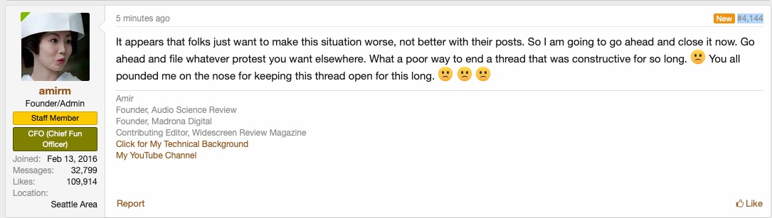

    Ingenting er mer passende en at tråden avsluttes med sutring fra the Chief Fun Officer

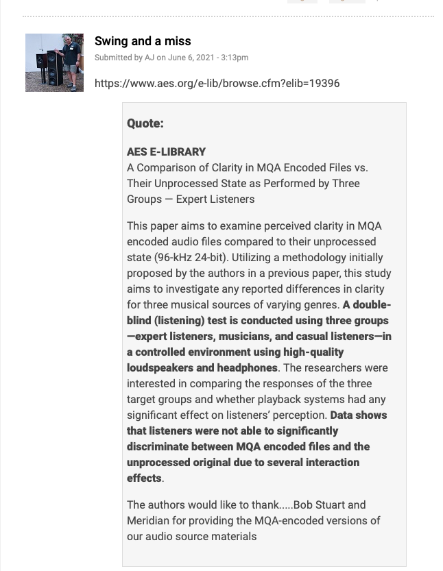

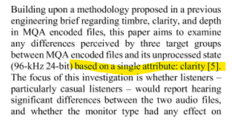

    Interessant, men det er et par små varselsignaler der:
    OK, så hvordan definerer de "clarity", og hvordan skiller de ut om en opplevd forskjell er en forskjell i "clarity" eller ikke? For meg ser ikke det sammendraget ut til å støtte en konklusjon om at "MQA er transparent med 24/96", men snarere "vi greide ikke å påvise en systematisk forskjell i egenskapen 'clarity'". En opplevd forskjell i "timbre" eller "depth" vil jo være noe annet her. "Interaction effects" kan for eksempel være at det er litt uklart hva lyttepanelet tilskriver en endring i "timbre" vs "clarity". Avrulling i toppen og/eller glatting av transienter vil jo påvirke begge egenskapene.
    Og hvorfor avgrenser de studien på den måten heller enn å stille de opplagte spørsmålene 1) Er MQA transparent, dvs ikke hørbart forskjellig fra 24/96 master? Og hvis nei, 2) Hva foretrekker lytterne, originalen eller den «forbedrede» MQA-versjonen? Metodemessig ville det være en langt enklere studie å gjennomføre og et langt mer interessant resultat.
    Vis vedlegget 727764
    OK, så hvordan definerer de "clarity", og hvordan skiller de ut om en opplevd forskjell er en forskjell i "clarity" eller ikke? For meg ser ikke det sammendraget ut til å støtte en konklusjon om at "MQA er transparent med 24/96", men snarere "vi greide ikke å påvise en systematisk forskjell i egenskapen 'clarity'". En opplevd forskjell i "timbre" eller "depth" vil jo være noe annet her. "Interaction effect" kan for eksempel være at det er litt uklart hva lyttepanelet tilskriver en endring i "timbre" vs "clarity". Avrulling i toppen vil jo påvirke begge egenskapene.
    Leste artikkelen raskt og vil si det er metodisk meget bra gjennomført studie for en gangs skyld og med god kontroll på statistikken (som ellers ofte er svært shady). Interaction effect her refererer til klassisk statistisk interaction mellom treatment (format og sang ) og subjekt (evt. subjektkategori). Men det var ikke mye som kunne konkluderes her nei... noe som er ganske normalt med for små eksperimenter med for lite power. Men basert på boxplotene så tviler jeg på om man noensinne vil kunne konkludere den ene eller andre veien med mindre man har minst noen hundre deltakere (og ikke bare 30), til det er effektstørrelsen av forskjell i format alt for liten... Så man kan i hvert fall si at forskjellen mellom opplevd "clarity" mellom MQA og originalversjon i 96/24 var svært små.. Men ja, som du sier, som vanlig er den avhengige og svært subjektive variablen "clarity" i dette tilfellet ganske dårlig validert i utgangpunktet. De kunne like gjerne skrevet "quality", "mangel på grums" eller et hvilket som helst annet begrep som er ment å si noe om preferanse eller forskjell.
