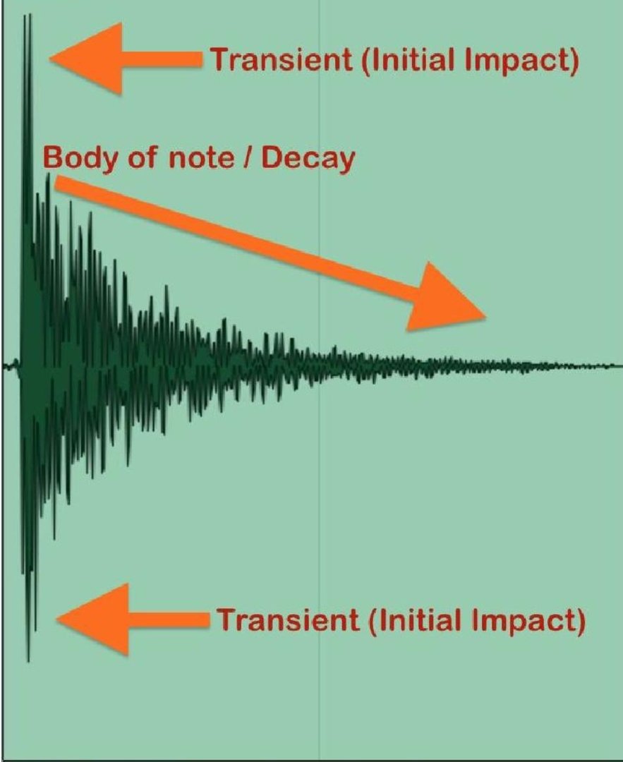

    Macro and micro dynamic
    If you delve into the literature on audio levels and dynamics, you may come across terminology like macro and micro dynamics. The terms themselves are not all that common, but they do serve to illustrate the different ways dynamics are addressed in recording and mixing. Macro dynamics refers to changes in level over a longer period of time. For example, a rhythm instrument—guitar, keyboard—may play more quietly in the verses of a song, than in the choruses. Micro dynamics might refer to either of two things. It could describe more rapid changes in dynamics, like from note to note in a phrase, where some notes are accented (louder). It could also be used to describe differences in level within a note—for example, a hard-played piano note or drum hit will start off with a louder impact noise—a Transient—and then the rest of the note will be lower in level, gradually (or quickly) decaying to silence. The waveform graph in Fig 3 shows level (vertical) vs. time (horizontal), and you can see the variation in level of a typical percussive note, with its initial Transient, which lasts only milliseconds (thousandths of a second), and the main portion of the note, that either sustains (holds), or decays (falls off in level, as in this example).
    Fig 3 A waveform graph, showing an audio wave with a brief loud transient and the lower level of the body & decay of the note
    The Macro-Micro terminology itself is not really important, but understanding those different ways that dynamic levels vary in music is. It’s these dynamic variations that recordists and mixers must know how to control and modify, either for technical purposes, or creative ones. And that’s accomplished with the standard Dynamics tools—the processors, both hardware and software, that we use on a daily basis to affect audio and musical dynamics.

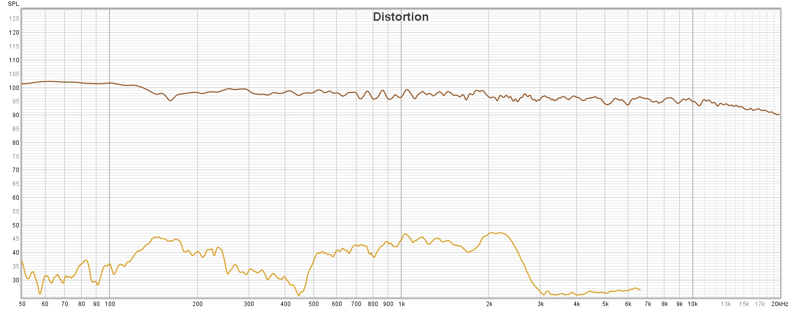

    Da angriper jeg jo anlegget riktig nå. Skal gjøre endringer i rommet som krever mye mindre heving av området 150 til 250 hz - Det vil føre til mye lavere tredje harmonisk i det området. Det som er der nå er jo i meste laget
    Bytter også til mellomtoner som har meget lav tredje harmonisk. Da vil det bli mye lavere i området 500 hz - 2500 Hz. Der også er det mye nå.

    Tviler ikke på at du gjør det riktig. Jeg er fortsatt litt nysgjerrig på hva som skaper opplevd dynamikk, denne «plutseligheten» og snerten som vi sikkert alle kjenner igjen når vi hører den. Du nevnte at kombinasjonen DEQX HDP4 og Hypex UcD400 låt «udynamisk» hos deg. Kom du til bunns i hva som var årsaken, teknisk sett?
    Mellomtonene mine er kjappe PHL 1130 med 16 ohm impedans, 98 dB følsomhet og relativt lav forvrengning dominert av andreordens, så jeg hadde kanskje forventet litt mer «første rad»-opplevelse. Det er med DEQX og Hypex NC400. På den andre siden, JBL 9350’ene mine (15’’+to kompresjonsdrivere med horn pr stk) «packs a sonic punch» ifølge produsenten, og det er nokså tydelig en frekvensgang som både løfter 2-3 dB i bassen og tilter litt oppover i øverste oktav.
    Nei det ble stående som et lite mysterie.

    Ja, det fremstår litt mystisk for meg også, når utgangs- og inngangsimpedansene er som de er i denne kombinasjonen. DEQX har flere forskjellige balanserte utgangstrinn, trafobalansert, elektronisk, kondensatorkoblet - vet du hvilket som var i bruk hos deg?
    Nei det husker jeg ikke

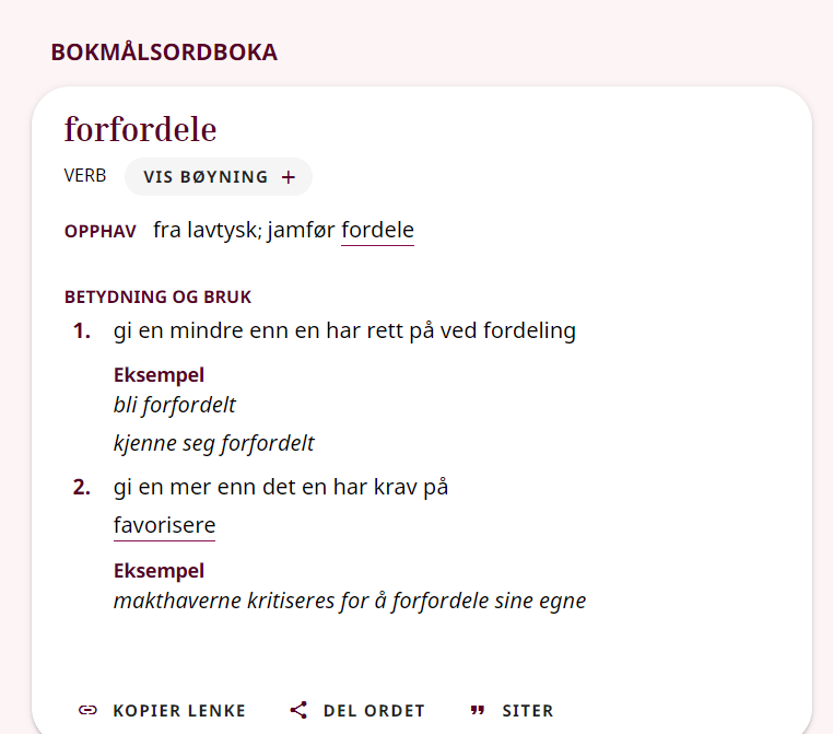

    Merker meg forøvrig at vi har fått to innlegg som linker til samme nettsted der man finner to vidt forskjellige forklaringer på hva mikrodynamikk skal være.
    Vi kan god bruke begrepet, for all del, men gi det da for pokker en definisjon og bli enige.
    Sånn som Bokmålsordboka, som er normert av Språkrådet?
