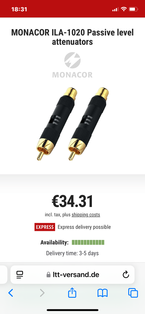

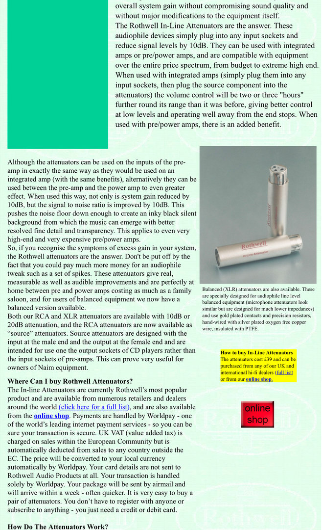

    Jeg sendte lyngdorf spm om dette og fikk dette svaret ekstremt raskt. Imponert over responstiden:
    Thank you for your enquiry.
    The analog output of the TDAI-1120 was originally intended for connection of subwoofer(s), but many users do connect a separate power amp without problems.
    The noise level will depend on the connected power amp input sensitivity and the sensitivity of the speakers. The max output voltage from the 1120 is 4V RMS. Your power amp has a sensitivity of 980mV. This means that the volume control on the 1120 will operate mainly in the low settings - you can not turn up to full volume as you would overload the power amp. If we assume a digital source playing typical modern music, the level will be close to 0dB and the level on the analog output will be close to 4V RMS if you turn up to full volume.
    As most of the noise from the 1120 comes from the analog output stage, the noise will be fully amplified no matter the volume setting, as the volume is adjusted in the digital domain. So the only viable way of damping the noise is to use in line phono attenuators between the 1120 and the power amp. This will damp the signal and the noise, but as there is lots of volume range it just means that you will have to turn up volume higher to achieve the same SPL. This also means that you will have a higher level through the DA converter which theoretically gives a higher dynamic range and better resolution.
    I hope this answers your questions.
    Beretta67
    16.09.2024
    399
    754
    Det fungerte👍 rca attenuator virket ikke men de i xlr. Takk for tips og lån av attenuators av hornlyd😁

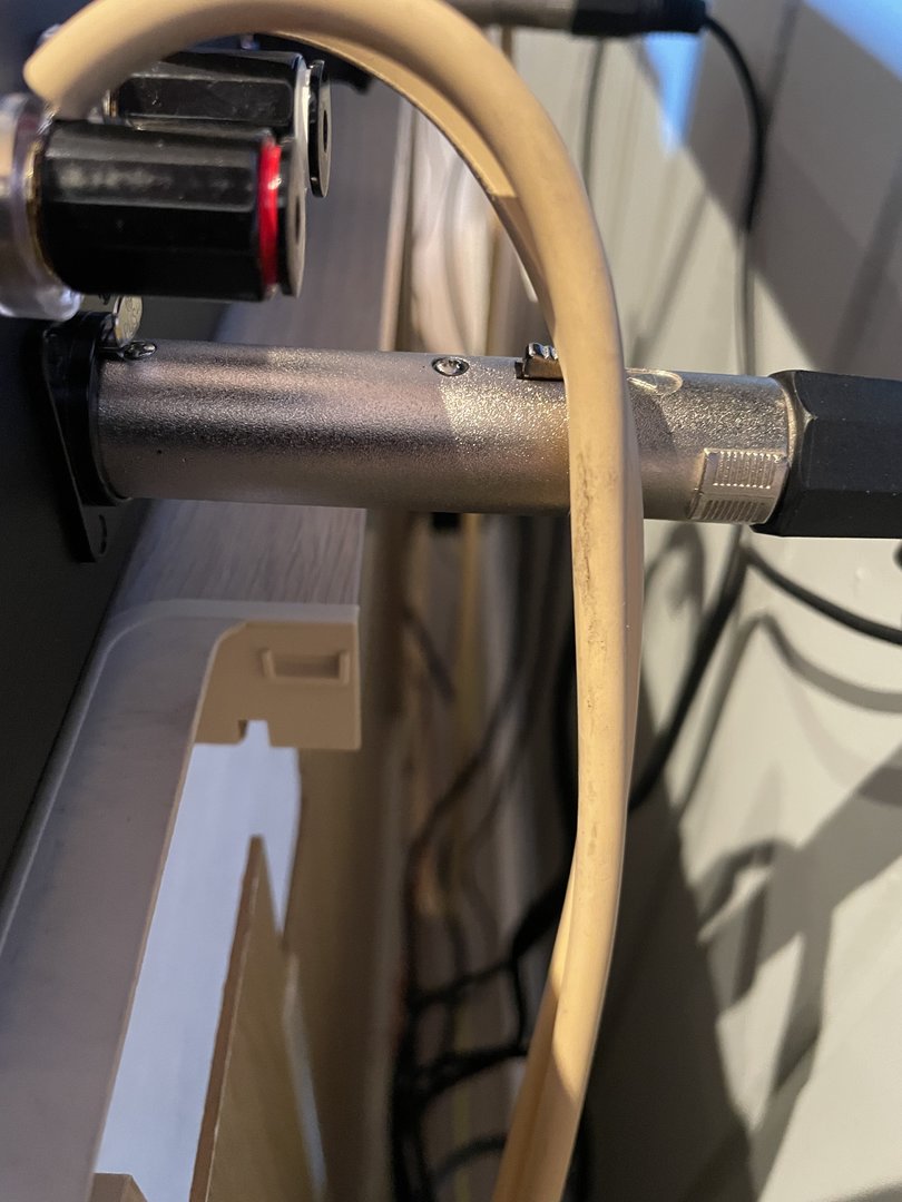

    Ble MYE bedre. Må legge øret inni bassen for å høre SVAK sus. Xlr dempeledd inn i xlr ice power og xlr/rca imellom den og Lyngdorf.
    fry
    23.10.2012
    919
    682
    Høres bra ut! Og billigere enn å bytte lyngdorfen, da er dette høyaktuelt mtp en aktiv to-veis i stedet for å begynne med minidsp.. Ser litt skummelt ut mtp vektstangprinsippet på inngangen, men en kort xlr-kabel bør ordne det greit evt.
    Beretta67
    16.09.2024
    399
    754
    Ja, skal lage noe kabel stæsj så det blir bra/ser penere ut osv👌 Ble litt sånn i hui og hast for å teste. Blir ikke noe annet her enn Lyngdorf på dette oppsettet mitt nå. Fungerer knall. Kjempe bonus og finne ut og få fikset susing også.
