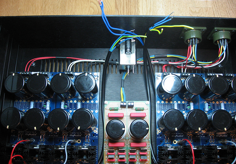

    First of all: Nice amps you are building :) . You are a very good Diy'er , I surely like your workmanship. Keep it up !
    Hi Johnny,
    One question :)
    You said you Toroidy a transformer of 3000VA.
    You tried to put him in charge?
    I have used in the new project 2500 VA transformers from Toroidy.
    At a bias of 3.6 A had a very strong mechanical noise.
    I tried DC filter, snuber, CRCCC, CLCC, NTC60 - no good result.
    I tried last resort - I opened external winding and we put both in resin. To my 90% of noise disappeared.
    It became quiet after I added in series with the primary winding 2xNTC60 (10R+10R).
    Every time I listen ... I'm amazed how this amplifier may sound good :)
    Much better than the first version (with transformer 1500 VA)
    Thank you:)
    I think you have misunderstood. The 3000VA transformer is not for the Pass, is it for the Borbely Millennium poweramp, which I am also building.
    What I am going to use in the Pass clones, I have not decided yet.
    I have not tested the 3000VA under heavy load yet, but I am going to put it in a metal can and fill it with resin, like you did. (Just to be on the safe side, and it with will also look better with a polished metal can like the ones in my preamp.)
    Like I said in a e-mail to you, the ones you have built have not the right amount of output-fets. You have the "light" Chinese version with 12 pairs pr. side. The right number is 18 pairs pr. side ! You also have a passive CCS (resistors), witch was only used in XA160.5 Mk.1
    From Mk.2 and later models like XA160.8 there is an active CCS. We are building a Mk.2 version with active CCS and 18 pairs output-fets pr. side.
    We have now all the information that we need. It is now up to my partner to get his finger out, and redesign some pcb's :p. Hint, hint ;)
    Anyway, I'm so happy that you are pleased with the sound of your new amplifiers :) . Fantastic good DIY !
    All the best,
    your friend Johnny

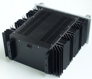

    er på bukta å kikker litt......fortsatt noen "snasne" kabinetter å få tak i. For de som bygger Kl.A forsterkere, så er disse ganske fine. Ikke like store som mine Pass klone-kabinetter men ca. 3/4 size av disse. Men de koster: 4920,- + 1148,- i frakt + toll/mva. pr. stk. Til sammenligning så kostet mine Pass "full size" klone kabinetter ca. 7500,- pr. stk. all inclusive.
    Vel her er det:
    Frontpanel: 20mmthick(aluminum)
    PanelHandle: 25mmthick(aluminum)
    Rear panel: 4mmthick(aluminum)
    Upper and lower plate: 4MMthick(aluminum)
    Machine feet:aluminummachine feet.
    Switch: 250V15A larger switch
    Radiator: 150mm * 75mm * 200mm industry shaped fins,each pieceweighs about2.2KG,a total of six
    package weight about 30kg/set
    Note: the chassis will send in Bulk. buyer need to assemble it by yourself.
    Pent, synes nå jeg ......

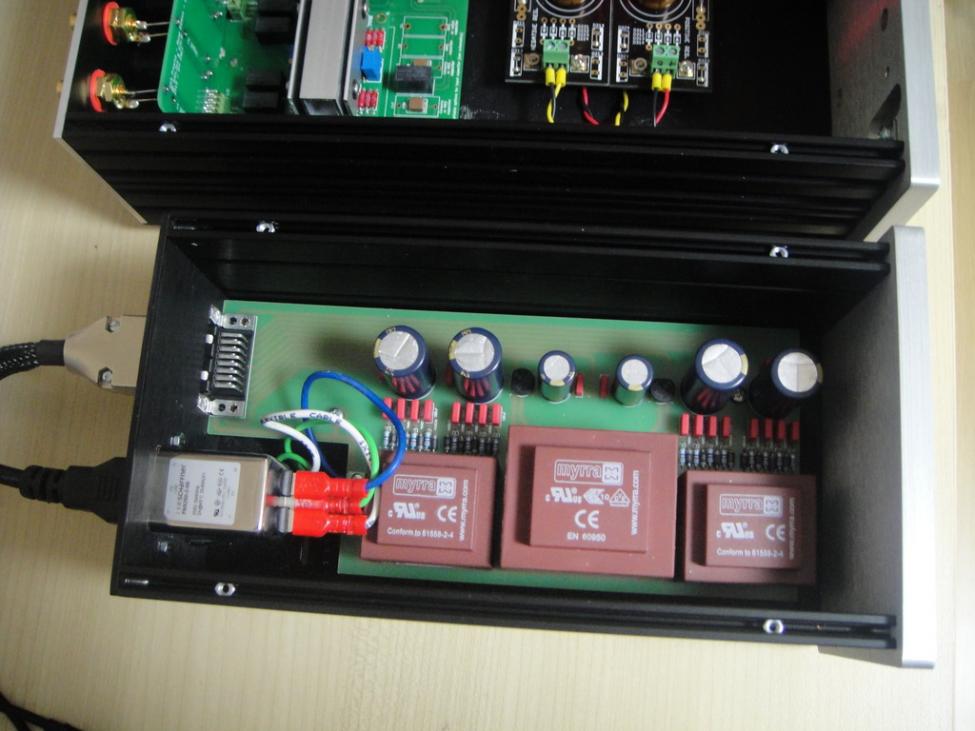

    Power supply ferdig.
    Hei :)
    Da var Power Supply ferdig til denne pre-ampen :). Fikk eksperimentert med for-motstand til led, havnet på 100Kohm. Da ble lyset passe dempet og ikke sjenerende. Alle spenninger er o.k, og pen oppstart-tid, ble ca. slik Armand hadde beregnet (ca. 4-5 sek.). Kjører nå med en 5A fin sikring (da jeg ikke hadde annet liggende). Tror det skal gå bra med en 3.15A treg, så jeg trenger ikke noen varistor.
    Vel slik ble den (dårlig kamera som vanlig), bedre bilder kommer når alt er ferdig :
    Er fornøyd med resultatet :)

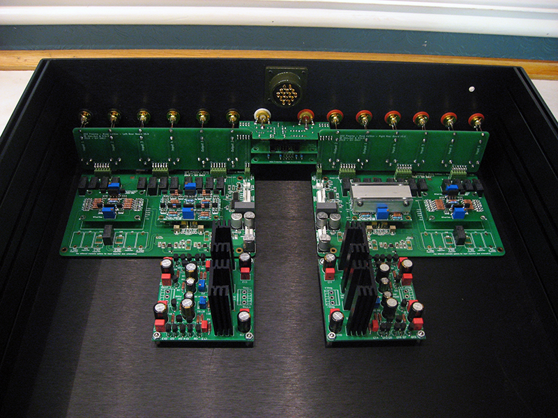

    Da ha jeg så vidt begynt på selve pre-ampen, driver med layout. Blir ca. slik plassering av dual 24V regulatorene. Og så kommer det et lite kort til med fast 5V og 6v regulator. Plasserer dette i den åpne spalten lengst bak. Regulatorene blir boltet fast til bunnplaten for kjøling. 5V er til reledelen, 6V er til kontroller/display- kortet i fronten.
    Må få lånt meg en spesial-tang til molex-kontaktene. Finnes heldigvis å få lånt på jobben :).
    Mvh.
    Slowhand Johnny

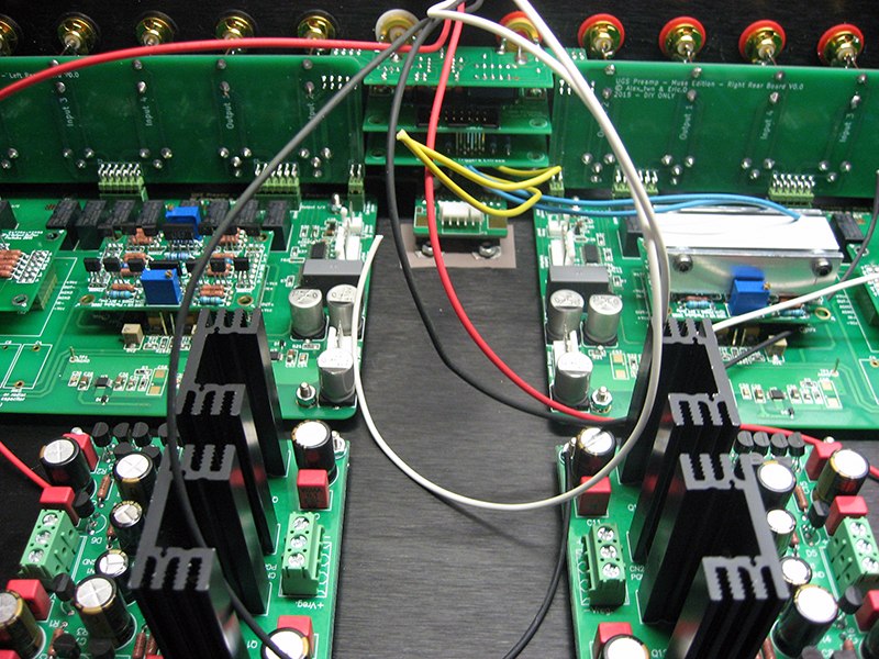

    Da var boring og gjenging unnagjort :). Ikke det morsomste jeg vet, tar tid...... Vel, nå er kortene montert, og jeg har begynt med kablingen. 5V og 6V regulatorene er montert mot bunnplaten for kjøling. Kortet med regulatorene ble kortet litt ned på sidene, da jeg kjører med separate regulatorer for 2x24V.
    Har også montert en blindplate som kommer bak kontrollerkortet for å isolere mellom den digitale delen og den analoge delen. Kommer til å lakkere denne matt sort. Kveldens dont:
    Får se om jeg har tid og ork til å kable videre i morgen ?

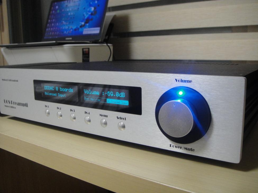

    Det bygges noen få UGS muse preamps :) . Her er et eksempel fra en italiener , bosatt i Sør Korea. Veldig pent, synes nå jeg . Her er det brukt standard størrelse på kabinett og standard strømforsyning. Frontplaten til selve pre-ampen har han designet selv, kudos ! :).
    Han har dessverre byttet om på UGS modulene og buffer modulene, dette kan ikke låte bra, har han rukket å hørt på den ? Har påpekt det på det franske forumet. Ser at han har brukt Salas shuntregulatorer, som burde være bra. Morsomt å se andre holde på med denne konstruksjonen, vi er nemlig ikke så mange !
    Her er bildene fra hans bygg:
