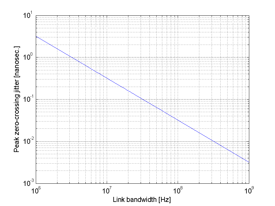

ar-t skrev:
Mr. Dan is a respected designer, but I do not agree. Likewise, there is a very highly regarded (audio) transformer guy that maintains that 15 MHz is enough BW for SPDIF. Nope, don't agree with him either. (We use his audio transformers, though!) So, just as in politics, well educated and knowledgeable people can have strong disagreements.
Hopefully you agree that transformers is a good thing! Too many producers omit the transformer to save half a buck when using electrical SPdif transmission.
As far as bandwidth goes, I don't see any reason to be in disagreement on something that's easily calculable. Assuming the bandwidth limitation is governed by a dominant pole* it can be approximated as an RC time constant, and then as shown in Hawksford's paper (AES Conv.Paper 3360) it's easy to calculate the introduced jitter as a function of code transitions. The peak jitter appears in the zero crossing and will be:
Jpp=RC/2*((1+e-tc/(2RC))/(1+e-tc/(RC)))
RC being the time constant and tc being the transmission interval. For 44.1kHz fs SPdif tc=1/5.6MHz and you'll get the zero crossing peak jitter as a function of bandwith like shown in the figure below. Of course the "average" jitter (if we can talk of any such since this is definitely not a stationary process) will be quite a bit lower.
So the issue of contention, if any, must be in relation to the jitter audibility. Since Spdif jitter from bandwidth limitation will be signal-correlated jitter of low-frequency the audibility is probably somewhat greater than that of random phase-noise (which is quite limited as shown in this paper), but still... in my judgment 15MHz would suffice. Anyway the main point is that bandwidth requirements from a jitter point of view aren't really shrouded in mystery in an engineering perspective, it's basic maths as a function of whatever jitter audibility threshold you claim.
If you ask me using Toslink or optical transmission is - to recite George Tenet's infamous phrase - a slam-dunk case. Undocumented claims of optical transmission being inferior are mute as far as I'm concerned. ADAT transfers something like eight channels of 32/192 over a single fiber optic line. The FLAG internet lines connects millions of users across the globe. Noise immunity means phase noise immunity too, and ground loops are broken without transformers, characteristic impedance is not an issue..the advantages are too many to ignore. People may be still concerned about electric-to-optical conversion, but that's just conservatism, it's infallible. Besides in the future integrated circuits and processors will probably have optical transmission internally as well, with quantum logic operating on photons rather than electrons.
On a final note; as you may know Scientific Conversion - producers of transformers for SPdif - have three AES papers available at their website where they present transformer jitter histograms and such and such.
* I think it's reasonable to assume the transformer and cable have dominant poles, if these are close together the system will be of higher order, but the net result is never worse than if adding the time constants of the respective components so evaluating one by one will in this regard be a worse than worst-case scenario.
