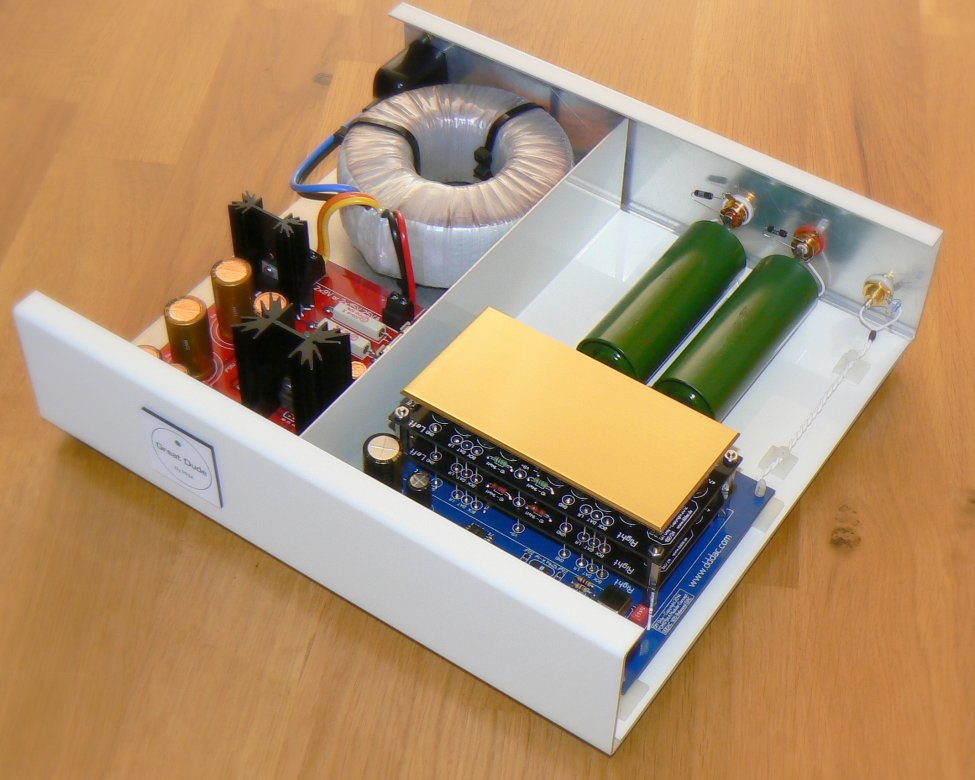

    De der grønne kondensatorer i jern ville jeg aldrig brugt.
    Det var faktisk de jeg falt mest til ro med før jeg fikk transformator på utgangen. Det er aluminium folie med papir/polyester/olje. Mangle nok den luftige toppen til f.eks Mundorf SGO/SIO, men hvis man trenger fylde og naturlighet er de fine synes jeg.
    Det er jernet som giver "fylde"på grund af magnetismen.

    Hello,
    if you can't stand Russian Pio capacitors ( green cans ) you can swap them for my dedicated Pfm designed buffer.
    Regards from France
    SGG
    Hi SGG and congrats with a nice, clean looking dac. Please accept my apologies on behalf of our Danish forum friends. They don`t like anything if it is not silver wrapped in cotton that is drainched in secret snake oil and preferably based on theories by some self proclaimed Messiah.
    What is the price with the Russian Military spec PIO capacitors?
    -BB-
    SuperGégé
    Fersking
    19.08.2019
    Hello,
    Regards from France
    SGG
    -BB-
    Dear Sir,
    K75-10 RussiAN PIO capacitor are, really, inexpensive...
    You will find them on EBAY.com for less than 10 usd a pair ( 2.2µf / 250v )... Please add 10 for shipment...
    I like these so much as they sound relaxed without any compromission in detail. Highs are soft but precise. Mids are gorgeous... ( IMHO )
    Please note : these capacitors are king size !!!!
    Best regards from France
    SGG
