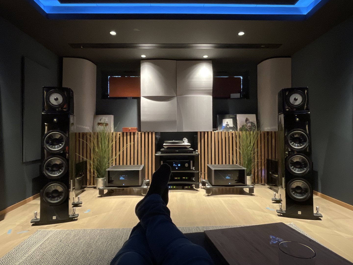

    Fint lytterom du har,de REL subbene er jo sĂ„ flotte(ikke alle som har flotte bass systemer her inne)😉.
    SÄnn rent estetisk er vel dette et av de fineste rommene her pÄ HFS.
    Takk, det var jo hyggelig Ă„ hĂžre😀 En kan si hva en vil om REL, men er det sĂ„ mye annet i 12” som er bedre? Mye mere diskre enn voldtekt bass systemet til @MakkinToskenđŸ€“

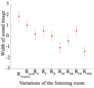

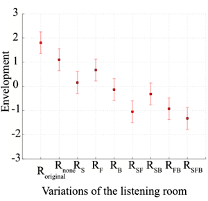

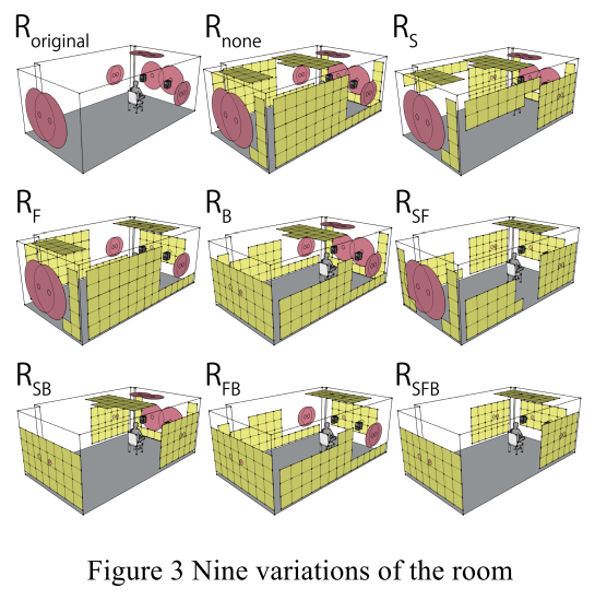

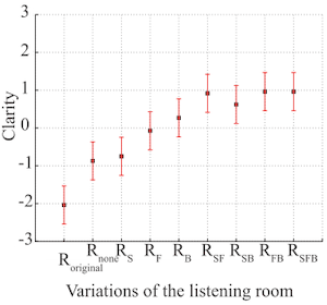

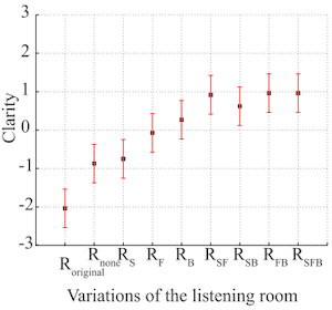

    Det ble gjort et fint studie av forskjellige dempingsomrÄder her; https://www.aes.org/e-lib/browse.cfm?elib=16683
    Markert med rÞde sirkler er fÞrsterefleksjonspunktene, gult er dempede omrÄder.
    What are the results?
    Among the seven attributes “Timbre brightness”, “Timbre naturalness”, “Reverb suitability” and “Listening preference” did not show significant differences between almost all pairs of the variations of the listening room.
    Because three other attributes “Width of sound image”, “Envelopment”, and “Clarity” showed significant differences among the nine variations of listening room treatments, the following discussions are done for the three attributes.
    ‱ Absorption of the First Reflections Area on the side walls: “Width of sound image” will be narrower and “Envelopment” will be lower.
    ‱ Absorption of the First Reflections Area on the front wall and the ceiling: “Width of sound image” will be narrower and “Clarity” will increase.
    ‱ Absorption of the First Reflections Area on the back wall: “Width of sound image” will be narrower, “Envelopment” will be lower, and “Clarity” increases.
    ‱ Regardless of the absorption of the First Reflection Area, listening impression will change according to absorption of the other areas.
    Ser ut som litt prioritering mÄ til i forhold til hva man Þnsker Ä oppnÄ.

    Hvorfor vil du at alt pÄ frontvegg skal reflektere?
    Vis vedlegget 763428
    Vis vedlegget 763430 Vis vedlegget 763431 Vis vedlegget 763432
    Dette er stjÄlet fra en fin trÄd pÄ ASR; https://www.audiosciencereview.com/...lections-isnt-there-a-price-to-be-paid.16687/

    ...og i alle ni varianter sitter en stakkar pÄ en pinnestol og stirrer tomt inn i veggen.
    Jeg fant det jo noe overraskende at demping pÄ forskjellige steder ikke spilte noen stor rolle pÄ opplevd klangbalanse, men hovedsaklig bare pÄvirket stÞrrelse av lydbildet og klarhet.
    Men hvor relevant den type plassering er for mÄten de fleste av oss bruker et rom er jo en annen sak. Ser ut som det var hÞy grad av direktelyd uansett hvordan rommet ble dempet.
