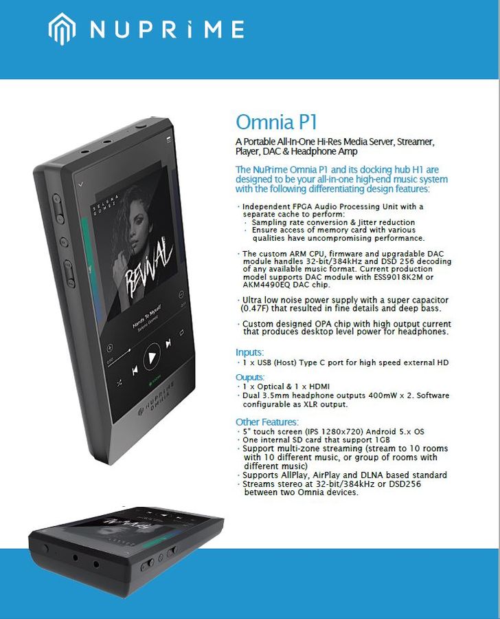

    Nuprime Omnia med docking som trolig er klar til salg i Mai/Juni. Det er ferdigstillelse av software det står på.
    Omnia SP1 - a single platform that does everything, supporting up to 32-bit/384kHz and DSD256 decoding including streaming (depending on receiving devices). Incredible desktop level power for 400mW x 2 headphone amp. High-end upgradable DAC daughter board!
    • play or re-stream music from any online streaming services
    • play or stream music from local media files
    • play or stream music from network media files
    • connect by WiFi or ethernet cable
    • connect to two USB 3.0 hard disks for terabytes of storage
    • display port for connecting to monitor screen
    • optical and USB output for connecting to external DAC (but what for when it has a high end upgradable DAC inside)
