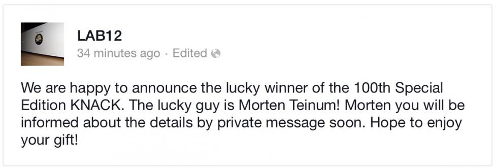

    LAB 12 Handcrafted High-End Audio KNACK AC Power Cable Special Edition Serial No. 3110100 For Morten Teinum
