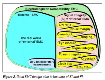

    Om man går litt bak Wikipedia som kilde, [...]
    LearnEMC Tutorial: Introduction to EMC
    http://xfel.desy.de/localfsExplorer...mc/Basics/Fritz_Szoncso_EMC_course_080115.pdf
    eEngineer -- Introduction
    Poenget er bare at du bruker begrepet "EMC" om noe annet enn hva det betyr. De effektene du beskriver ligger innenfor hva vi andre kaller "induktans".
    Det kan også være lurt å gjøre noen overslagsberegninger fra tid til annen og se om de effektene som beskrives sannsynligvis har større eller mindre hørbar virkning enn f eks én grad temperaturendring i lytterommet.

    Men for å analysere de tingene på høyre side, dvs signalintegritet, så er det nok en gang våre venner R, L og C som må trå til. Et par linker om det temaet også:
    http://en.wikipedia.org/wiki/Signal_integrity
    http://www.altera.com/technology/signal/fundamentals/basics/sgl-basics.html
    http://www.cadence.com/rl/Resources/articles/Signal Integrity.pdf
    Typical circuit simulators, such as different flavors of SPICE, employ nodal analysis and solve voltages and currents in lumped circuit elements like resistors, capacitors and inductors. In SI analysis, an interconnect sometimes will be modeled as a lumped circuit element. For instance, a piece of trace on the printed circuit board can be simply modeled as a resistor for its finite conductivity. With this lumped circuit model, the voltages along both ends of the trace are assumed to change instantaneously and the travel time for the signal to propagate between the two ends is neglected. However, if the signal propagation time along the trace has to be considered, a distributed circuit model, such as a cascaded RL-C network, will be adopted to model the trace. To determine whether the distributed circuit model is necessary, the rule of thumb is – if the signal rise time is comparable to the round-trip propagation time, you need to consider using the distributed circuit model.

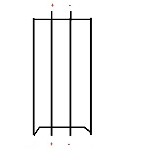

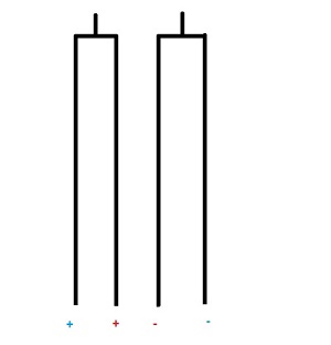

    Interesant forslag, men da må jeg ødelegge den dyre Nordostkabelen min. Den er allerede ferdigkoplet i en ende. Slik:
    Men jeg er ikke helt sikker på hva som menes. Jeg ser at det ville induseres strøm i en slik loop, men mindre og mindre ettersom proximity setter inn ved økende frekvens.
    Var det slik du mente?
    Vis vedlegget 195117
    Vis vedlegget 195133
    Noe sånt ja. La det ene ledningsparet være en kortsluttet loop, men uten elektrisk kontakt med det andre paret som brukes.

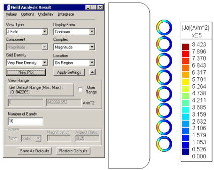

    Ved ikke om dette link har været vist , Fokus er desværre på en oprullet ledning spole/trafo hvor de effekter vi taler vil blive langt mere udtalt.
    Power Tip 26: Current distribution in high-frequency conductors
    Her på video:
    http://focus.ti.com/general/docs/video/Portal.tsp?lang=en&entryid=0_85eflg58
    Flott video som også viser hvordan virvelstrømmer virker inn i en enkelt leder. Men her var fokus på tapene, og jeg kan ikke tenke meg at noen synes at det er særlig relevant i en høyttalerkabel. Men uansett viser videoen det magnetiske fenomenet på en fin måte. Om man lager seg en modell for å regne på frekvenser i audioområdet, så må den modellen kunne vise dette som ble vist, ved høyere frekvenser.

    Mitt utgangspunkt er at jeg viste at, om all strøm går i innerste enkeltleder, så utgjør dette den minste impedansen. Da er loopen bare gitt av to enkeltledere som ligger svært nær hverandre (de andre lederne fører ikke strøm på grunn av virvelstrømmer og felter som disse setter opp). Dette er altså tilstanden som modellen må kunne beregne ved tilstrekkelig høy frekvens. At så dette blir ende mer utpreget ved enda høyere frekvenser har jeg aldri tatt opp som ett relevant tema. Men det oppstår jo til slutt skinn effekt også i de innerste lederne. Men det blir jo som det epleeksemplet ditt...irrelevant.
    Din modell er bare en svært nøyaktig modell av induktans, uten å ta hensyn til minste impedans. Deri ligger forskjellen.
    Minste impedans forklarer etter min mening, proximity og skinneffekten og hvorfor virvelstrømmene som fører til disse effektene oppstår.
    Edit: Motoren som driver dette er forskjellen i avstand i hele kretsen, fra innerste ledere som ligger svært når retur, til ytterste som ligger flere størrelses ordner unna dette. At så virvelstrømmene vil gå i sløyfer inni en tynn leder er evig nok mekanisme ifølge energibetraktninger vist tidligere (induktansen vil ikke endret vesentlig av dette).
    Mitt problem med dette er at ditt begrep "minste impedans" er vrient å få tak på. Jeg har regnet ut i ganske stor detalj hva impedansen for hver enkelt leder blir, og hvordan strømmen vil fordele seg mellom lederne ut fra hvilken impedans hver av dem har. Det blir ikke slik som du hevder. Ved audiofrekvenser vil hele tverrsnittet på alle ledere fortsatt lede strøm, og strømmen presses tildels utover i kabelen samtidig som den dras innover, nettopp fordi det er den fordelingen som gir minst impedans. For isolerte ledere ved så lave frekvenser at vi kan se bort fra skinn- og proximity-effekter er det bare resistans og induktans som driver strømfordelingen. Ved de frekvensene er nok den største feilen i modellen at jeg har utelatt kapasitans, som også vil påvirke impedansen for hver enkelt leder.
    Hvis det fortsatt ikke passer med din intuitive oppfatning av hvordan ting burde være, så foreslår jeg at du lager din egen modell i tilstrekkelig stor detalj til å bli overbevist om hva som egentlig skjer. Det blir bare rot av å blande sammen tre-fase kraftkabler, spoler ved mange megahertz, og alt mulig annet. Vi må se på hva som faktisk skjer i de kretsene vi forsøker å forstå.

    ... For isolerte ledere ved så lave frekvenser at vi kan se bort fra skinn- og proximity-effekter ....
    Men man kan ikke se bort fra proximityeffekter ved frekvenser over 1 kHz i disse konfigurasjonene som vi prater om i denne tråden. Man må se på hele ledergruppen og ikke radius på hver enkelt leder.
    ...Det blir bare rot av å blande sammen tre-fase kraftkabler....
    Det var ett glimrende eksempel som er direkte relevant for flere kabelkonfigurasjoner som nevnt i noen innlegg rett ovenfor her, inkl flatkabel (min mening)
    Min "minste impedans" er mindre en din "minste impedans"...hehe. Og hvordan forklarer man egentlig skinn- og proximityeffekten uten "minste impedans"?
