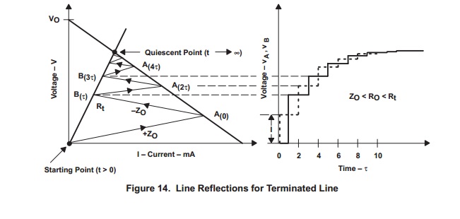

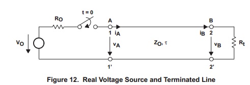

    Joda, jeg leser linkene dine. Gjør du? Her et sitat fra den første:
    Similarly, in the world of high-speed digital design, a pcb trace of any length always remains a transmission line. It supports two modes of propagation, going out to the load and back. When the line is short, these two modes of propagation still exist, only their temporal superposition creates the illusion of a direct connection between source and load.
    • A pcb trace of any length always remains a transmission line, supportig two modes of propagation (out and back).
    • When a transmission line is short, two modes of propagation still exist, only their temporal superposition creates the illusion of a direct connection between source and load.
    Kan vi nå holde oss til disse microsekundene når Z0 betyr noe for alle frekvenser eller? Dette blir bare dumt.
    40.737
    44.547
    Vi leser nok de linkene litt forskjellig, tror jeg. For enkelhets skyld uthevet jeg noen ord i det du siterte. Det er ikke mye som er "high-speed digital design" med en høyttalerkabel, for å si det slik. Du kan jo tenke litt over disse tre punktene:
    • Any transmission line can be shortened to the point where it acts as a perfect connection.
    • If the source can’t drive the load in the first place, then hooking the source and load together with a transmission line isn’t likely to make things better.
    • Conditions necessary such that a short, lumped-element transmission line not affect signal quality are given by [3.39] through [3.41].
    Litt mer her:
    Transmission lines short enough to operate in the lumped-element region rarely require termination except in unusual situations involving very low-impedance drivers coupled either through exorbitant amounts of packaging inductance or connected through transmission lines to heavily reactive loads.
    • A transmission line can always be shortened to a length below which it operates in the lumped-element region.
    • Transmission lines short enough to operate in the lumped-element region rarely require termination.
    ...og for audiofrekvenser er "kort" en kilometer eller deromkring. Johnson bruker begrepet "transmission line" om all kabling som overfører et signal, mens det jeg har kalt "transmisjonslinjeeffekter" tidligere ville vel han kalt "leaving the Lumped-Element Performance Region".
    Som nevnt tidligere tror jeg at jeg forstår hva du mener, men det vil i høyden manifestere seg som frekvensavhengige avvik i gruppeforsinkelse i størrelsesorden 10 us. Det er ikke en snøballs sjans for at det blir hørbart, og du har ikke beskrevet noen som helst mekanisme som enten kan skape ulike faseforvrengninger i hvert av lytterens to ører i størrelseorden 2 us, eller kan skape avvik i frekvensgangen i størrelsesorden 1-2 dB slik at dette blir hørbart med bare ett øre. Det er et ganske stort logisk sprang i midten av resonnementet ditt.
    Og det er hvis vi aksepterer hele den første delen av resonnementet om refleksjoner og stigetider, vel og merke.
    Litt mer her:

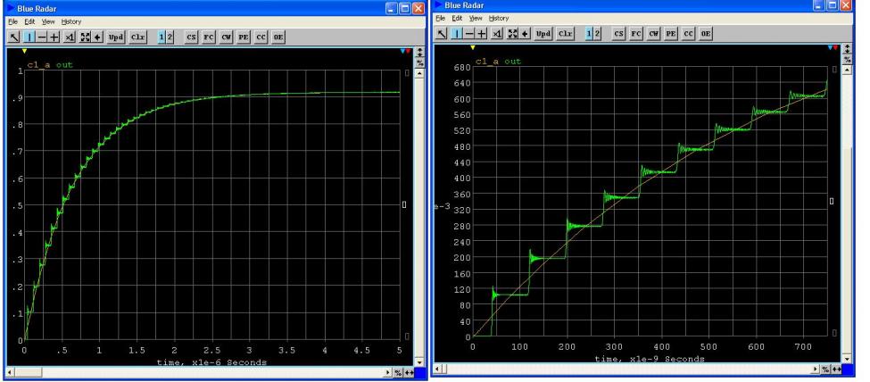

    Siden noen gjør ett stort poeng ut av at t-linjer må være flere kilometer, og at korte kabler må beskrives som RCL (lumped element) så henter jeg atter frem simkurven:
    Den gule heltrukne kurven er RCL modellen. Den grønne kurven følger den gule, men her ser man trinnene etter de ulike refleksjonsperiodene. Begge viser det samme forløpet med en oppbygging av strømmen over noen microsekunder. Men det er bare t-linjemodellen som viser årsaken, og hva som kan gjøres om man ønsker å påvirke dette forholdet.
    Simuleringen får i begge tilfeller ikke frem hva som skjer når lasten eller kabelen er frekvensavhengig.
    Hva man mener om hørbarheten av dette er en annen sak. Men vi bryr oss vell?
    Korte linjer ved lave frekvenser ikke modelleres som LCR, men de kan, og den modellen vil gi samme resultat som en mer detaljert transmisjonslinjemodell. Forskjellene i din simulering ligger ved frekvenser langt over audiobåndet.
    Vis vedlegget 302034
    Garbage In = Generatorns stigtid är IDIOTISKT låg, 10 ns. Finns ALDRIG som utsignal från audio-förstärkare.
    Garbage Out = Reflexerna består ENBART av frevenser som kommer av 10 ns stigtid.
    Simuleringsprogrammen använder helt perfekta komponenter, kondensatorer helt utan R och L t.ex.
    Vill man simulera verkligheten måste man själv lägga till dessa parasit-element för varje komponent.
    Förluster från verkliga komponenter saknas och därför fortsätter reflexerna från den orealistiska
    insignalen i all oändlighet. Händer inte i verkligheten.
    Bilden från simuleringen är just bara en bild. Inget som helst bevis för vad som sker i verkligheten.
    Lägg märke till hur "hedde" aldrig har redovisat hela schemat för simuleringen och vilka insignaler
    som används. Anledningen är att där visas det orealistiska i all tydlighet. "Kungens nya kläder" skulle
    avslöjas. Bevisvärdet är en stor fet nolla. Att visa en bild och påstå att "Så här är det - det visas av bilden"
    är äkta pseudo-vetenskap, detta bevisas också av hur bilden utan annan nödvändig information används
    som "bevis".
    som "bevis".
    Wikipedia-artiklar och vetenskapliga rapporter granskas oupphörligt genom peer-reviews för att säkerställa att
    de inte innehåller DIY-laws-of-physics. Wikipedia kan vem som helst föreslå ändringar och tillägg till. Om de
    klarar en peer-review blir de kvar, annars tas de bort. Kanske vi snart får se ett tillägg till transmission-line-sidan
    "These models are valid globally with an exception for speaker-cables in parts of Norway and Denmark where
    other rules apply."
    Simuleringen visar i ringningarna en signal som ligger mycket nära radiobandet för kommunikation flyg-mark
    och skulle om den var verklig störa ut allt på det radiobandet. Kablar är också bra antenner.
    Med samma önskan och metod att vilja bevisa något med felaktiga simuleringar skulle man kunna visa hur tidvatten-effekten
    ger stora vågor i en swimming-pool. Det är bara att öka rotationshastigheten för jorden och månen med 1000 ggr.
    Det är precis det som görs när man använder < 10 ns i stället för > 10 µs för att få fram den effekt som inte syns annars.
    Nå må du slutte med dette "pseudo-vitenskap" babblet ditt. Grunnleggende t-linje teori lærer man godt nok på ett gjennomsnitts masterstudie og er rimelig greit dokumentert i lærebøker. Det er kun når man har missforstått at dette fremstår som noe nytt, som kongens nye klær. Skaff deg en lærebok, så blir denne diskusjonen bedre. Men jeg skal da hjelpe deg (og andre) litt på vei:
    Kilde: http://www.ti.com/lit/an/sdya014/sdya014.pdf
    In transient phenomena on lines with defined characteristic impedances, it is simple to show the response of current and voltageas a function of time, at the beginning and end of a circuit line, in graphic form. This method is particularly suitable for thenonlinear line terminations used in digital engineering.
    Her er til og med tapene som du etterlyste tatt med. Vi ser at dette altså selvsagt er kliss likt med hva jeg har redegjort for hele veien. Ingenting som jeg har "funnet på " dette skjønner du.
    som "bevis".
    other rules apply."
    Vis vedlegget 302058
    Vis vedlegget 302059

    Dette er såklart riktig; det er lett å måle, simulere eller regne seg frem til hva, om noe, en kabel gjør med audiosignalet, men det er ingen som kan bestemme på vegne av andre om dette "noe" er til det bedre eller verre, det er subjektivt. Men når dette "noe" er 100dB under enhver etablert hørbarhetsterskel er det likefullt grunn til å se på andre forklaringsmuligheter enn de rent fysiske, altså ting som skjer mellom ørene til det observerende mennesket.
    Hvorfor er ikke det som skjer mellom ørene på mennesker "fysisk"?
    JMK
    Dalahäst
    13.01.2015
    108
    52
    Derfor viste jeg til scopebildet tidligere i tråden, som viser at en vanlig audiosinus på 10 khz også blir reflektert..
    Nej, den bilden visar fasläget på två steady-state signaler i ett RCL-nät.
    10 kHz har fortfarande den elektriska våglängden 25 km. Allt inom några meter sker samtidigt.
    Att mäta reflekterad effekt görs inte med 0,1 Ohm i ena ledningen, det visar ALL ström i den punkten
    (om inte ni har intelligenta motstånd som skiljer på strömriktningarna).
    Tau är några nanosekunder (3 ns per meter) så det vore väldig bra om du kom ner i
    frekvens till audioområdet. Det är det diskussionen handlar om.
    .. och tänk på stigtider, rimligt frekvensband och tidsaxel...

    Bateman sier selv om dette:
    Cable Reflections.
    At much lower frequencies reflections do still occur with mismatched terminations, but produce less dramatic impedance changes. Reflections at 10kHz using the Supra cable driving the ESP_replica load are easily measured using a reflection bridge, the basic tool of all RF measurements. The figure shows some 40% of the incident signal has been reflected, equivalent to a VSWR of 2.2:1 and returned out of phase to the source. For this measurement I used my 50W HP8721A reflection bridges.
    Og noe mer jeg fant om saken:
    An interesting and often underemphasized fact is that the amount of reflection is independent of frequency and occurs at all frequencies when the materials have an approximately constant permittivity over the frequency range. This seems contrary to the common belief that reflectionsare a high frequency phenomena. It is not that reflections do not happen at low frequencies.Reflections are just not typically noticed at low frequency.
    In Summary
    - A signal traveling along a transmission line has voltage and current wavesrelated by the characteristic impedance of the line.
    - Signal reflections occur at impedance boundaries
    - As it travels down the line, a signal has delay associated with itThese three rules combine to produce transmission line effects.
    Kilde: http://ieeeb.okstate.edu/lecturenotes/EET-4654 Microwaves/Lecture 13 The Transmission Line.pdf

    Er det noen som bestrider at refleksene forekommer? Spørsmålet er om de merkes, og dessuten etterlyses det mer realistiske simuleringer. For min del kunne jeg tenke meg at du også gjorde det i en bølgeform, ikke bare en overgang mellom av og på.
