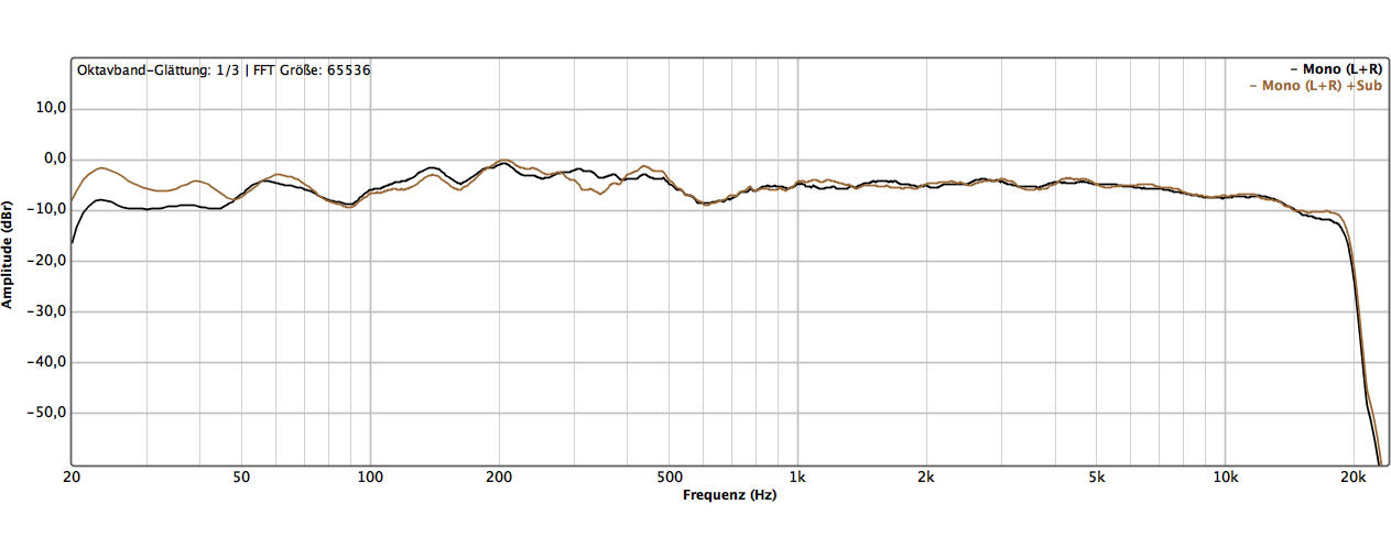

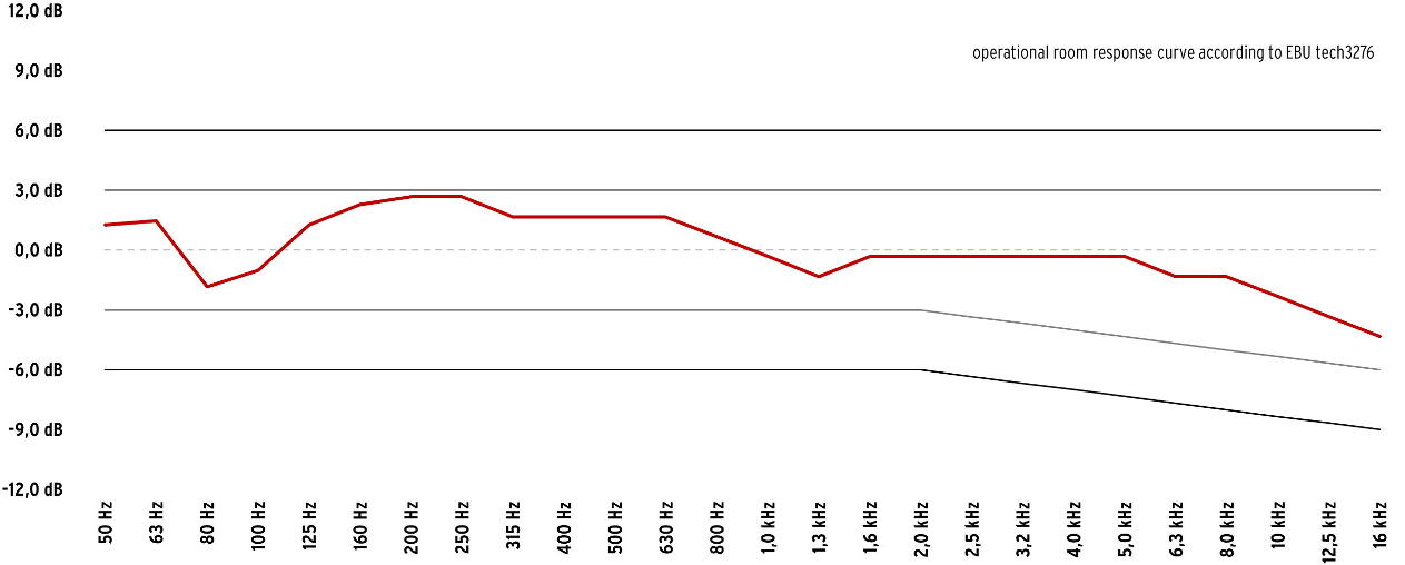

    Her er et tysk firma som driver med måling og forbedring av kontrollrom.
    Et par grafer de viser som eksempel på innenfor EBU-standarden. Disse to grafene ser VELDIG kjente ut.. :)
    Vis vedlegget 933600
    Vis vedlegget 933601

    "In professional monitoring, with the loudspeakers and the listener at standard positions, there is but one reasonable requirement of the reference frequency response: it must be perceived-flat. It’s important to understand that the listening level will affect the perceived response, and the room, listening distance and placement will also be of influence."

    EBU: «Lm is the mean value of the levels of the 1/3–octave bands with centre frequencies from 200 Hz to 4 kHz».
