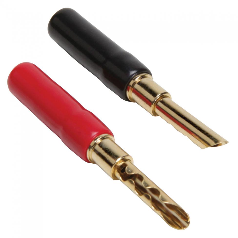

Har noen andre billige alternativer:
Monoprice:
Vis vedlegget 277486
5 PAIRS Of High-Quality Gold Plated Speaker Banana Plugs, Closed Screw Type - Monoprice.com

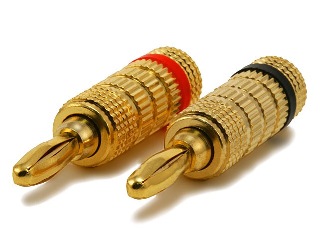

Parts express:
Vis vedlegget 277487
Gold Plated Screw Type Banana Plugs 14-8 AWG 16 Pcs.
Umiddelbart virker kanskje den siste best?
