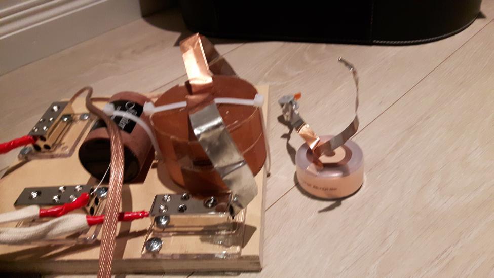

    He he, ja de er svære og tunge som fy!
    Det er Jantzen 8awg bakte folie spoler, 8awg er vel noe sånt som 8,35mm2. De har ihvertfall en serieresistans på latterlige 0,04ohm.

    Nå måtte jeg bare prøve. Satt inn Mundorf 16awg spolene i stedet. De har en serieresistans på 0,21 ohm. Det forsvant overraskende mye trøkk, så spolene gjør tydeligvis jobben sin...

    Nå måtte jeg bare prøve. Satt inn Mundorf 16awg spolene i stedet. De har en serieresistans på 0,21 ohm. Det forsvant overraskende mye trøkk, så spolene gjør tydeligvis jobben sin... Vis vedlegget 389326
    Dette overrasker meg ikke over hodet.
    Har samme erfaring selv, men ikke så drøyt som 8awg.

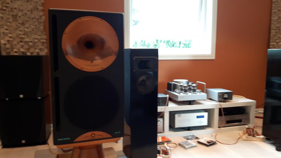

    Troels Gravesen på messe. Jeg hadde nøyaktig samme opplevelse på high end hi-fi kjøpesenteret i Bangkok. Hørte på Wilson, Magico, Martin Logan, Avalaon, god lyd, ja, men når jeg satt meg ned foran noen pimpede Dali 104 (Living Voice OBX) da kom "aahhhh" følelsen.
    Munich-High-End-2016
    All of the drivers used appeared to be very well enginered, but the tuning made a tizzy upper-mid/treble. Michael Borresen explained the motor system of the middriver and it looks like the most perfect driver in the world - and probably is. Right after this demo I heard a tiny d'Appolito (OBX-RW) by Kevin Scott from Living voice - and I heard music. This 30+ year old paper cone driver driven - again - from some Kondo amps - had qualities hard to rival. Which shows we can have the best of drivers, but in the end mating drivers, designing the cabinet and making a proper crossover can be more important. I know the Vifa C17 drivers very well and made four constructions some years ago. Throw a single coil at the C17 and it starts playing music. From a 2016 engineering perspective there is almost everything wrong with the C17 driver, yet the choice of cone, dust cap, spider, foam surround, etc., produces one the easiest drivers ever made when it comes to crossover construction and overall voicing. And Kevin appear to be a master of voicing a speaker. More Living Voice later on the Olympia speakers. I know that some will say I miss the colouration of C17 drivers compared to the Raidho speakers, but it's just not as simple as that. You can have technically outdated drivers, but if you don't push them too hard you don't have cone break-up, compression, etc., and they sound just wonderful. The OBXs don't play deep bass - not all all, but you don't miss it much. Those Kondo amps....I'm afraid not many people will really hear what the OBXs can rea

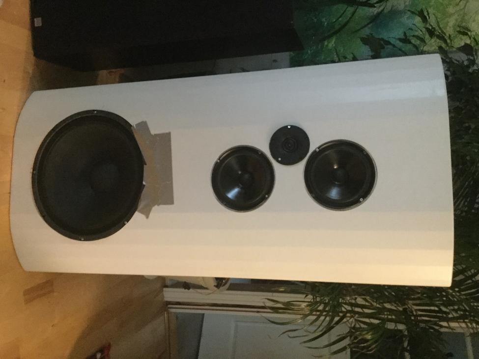

    Mine kloner på fasjonabelt besøk. De skuffet ikke for å si det slik, de spiller rett og slett så vanvittig mye bedre enn de burde hatt lov til. Vet ikke hvordan disse spiller i forhold til originalen eller de andre klonene her, men jeg skal stikke halsen frem her og si at jeg ville stilt de opp i en "shoot-out" any time!
    He he litt cocky her, men er bare så forbasket fornøyd....
