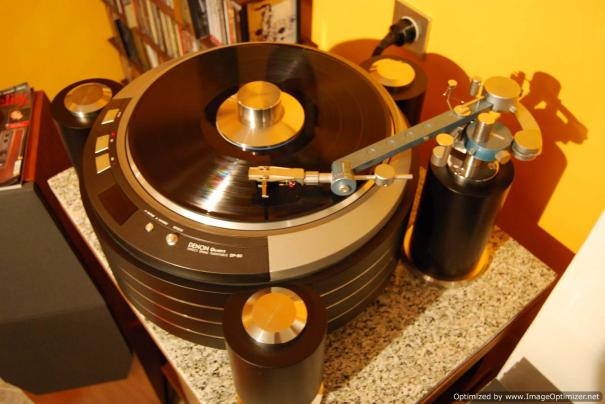

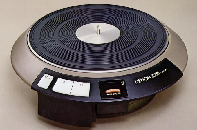

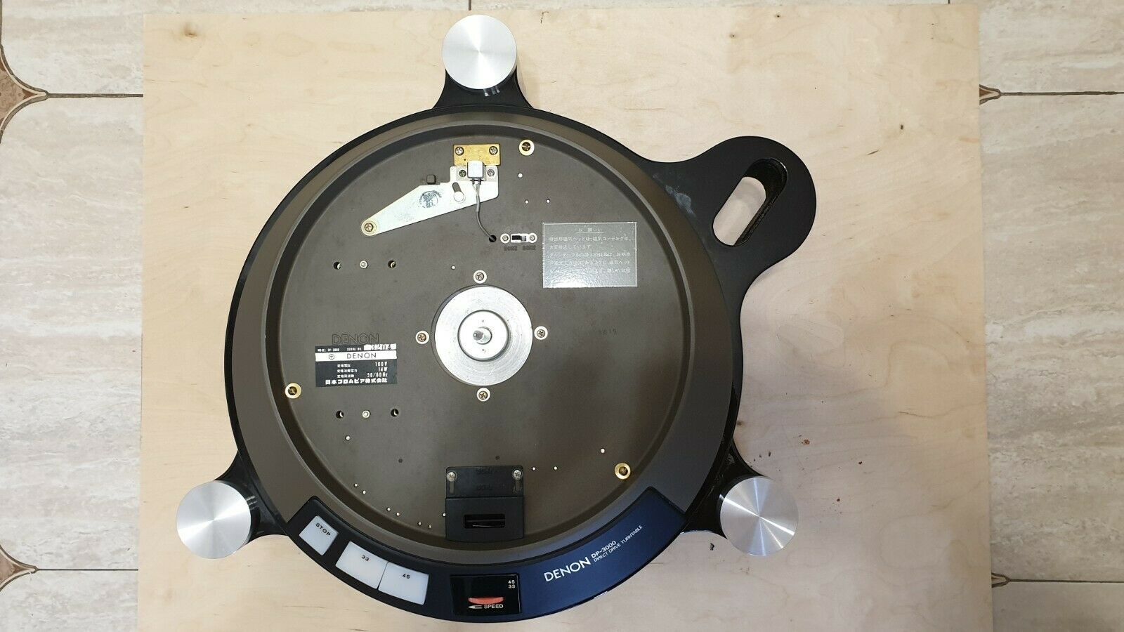

    Nok mere en så´n en: Denon DP-3000
    Fantastisk flot plint i øvrigt :)
    BTW Grumpy...... vil du løfte sløret for, hvor du har fundet den fine plinten???

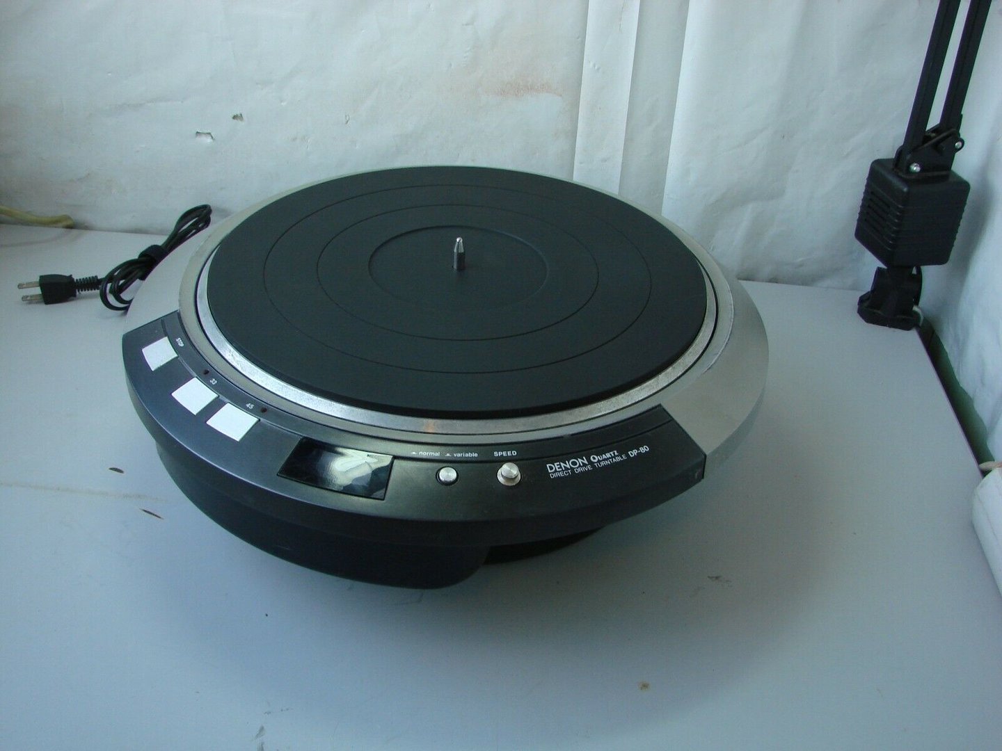

    Nedi kjellern hjemme, så står en motor og venter. Går alt etter planen swapper denne plass med Denonen.
    De beste Denon-spillerne er trolig helt på høyde med tilsvarende spillere fra Victor/Labratory.
    Trafoen fra Airlink med to 100v ankom fra fabrikk for noen uker siden.

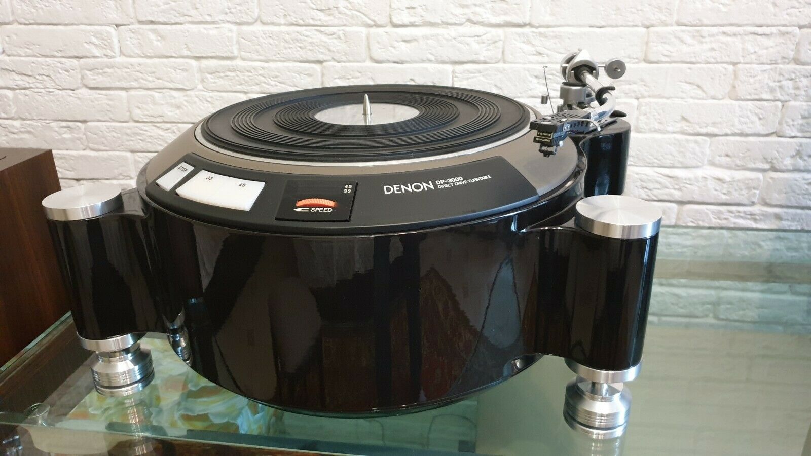

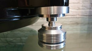

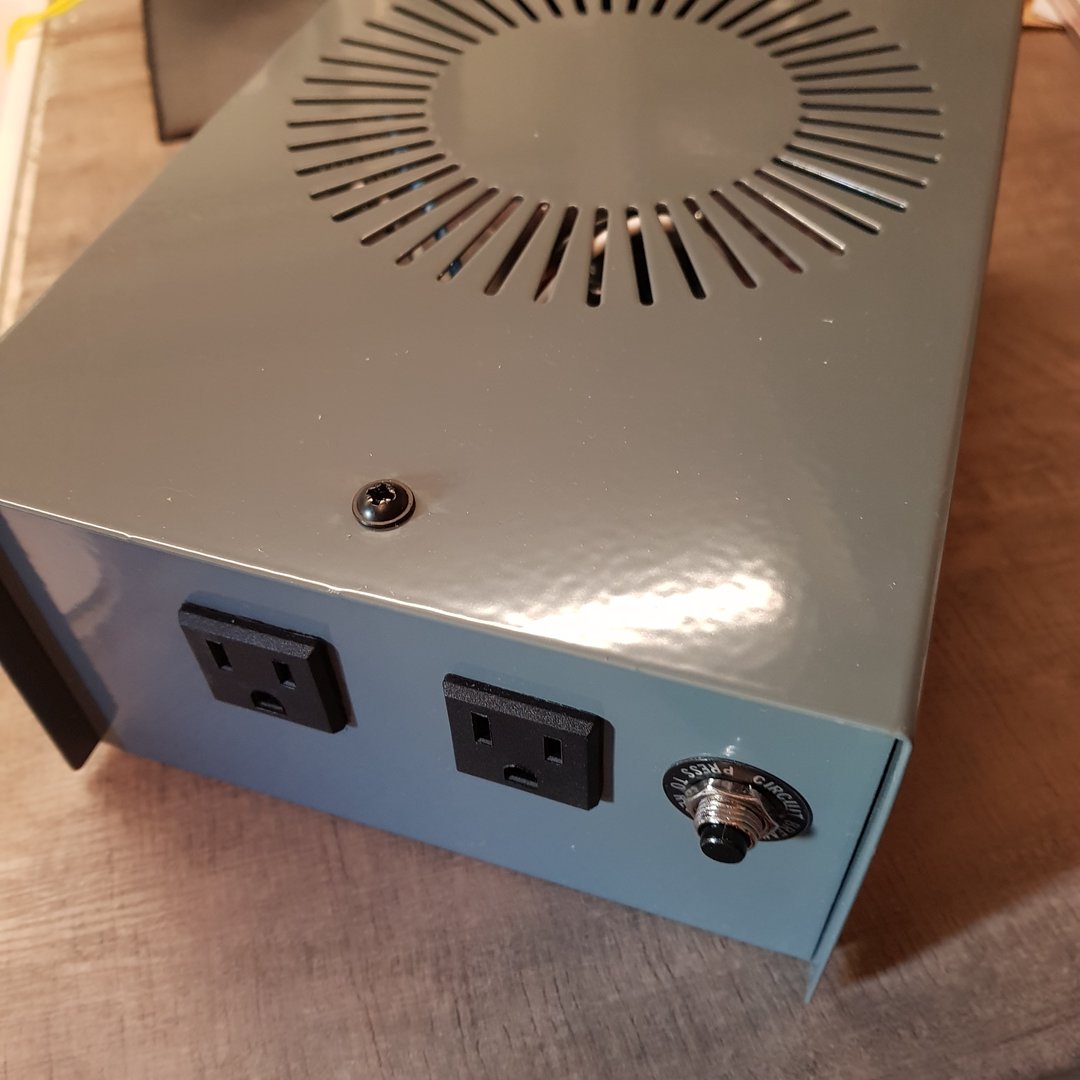

    The table is made on a CNC machine in a workshop for furniture production.
    The table is a “sandwich” of different materials with a cross-section of fibers of different densities.
    To give weight and stability, a lead fraction of the smallest fraction is poured into hidden cavities.
    Table coloring
    1 - Polyester primer applied by pneumatic application.
    2 - Two-component polyurethane enamel - consists of hardener and enamel, the first of which is added before use. The mixture remains viable for 3 hours, and drying lasts 6 hours. The cost of this material is high, as is the strength of the coating.
    3 - Two-component acrylic urethane varnish - two-component acrylic gloss varnishes with a high content of solids HS (High Solid) and an average solids content MS (Medium Solid). Based on the name, varnishes have two components - directly the acrylic varnish itself and, accordingly, the hardener for this varnish. Two-component varnishes are the best universal varnishes that can be successfully used in completely different areas of painting. Two-component acrylic varnishes are weather-resistant, wear-resistant, perfectly polished, quickly dry, and durable in use.
    The bottom of the table is covered with a lid with ventilation holes.
    The cover is made of durable material - Getinax - an electrically insulating laminated pressed material having a paper base impregnated with phenolic or epoxy resin.

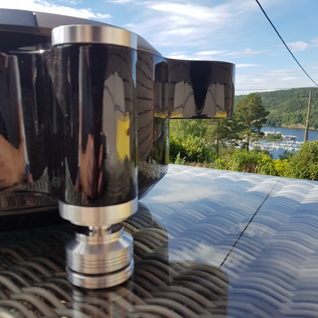

    Sluket var til ubetalelig nytte, med mikrometer og alskens kreativ tolerans for å finne ut hvor skrætsje-lyden satt. Takk for at du fant tilbake til lydløsheten.
    Til ære for dere, satte vi sammen et historisk bilde i norsk sammenheng: De Tre BukkeneBrødre TT-101.
    Den samme uselviske, tusenkunstneriske småpiken designer nå ett eller flere armtårn på tegnebrettet sitt. -Satser kanskje på at syrefast stål blir valgt denne gangen.
