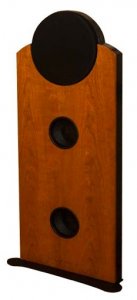

    Denne bør vel fylle de fleste ktiteriene:
    http://www.emeraldphysics.com/Speakers/CS1.html

    Dette liker man (fra siden til Emerald Physics):
    Eliminating the Room
    Emerald Physics has developed a method to control a speaker’s dispersion pattern in order to minimize room interactions and thereby eliminate most of the room’s sonic signature. Our patent-pending BDC (Broadband Directivity Control) technology is a turning point in the history of loudspeaker design. Until now, speaker / room interaction has been one of the major problems in home audio systems. Conventional speakers have wide dispersion and an omnidirectional pattern in the bass range, sending large amounts of sound energy toward the room boundaries, which are reflected back into the listening space with a time delay. These are known as early reflections, which color the sound of the original signal. The omni-directional bass pattern also excites room resonances in all three axis which tends to cause the boomy, ill-defined bass commonly experienced in many systems. The solution is to create a speaker with a more narrow dispersion pattern as well as a more consistent dispersion angle across the frequency spectrum. Listening to mainly the loudspeaker’s direct field eliminates most of your room’s sound, creating a consistent and natural playback performance even in difficult rooms.
    Eliminating the Box
    Emerald Physics uses a boxless design approach called open-baffle dipole in order to achieve several important improvements over conventional loudspeakers:
    • Eliminates box sound – preserves the pitch and harmonic beauty of instruments.
    • Eliminates deep bass limits – Flat response to 20Hz with 2.75 inch thick baffle.
    • Eliminates impedance swings – Maintains same impedance curve as raw woofer.
    • Eliminates large expense of box enclosure – typically the most expensive component in the speaker.
    Eliminating the Large Peaks and Valleys in Frequency Response
    Most loudspeaker systems are rated at plus or minus 3dB. This equates to a 6 dB range at any give area in the frequency response as measured in an anechoic chamber. Once placed in a listening room, it is not uncommon to see 20dB variations. The CS2.3 exhibits an extremely accurate response of plus or minus ½ dB from 100 Hz to 20,000 Hz. This high level of accuracy is achieved through the use of the included signal processor, which provides equalization via our custom software. Multiple preset files allow configurations to be chosen for specific room placement locations for optimum performance in most any room.
    Oh yes baby! 8)

    JENO skrev:
    orso skrev:
    Hva hadde skjedd dersom man i denne "super testen" av høyttalere: Tok med et par høyttalere med en form for kontrollert spredning i mellomtone/diskant, dipol bass-seksjon, samme størrelse orden som de andre og gjerne aktiv deling? Jeg er tilbøyelig til å tro at en slik høyttaler ville ha kommet best ut med god margin.
    Ideelt sett bør selvfølgelig slike tester gjøres blindt.
    Og der fant vi jammen med svaret!
    "I've been trying to describe my CS-2s (Emerald Physics altså) to friends and other audiophools, and usually end up at a loss for words. Now I can just guide them to JP's review. My only gripe with the review is his reference to "at their price" and the like. Last week I was in El Paso, TX, on business and had the opportunity to listen to the top-of-the-line speakers from B&W and TAD. I spent about three hours with them, and when I got home and gave a listen to the CS-2s with the same music, volume, etc, I was very, very happy with my purchase. To my ears, the CS-2s are cleaner, more dynamic, and just as resolving as either of the well regarded, high priced speakers. I believe the TADs were + $50K and the B&Ws were +/- $24K. By the way, I preferred the TADs over the B&Ws."
    "I really enjoy the new CS-2 system. I turned the system on this evening. I couldn't believe what I was hearing in the sound stage. It was almost magical.... The sound is substantially better than my Kef 207s in almost every aspect."
    "Walter, the more I listen to these speakers, the more I'm impressed. If I could sum it up in a sentence or two I would say; they have the best qualities of Magnepan's and Klipsch with a good subwoofer to boot. They are dynamic like Klipsch but pure and refined like a Magnepan with a ribbon tweeter. I can't believe how dynamic these things are. You can listen to them really loud without fatigue."
    Men fant ikke bedre enn Adam. Så et lite forbehold må vi ta. Hehe.
    Så må vi ta med denne:
    "I know that no speaker is perfect but, this speaker comes so close to perfection that the big box companies need to go back to the drawing board."

    Veldig pene høyttalere det - forutsatt at man har plass til dipol
    (det er vel det de fleste av oss sliter med, og som er ett av de sterkeste ankepunktene mot dipol IMHO)
    Likte spesielt denne:
    http://www.soundstage2.com/avtour2008/oct12a/emerald_physics2.jpg
    2 x 15 " basser i to ledd per side - lurer på hvordan fasen mellom bakre og fremre rekke er satt. Hmmm.. forstår ikke den der helt: man kan få fremre og bakre rekke til å spille i fase på "utpust" men da blir vel faseforholdene dobbelt forverret på "innpust"?

    Er det i ferd med å bli halleluja-stemning rundt Emerald Physics nå uten at noen har hørt dem? ;D
    Jeg må innrømme at de har et tiltalende design som ligner mest på kompromissløs diy eller dyre custom-høyttalere. Til prisen regner jeg derfor med at de presterer bra, men i forhold til det aller beste vil det vise seg når noen får gransket dem skikkelig.
    Jeg synes imidlertid at de er litt vel kryptiske angående hva den toppseksjonen består av. Er det bare en 12" coax i OB, eller er det noe mer hokus-pokus? Før brukte de en Selenium kompresjonsdriver i en waveguide som ligner veldig på Geddes' OS waveguide.
    Og hva skal de portene foran bassene være godt for? Jeg regner med at det gjør et eller annet for strålingsmønstret sånn at det ikke blir et perfekt 8-tall, men kanskje møter strålingsmønstret til toppseksjonen på et eller annet vis, om ikke toppen bare er vanlig OB også da.
