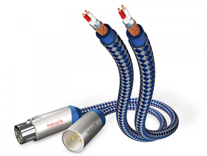

Har bestilt et par Inakustik i håp om at den doble skjermingen fikser biffen. :)

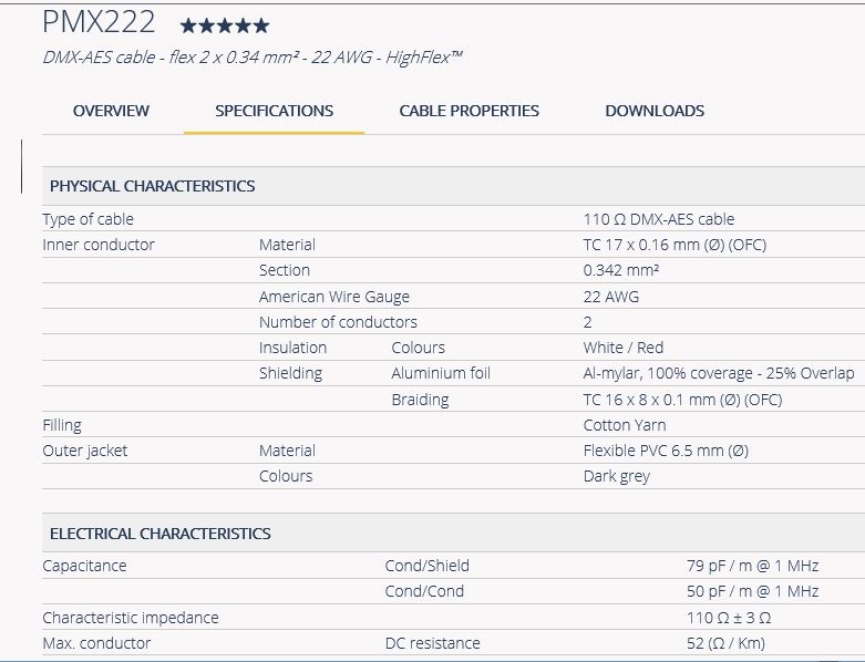

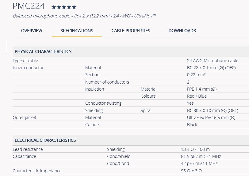

Noen som har prøvd DMX kabling som digitaleller analog XLR?
https://www.churchstagedesignideas.com/dmx-vs-xlr-cables/
Analog XLR er jo ikke særlig krevende..
The major difference is the "transmission impedance". Dmx (and AES) are in the 100-120 ohm range while typical mic cables are in the 40-50 ohm range. It will make almost zero difference if you are running analog signal down them but it will affect the signal quality of a digital signal. The data will get rounded off and lose its shape resulting in errors if as you increase the length. You can use DMX and AES cables for regular mics if you like, it won't make any real difference neither improving nor degrading the sound quality (if the length is less than a coupe hundered feet or so). You might get away using regular mic cables in place of DMX or AES at shorter distances (10-20 feet or so) but this will depend how much data you are trying to shove down the line.
prøver meg på denne
https://www.soundshop.no/kabler/dmx-kabler/procab-premium-dmx-kabel-1-5-meter-3pin
https://procab.be/products/d/pmx222---dmx-aes-cable---flex-2-x-0-34-mm2---22-awg---highflex#overview
DMX data
Microfon kabel brukt i analig XLR.
https://www.soundshop.no/kabler/xlr-kabler/procab-premium-xlr-kabel-1-5-meter

Inakustik var ihvertfall katastrofe. Fysisk feil på ene pluggen gjorde at jeg ikke en gang fikk den inn i forsterkeren.
Ikke var kvalitetsfølelsen i seg selv noe særlig, heller. Veldig lett og plastic fantastic.
