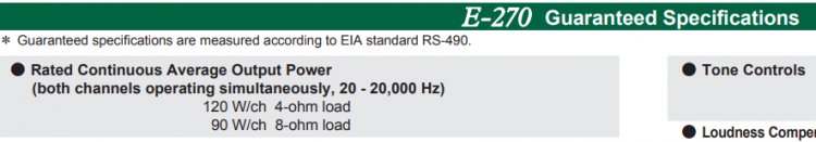

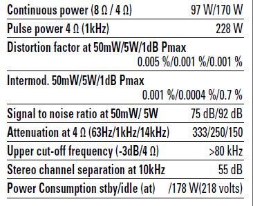

    Jeg finner ingen målinger av klasse A forsterkerne til Accuphase på nettet, men har funnet et par andre.

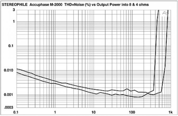

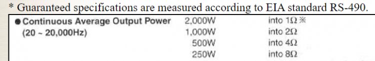

    M-2000

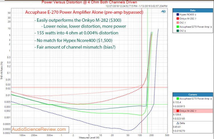

    E-270:
    Fra kurvene kan vi lett se ved hvilken effekt forvrengningen begynner å stige. Dette er på grunn av at spenningen i strømforsyningen ikke er høyere enn det den er.
    M-2000 er oppgitt til 250W i 8 ohm, men klarer 370W. 48% mer.
    M-2000 er oppgitt til 500W i 4 ohm, men klarer 590W. 18% mer
    E270 er oppgitt til 120W i 4 ohm, men klarer 155W. 29% mer.
    Accuphase har altså sitt helt på det tørre og til og med noe å gå på når de oppgir effekten på sine forsterkere.

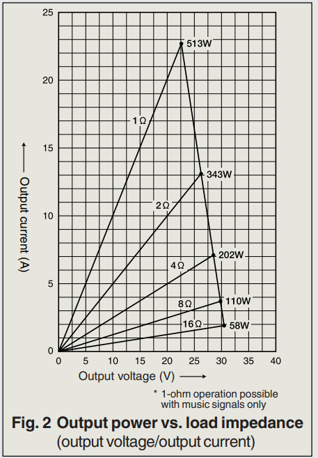

    Fra Accuphase manualen (forøvrig utrolig pene manualer)
    http://www.accuphase.com/historys/pdf/a-60_e.pdf
    "Note 1 Low amplifier output impedance
    The load of a power amplifier, namely the loudspeaker generates
    a counterelectromotive force
    that can flow back into the amplifier
    via the NF loop. This phenomenon is influenced by fluctuations in
    speaker impedance, and interferes with the drive performance of
    the amplifier. The output impedance of a power amplifier should
    therefore be made as low as possible by using output devices
    with high current capability. This absorbs the counterelectromotive
    force generated by the voice coil and prevents the occurrence of
    intermodulation distortion
    Note 2 The constant drive voltage principle
    Even in the presence of a load with wildly fluctuating impedance,
    the ideal power amplifier should deliver a constant voltage signal
    to the load. Figure 2 shows the results of actual output voltage/
    output current measurements at different load impedances for the
    A-60. It can be clearly seen that output voltage is almost constant
    at various loads, which means that current increases in a linear
    fashion. Actual measurements of clipping power have yielded the
    following figures, which impressively demonstrate the more than
    ample performance of the A-60: 1 ohm: 513 watts, 2 ohms:
    343 watts, 4 ohms: 202 watts, 8 ohms: 110 watts."
    Fra denne informasjonen kan vi se at Accuphase A-60 kan levere en RMS spenning på 32V hvis den belastes med lette 16 ohm og at spenningen på utgangen synker til 27,5V når lasten synker til 2 ohm. Hvorfor synker spenningen? Jo, det er to grunner til dette.
    1. Power supply er ikke uendelig kraftig.
    2. Dempingsfaktoren er ikke uendelig høy
    På en perfekt forsterker ville effekten doble seg hver gang impedansen halveres og streken oppover på grafen ville vært loddrett. Ikke engang Accuphase er perfekt, selv om de er bedre enn mange andre på det området med sine store power supply og relativt lave utgangsimpedans. Noe de også påpeker i "Note 1"
    A-60 bruker en DSP for å måle effekten ved å måle både strøm og spenning til enhver tid beregner effekten. Jeg ser de har en peak-hold funksjon men det står ikke om det er RMS-peak eller om det er "ren" peak som i øyeblikksverdi.
    Hvis vi går ut fra at det er øyeblikksverdi så må vi se på hvilken peakspenning 32V RMS er. For å finne dette må vi gange med 1,41 og finner at peak spenning er 45V. Vi vet altså at A-60 kan altså kan levere peak 45V på terminalene. Hvis impedansen i dine basser er 5 ohm vil peak effekt være 45^2/5= 400W
    Hvis vi går ut fra at de bruker RMS-peak og at forsterkeren klarte å holde spenningen på 32V en liten stund så må motstanden i bassene dine ha dippet til 2,56 ohm i dette øyeblikket (32V^2 / 2,56 ohm = 400W).
    Uansett hvilken måte de måler på så er det en ting som er sikkert. Du får aldri mer enn 32V RMS på utgangen av en A-60 og i 8 ohm så er det 128W peakeffekt. Har du sett 400W på meteret så er det ikke fordi spenningen har vært over 32V, men fordi forsterkeren faktisk bruker så mye effekt for å "holde igjen" basselementenes bevegelse som også forklart i manulen (uthevet i rødt over).

    Accuphase A75 gir 60W / 8 ohm i klasse A. Så går den over i klasse B og gir 131W / 8 ohm. Ved lavere imp. økes betraktelig.
