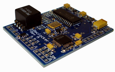

    Trenger hjelp til å kvalitetssikre et kjøp:
    Jeg skal oppgradere min SONOS ZP80 soneplayer med Cullens digitalutgang som reduserer jitter og annen støy dramatisk.
    Jeg lurer på om 96 kHz som fast sample rate er riktig til AN Dacen min. Dette er nemlig ikke mulig å stille inn, det settes fast under modifiseringen?
    Her er mitt spm + svaret jeg fikk fra Cullen:
    Secondly i wonder if 96K is matching my Audio Note 2.1X DAC. Do you know?
    Hi Hans I will change your work order to state that you have a ZP-80, The 96k Mod will work fine with your unit.
    Thanks Jan
    Are you sure. Audio Note dac is 18 bit and some people tells me that AN dacs could have problems with upsampling? I dont know but i want to have the best solution and a solution who works. :) Hans Erik
    Hi Hans Erik
    I had the tech look up your unit yesterday, He told me that the 96k would work fine for your unit.
    Her er litt tekst og foto fra Cullen:
    The upgrade consists of installing a new custom Cullen Circuits designed PCB that contains:
    - High-end sample rate converter made by TI
    - Low jitter clock with less than .5ps jitter
    - Low noise power supply for the clock and SR
    - Micro processor controller
    - Input & output digital buffers
    This new custom board is installed in the SONOS and directly converts the I2S into 96kHz up-sampled SPDIF. This new ultra clean low jitter signal is now available thru both the Coax and Optical digital outputs. The SPDIF output's sample rate can also be factory configured to 48, 96 and 192kHz.
    The sonic benefits are quite dramatic. An entire level of low level grunge (hash) is removed from the sound. This improves the low level detail and imaging. The bass is now much tighter and controlled. Inner detail and transient attack are both greatly improved.

    Ta en tlf til Upgrade Audio - de vet dette. Så vidt jeg vet takler vel digitalkortet i AN-DAC 16/44.1 -> 48.0 kHz, tror ikke du får matet den med et 96 kHz signal...
    Hornlyd
    Musikkglad
    01.04.2005
    21.073
    13.562
    Ringte upgrade og 192 går ikke men 96 var han temmlig sikker på :)

    Hmm. Interressant. Dette er fra manualen på min 2.1X DAC. Denne Cullen moden jeg har planlagt er kanskje unødvendig mtp at AN mener at reclocking og jitter reduksjon i DACen faktisk tåker til lyden?? Cullen moden gjør nettopp dette: reclocker, reduserer jitter og upsampler til 96 kHz??
    For å si det slik. Jeg stoler mer på ørene mine og erfaringen med at Peter Q lager musikalske produkter enn målemafiaen!! (Nå blir det bråk 8))
    In other words, all products in the Audio Note DAC range have no
    oversampling, no jitter reduction, no noise shaping and no re-clocking
    . Having
    removed all the digital filtering that is part of the oversampling, we have also
    dispensed with all filtering in the analogue domain to further retain good wide band
    phase-frequency and dynamically coherent behaviour. The end result being a
    reproduction more reminiscent of master tape in quality, with greater differentiation
    and contrast between different recordings.
    Our converters all use a high grade selected Analogue Devices AD1865, 18Bit stereo
    converter chip because we found this chip to be the best sounding available (yes, even
    better than the 20Bit and 24Bit versions!). This is fully compatible with 16-bit
    44.1kHz technology as well as 48kHz and can also be used with the 24-bit 96kHz
    DVD-A standard as the DAC chip will only loose resolution at the 20th, 22nd and
    24th Bit, a truncation that mildly reduces the resolution. Tests have shown that this
    information loss is inaudible when compared to comparable methods used in digital
    technology, which involve either oversampling, up sampling or other digitally derived
    signal manipulations or “improvements”.
