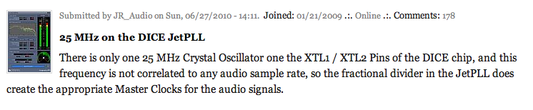

Slik jeg leser tråden på Computeraudiophile kan det se ut som om Weiss bruker t.c. electronics innmat.
Men det jeg stusser på er denne stabilitetsfunksjonen som DICE chip nødvendiggjør - merkelig at de ikke bare bruker standardbehandlingen til t.c.?
This interpretation is further supported by the existence of the Operation Mode / Stability setting in the DAC202 control panel software. This appears to control the parameters of the PLL. It would not be needed if the DAC202 were using a fixed master clock instead of a PLL.
Det virker som om de har gått en omvei i forhold til å anvende det opprinnelige JET klokkesynkroniseringssystemet til t.c. -- men også viktig å få med seg distinksjonen som Weiss nevner her - de har valgt isochron overføring fordi de også ønsker å sende kontrolldata uten å forstyrre den avsatte båndbredden til musikkdata. (Slik deling er helt vanlig.)
First thanks to Chris for his favorable review. Very much appreciated.
Here is an explanation of how the Firewire (or IEEE1394 or 1394 for short) transmission works in the case of our Firewire based units.
The Firewire bus is used in the so called isochronous mode. This mode has the advantage that a fixed amount of the bus bandwidth is reserved for audio transfer. The remaining amount is available for possible control data. This means that it can not happen that there are sample losses due to bus congestion.
The devices hooked up to a Firewire bus are called Nodes. I.e. the computer is a node, the DAC202 is a node, there can be several DAC202 units on the bus for multichannel playback, each of them is a node.
Each node has by Firewire standard a fixed 24.576 MHz clock with a +- 50ppm tolerance built in. In each node that clock drives a a counter counting the 24.576 MHz clock cycles. This is the “local timer” as referred to below.
From the DICE manual:
“All nodes on a 1394 network must be synchronized to one clock called the cycle timer, which is determined by the master node on the network. One cycle of the master nodes’ cycle timer defines a 1394 cycle. At the beginning of each 1394 cycle the master node transmits a clock sync signal that allows all nodes on the 1394 network to be synchronized to the cycle timer. This maintains synchronicity among all the 1394 nodes. Each 1394 node receives the clock sync signal and uses it to update or correct its local timer.“
So in essence there is a master node which broadcasts a clock sync signal every 125 microseconds to all other nodes. This sync signal resets the “local timers” in all nodes in order to realign them to the master node. As the 24.576 MHz oscillators are obviously not synced between the nodes, there will be jitter in the local timers due to the sync signal coming from the master node. If a slave node has a D/A converter running off the Firewire bus, the associated PLL has to cope with that jitter. I.e. the PLL has to be very well designed to get decent jitter figures. The so called JET PLL used in the Dice for that purpose is described in (1).
The DAC202 is potentially a slave node if there are more than one DAC202 on the bus. If there is a single DAC202 on the bus, it is the master node and thus the source of the wordclock (sampling rate). This is the case with the wordclock generated internal to the DAC202. Alternatively with the DAC202 slaved to an external sync via its AES/EBU inputs or Wordclock input, the external sync source is the master for the Firewire transmission. The case where a AES/EBU source is connected to the DAC202 and the data transferred to the computer for recording, shows that the DAC202 obviously can control the Firewire bus and thus is not synced to a clock coming via Firewire.
The JET PLL also generates all standard sampling rates out of a single crystal oscillator when in internal sync mode. This shows that the JET PLL has the necessary quality in terms of jitter performance.
(1)http://www.tctechnologies.tc/downloads/jetpll/docs/jetpll_aes_paper.pdf
(2)http://www.tctechnologies.tc/index.php?option=com_content&view=article&id=10&Itemid=14
