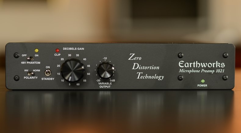

    Da har Ljudia sett på mini preen og friskmeldt den. Den hadde tydeligvis vært åpnet.
    Kommer nok til å hente den, men den vil ikke bli brukt.
    Har i god puristisk ånd flesket til med denne:)

    Preamp Type: Solid State
    Number of Channels: 1
    Frequency Response: 2Hz to 100kHz ±0.1dB, 1Hz to 200kHz ±0.5dB
    Impulse Response: 1.4µs
    Distortion: XLR out: less than 1ppm (0.0001%); 1/4” out: 0.001%
    Input Noise: 1.6nVHz½ at 20dB gain; 0.6nV/Hz½ at 60dB gain
    EIN: -132dBV at 20dB gain; -143dBV at 60dB gain
    Slew Rate: 22V/µs
    Output DC Offset: ±1 mV typical, servo balanced
    Power Requirement: 120V AC (100V and 200-240V versions available)
    Input: 1 XLR Female balanced transformerless
    Input Impedance: 10KΩ phantom on, 100KΩ phantom off
    Outputs: 1 XLR Male balanced transformerless (stepped)
    1 ¼” TRS XLR Fem. balanced transformerless (variable)
    Dimensions: Half rack space 1.75” x 8.75” x 10.375”
