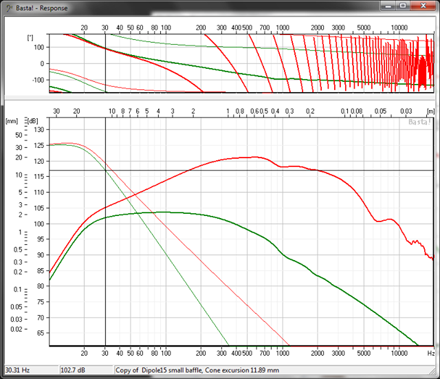

    Vis vedlegget 306438
    Many people are interested in using open baffle woofers but simply don't know where to start. We will be having more information on this in the future, but here is a simple starting point that requires only one active filter. This model is for 2x Dipole15's on a small 18"x34" flat baffle that is really just big enough to fit the drivers. The red curve is the natural response. This shows the high amount of baffle rolloff there is to contend with and explains why a passive crossover design can be difficult to implement with open baffles.
    However, with one simple 6dB lowpass at 35hz, things smooth out very nicely. Response is now +/-2dB from 23Hz to around 400hz. With 36V input this system will give 102.7dB at 30hz without surpassing the Xmax limits of the two Dipole15's. Increasing the baffle size can increase the low end efficiency further and in turn increases the efficiency of the whole system. More on this later.
    Med to Dipole15-D8 i serie parallell får man re på ca 6 ohm som igjen krever en 28 mH spole i serie (på pluss-ledningen som går videre til hver av driverne).
    Som en passiv løsning så tror jeg det enkleste er å kjøre 6 dB high pass til Fostex 203 og teste kondensatorer fra 20 til 60 uF og bruke en variabel L-Pad for å dempe fulltonen noe i området 5-10 dB. Polariteten på fulltonen kan underveis snus frem og tilbake for å se om det er i fase ved å få så stor dipp som mulig med motsatt polaritet av det som blir korrekt polaritet?? hmm vanskelig formulert.

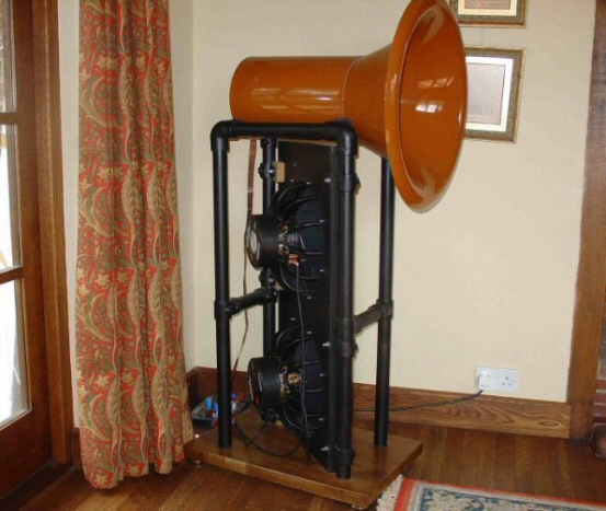

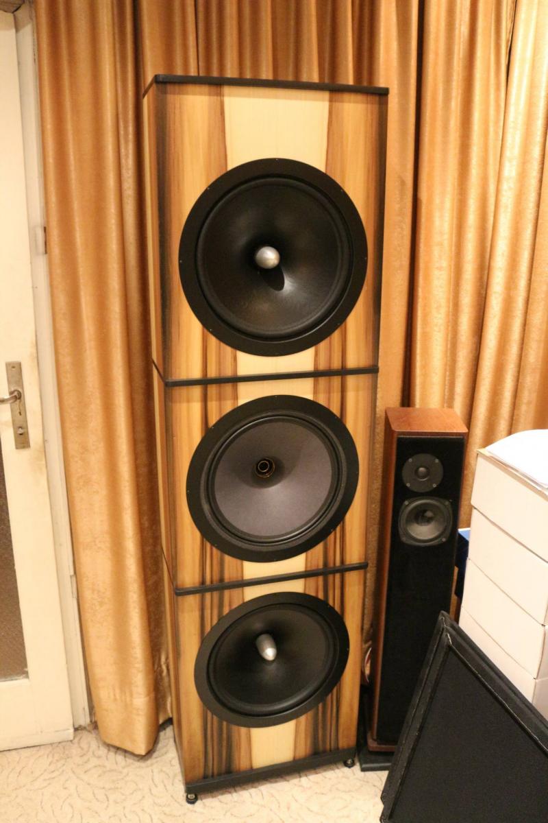

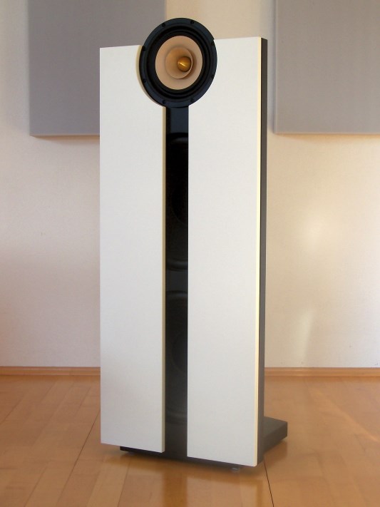

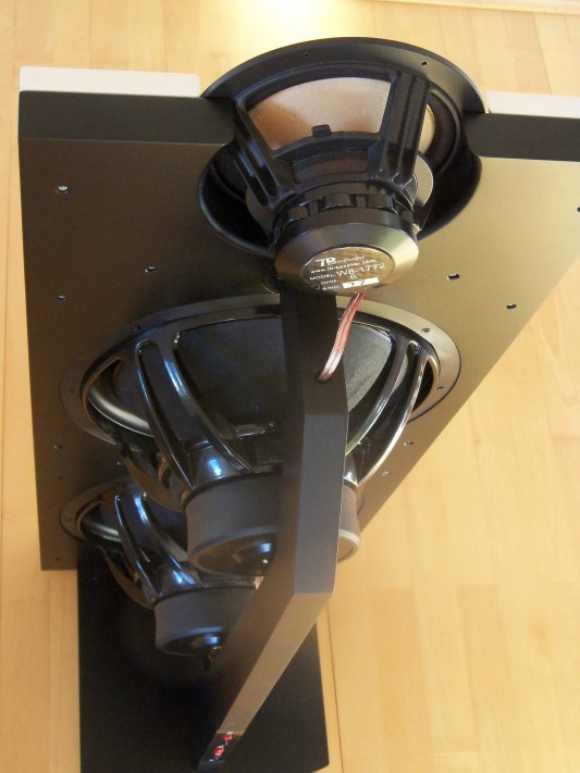

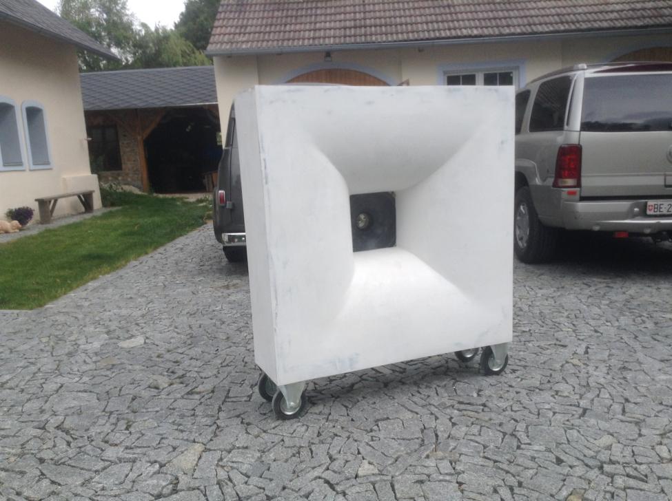

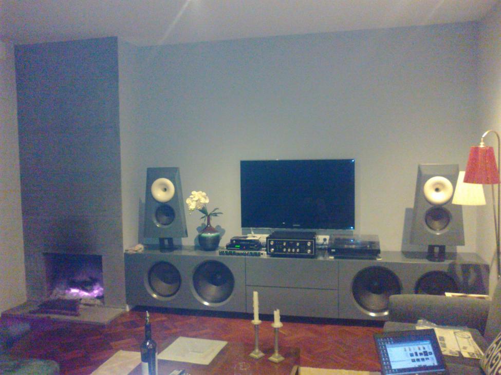

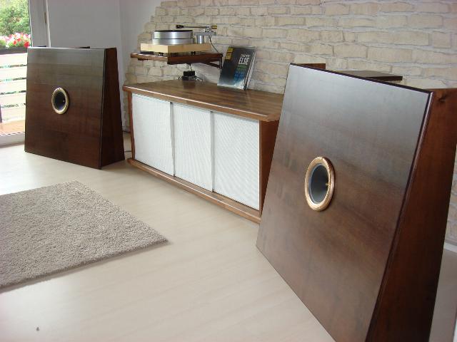

    Mirko Kubala
    outside..work in process. Monolith horn loudspeaker. Stereo..5 fullrange loudspeakers per side in the back. 3 loudspeakers per side front. full active, WiFi,Bluetooth. Stucco Venetiano . Fantastic sound. Woman best friend! Lovable, mobile.Electricity independent! For Sale ! ONE piece of ART only !
    the small box is: an original Altec A8 voice of theatre! An ugly looking, but good sounding loudspeaker. Lets change it to a woman acceptable piece of art; 420 Lecleach horn with a Altec 806 driver, 15" bass speaker, 2 way, full active with digital T - amp. Paint: Stucco Venetiano, ...lavable too!
    DIY 10 cell multicell horn. Round horn Lecleach
    https://www.pinterest.com/wumi8888/diy-or-i-do-it-for-you-building-a-loudspeaker-bar-/
    mteinum
    29.05.2007
    10.488
    5.151
    Øya

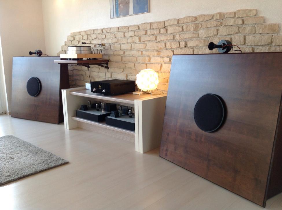

    Disse ser bra ut, også mtp størrelsen
    GR Research V1

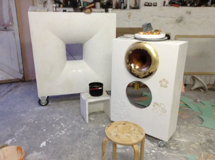

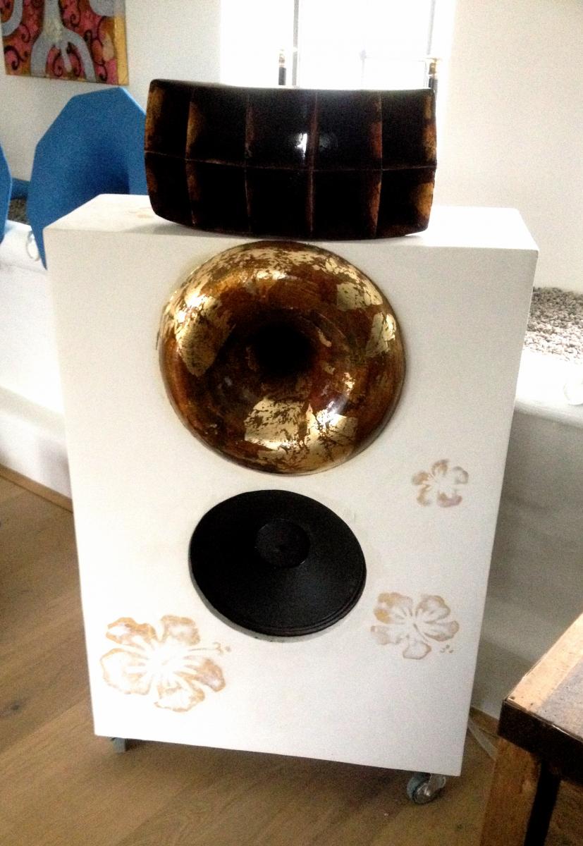

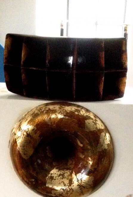

    Har virkelig sansen for hvordan Mirko dekorerer hornene sine, har googlet de opp og ned en stund uten å egentlig finne ut så mye.trolig er det en kombinasjon av bladgull/bladmetall og div oljer.
    Dette er brukskunst på høyt plan i mine øyne, virkelig lekkert og dekkorativt.
    ønsker en lignende finish , hvis noen vet hvordan det gjøres vennligst gi meg et hint.
    Han har enormt mye bilder på sin private facebook side. (du må legge ham til som venn)
    https://www.facebook.com/mirko.kubala?fref=ts

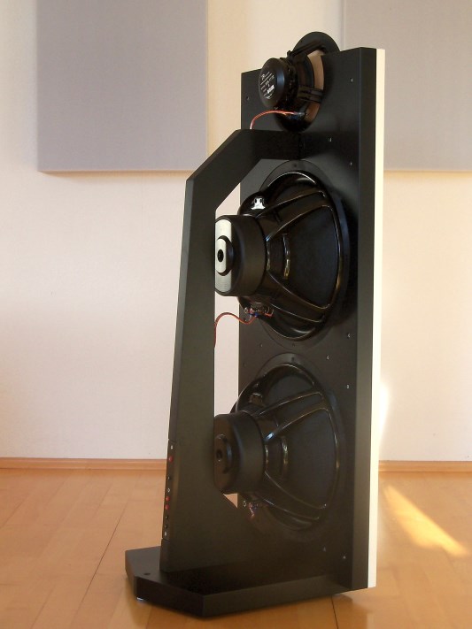

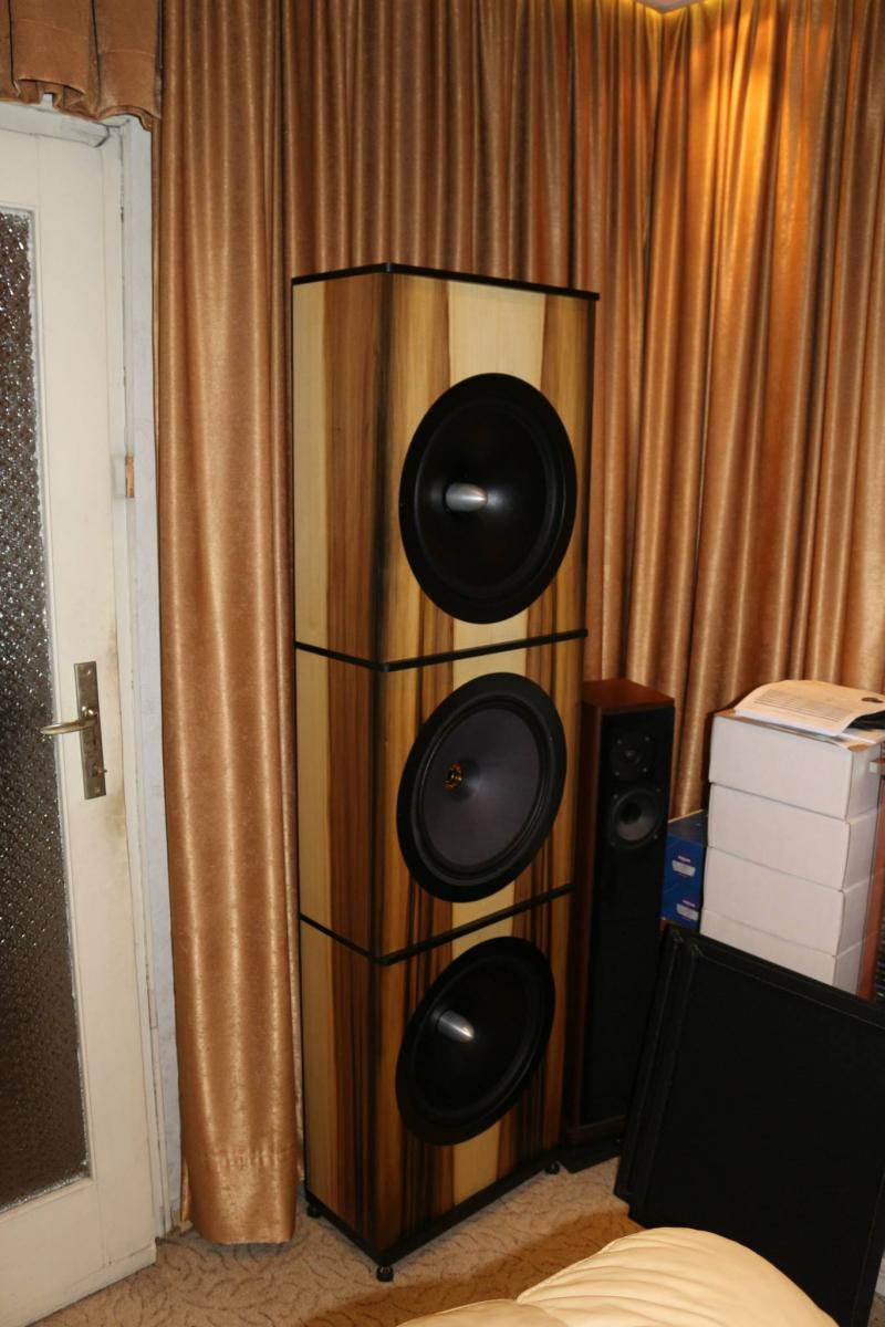

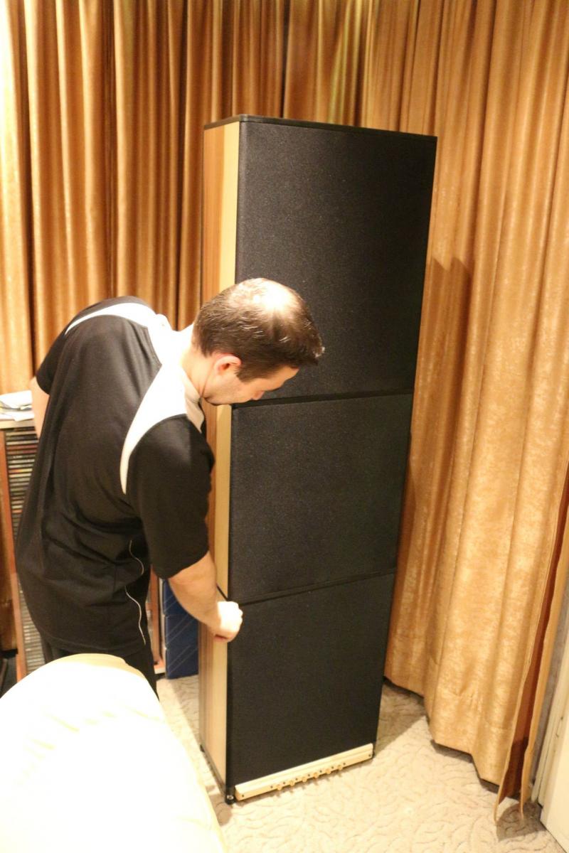

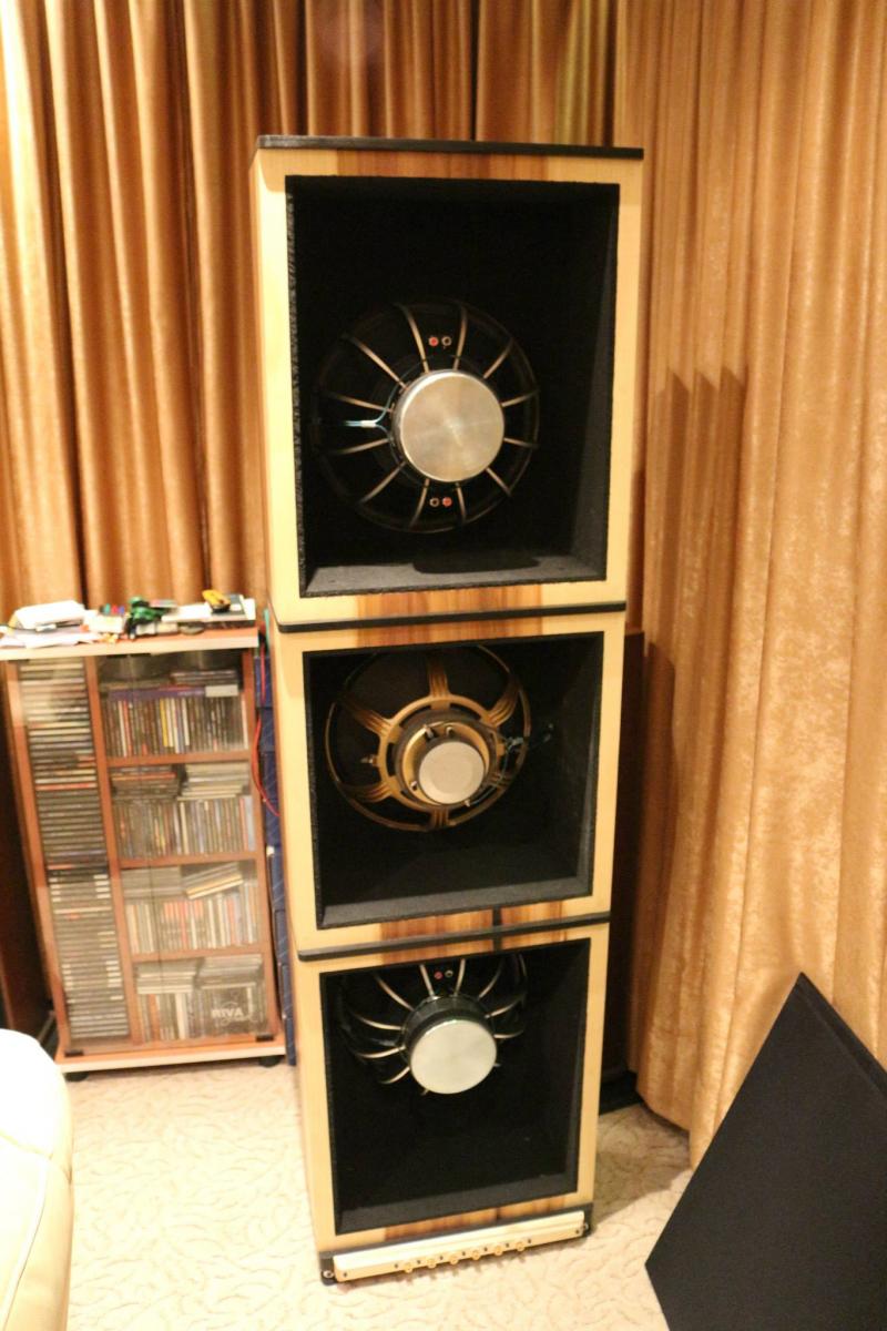

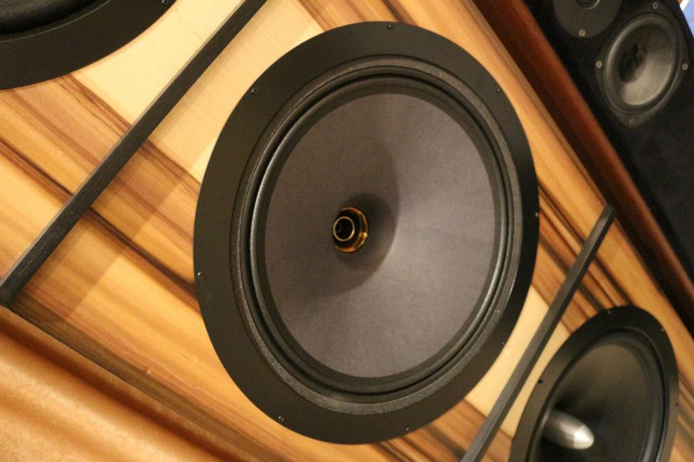

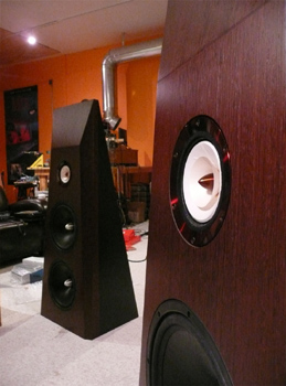

    Noen bilder fra facebook
    AE basser, Beyma i topp

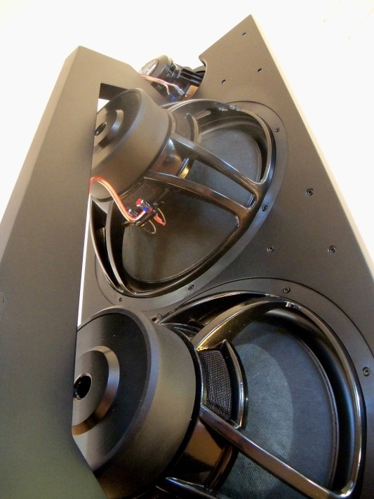

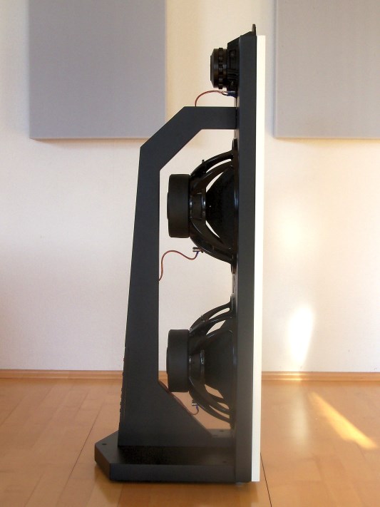

    flere fra boka, tror ikke disse har vært postet før i denne tråden

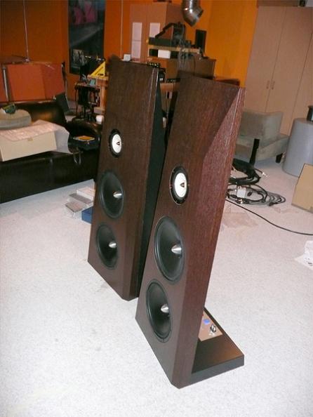

    Da har jeg forhørt meg litt hos både MJK og Pass, angående Project 10 ( Project 10 : Lowther Open Baffle / Acoustic Elegance H Frame System )
    MJK bruker selv dBx Driverack PA, men dette er en retning jeg ikke ønsker å gå. Ikke mye poeng med en DSD DAC dersom det analoge signalet må via en AD-DA prosessor. Pass mener at jeg bør prøve ut B5 til mitt formål.
    Så, last call: Er det noen som har en brukt B5 liggende som ikke er i bruk, om ikke kjøper jeg inn en fra Reno Hi-Fi.

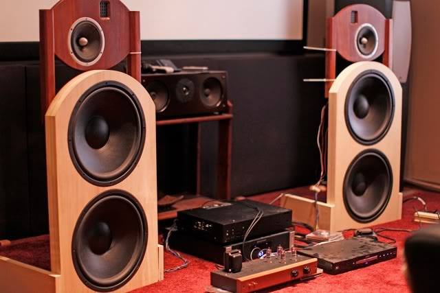

    Det blir som en slot, den komprimerer litt. Sjekk Emerald Physics.
    Fulltonen er Tang Bann, bassene er Peerless aktige, trolig lav fs og følsomhet rundt 90 dB pr stk med smultring oppheng og tyngre membran enn typiske PA basser.

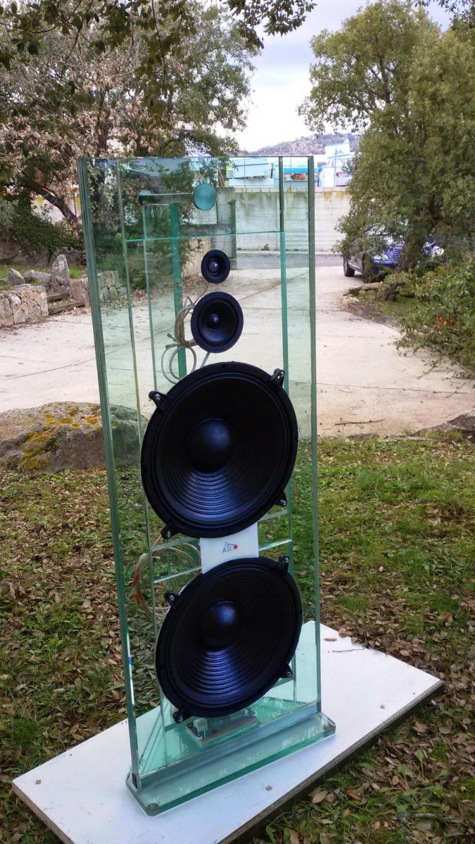

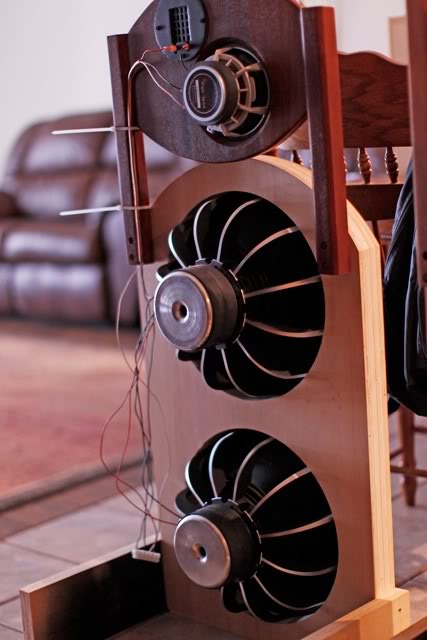

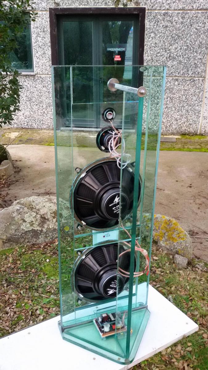

    Ikke helt stuevennlig, passer nok bedre på hjemmekontoret
    Her en penere baffel:

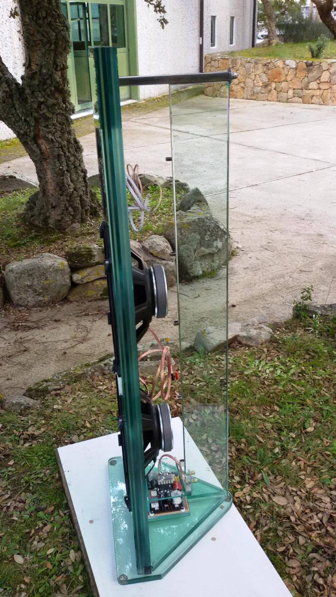

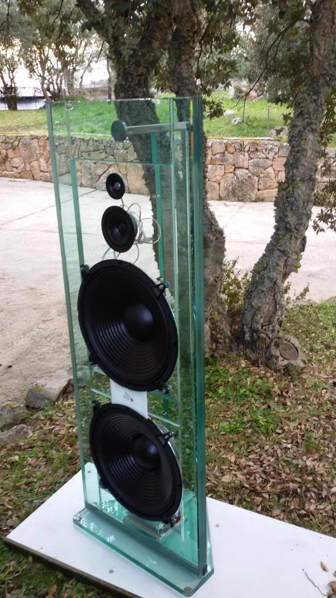

    Relatert
    JCP
    22.04.2014
    780
    368
    Moss
    Hmmm.... pseudo-WAF, eller meta-WAF. Dvs. jeg syns OB i glass har høy WAF, men jeg er veldig usikker på om Hun er enig :D
