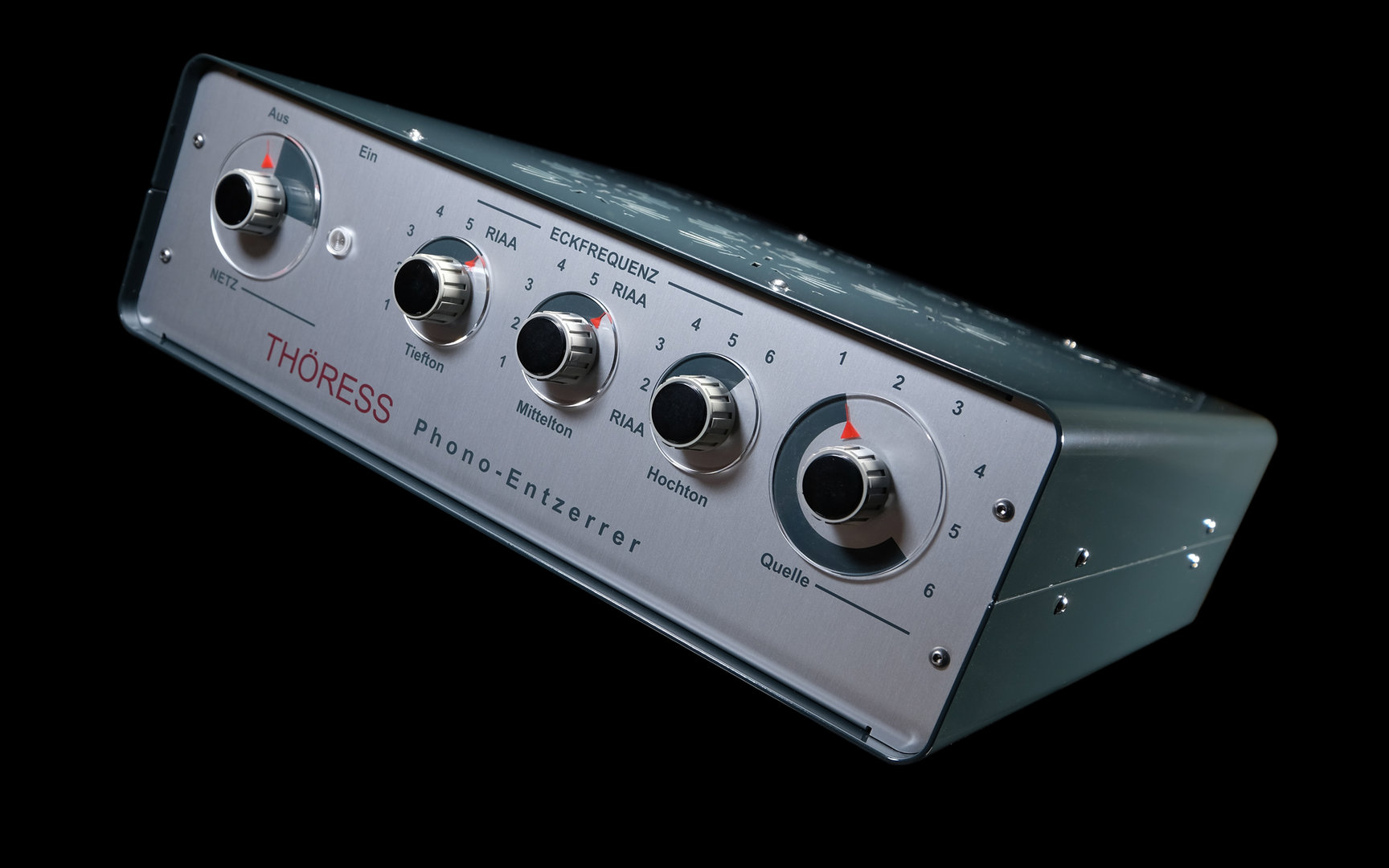

THÖRESS proudly presents the Parametric Phono Equalizer MKIII...
a highly versatile vacuum tube phono preamplifier which offers MM and MC
amplification with excellent signal-to-noise performance in purely active operation
mode (without the aid of step-up transformer gain). And, furthermore, unique onthe-

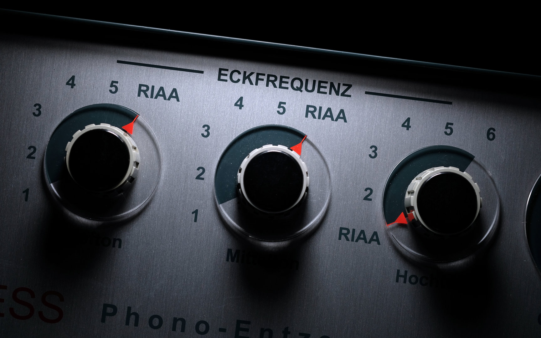

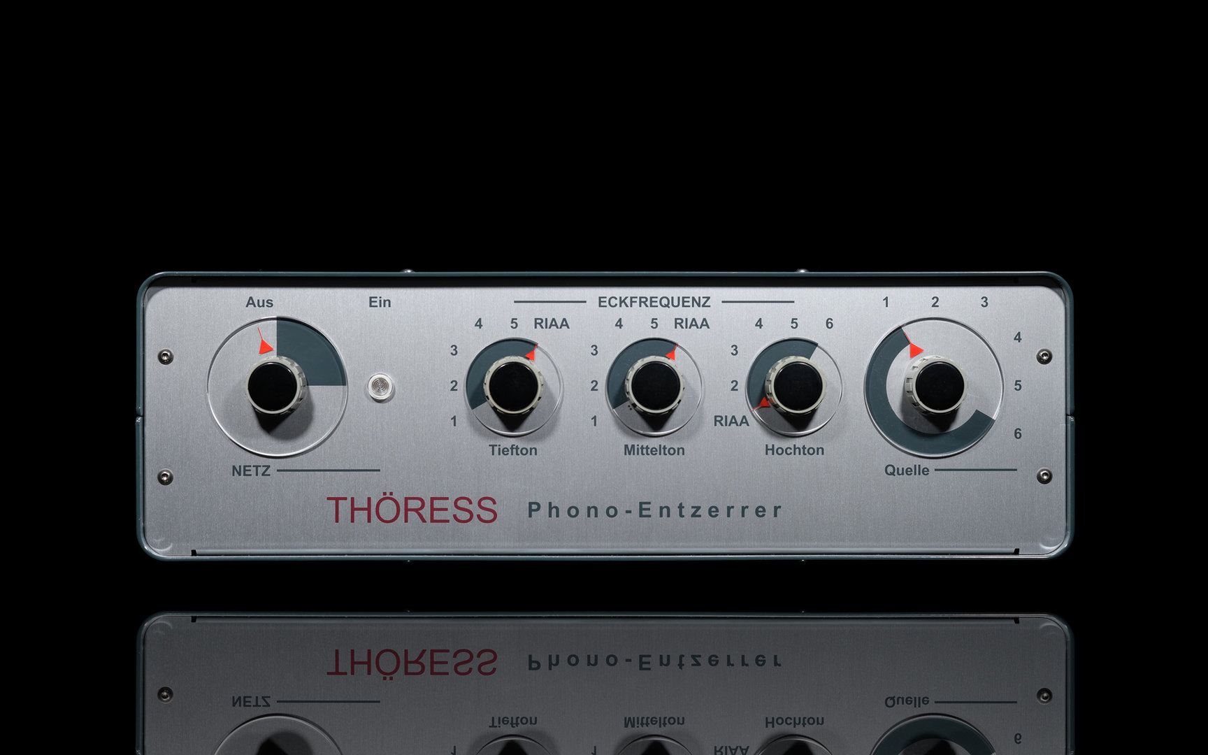

fly tone adjustements. More specifically, the frequency response of the
amplifier can be controled within wide limits by varying the three de-emphasis edge

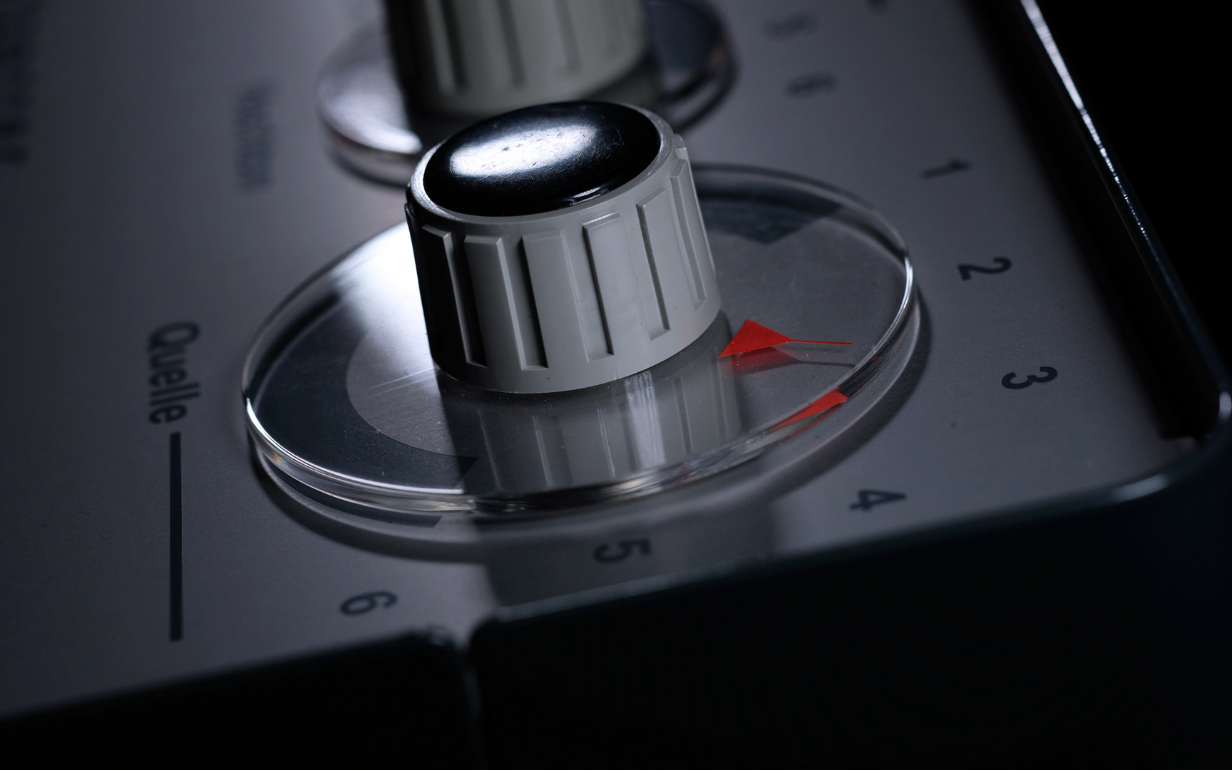

frequencies f1, f2, f3 by means of three 6-position rotary switches TCSW1, TCSW2,
TCSW3, which we call tone selectors. Obviously, this design concept justifies the
term PARAMETRIC PHONO EQUALIZER. With selectors in default position the
amplifier performs highly accurate RIAA de-emphasis, the most widely used
equalization characteristic, given by the NEW ORTHOPHONIC prescription

The three tone selectors give rise to subtle bass, middeltone and treble control
functions which are highly effective tools for restoring tonal imperfections of the

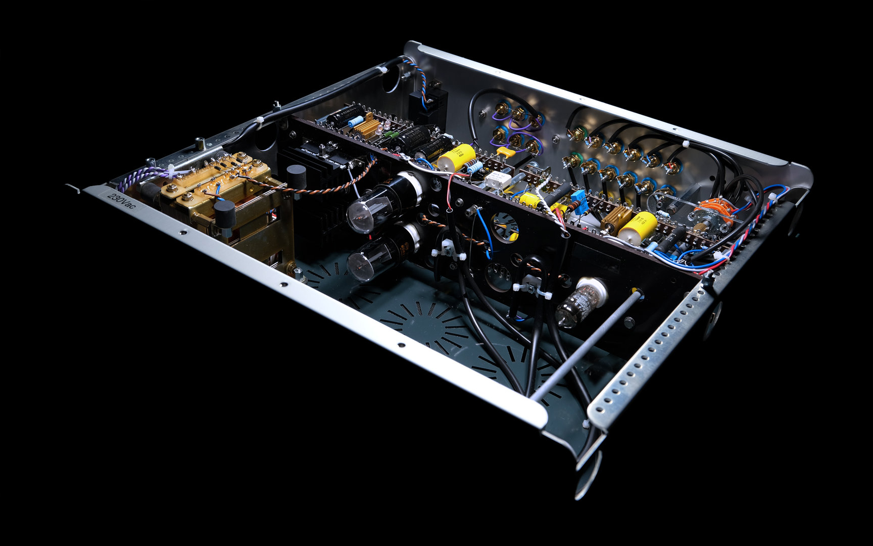

The amplifier is built with meticulous hand construction using our proven point-topoint
wiring techniques, whereas much care has been taken in arranging each
aspect of the internal construction to ensure low noise performance, ease of service
and the highest reliability for many years to come. The Phono Enhancer is an

CIRCUIT TOPOLOGY
Our Phono Enhancer employs
(2x12J5GT+2xPC86)
vacuum tubes and is entirely based on SINGLE-ENDED ZERO-FEEDBACK schematics.

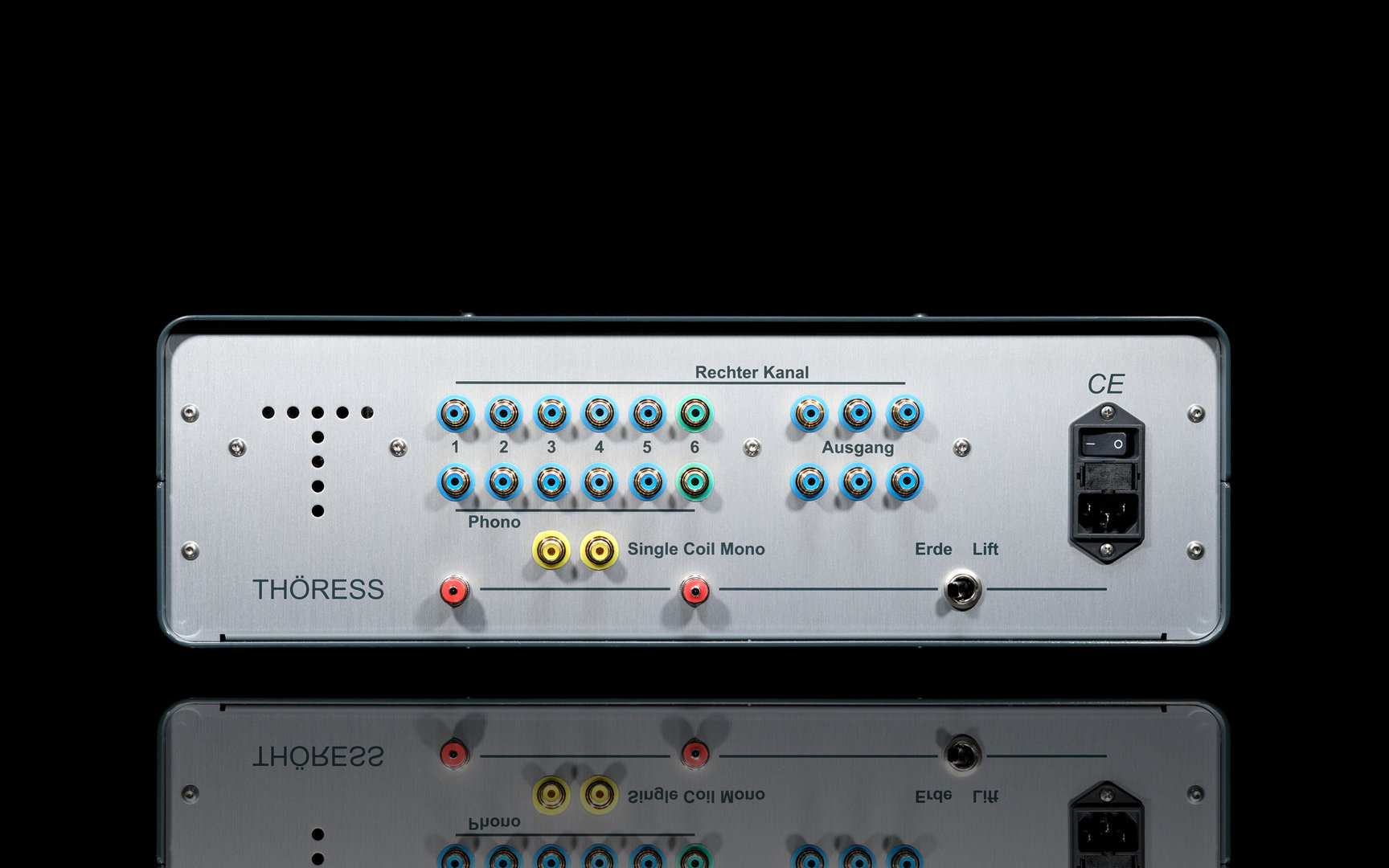

INPUTS
The amplifier comprises 6 phono inputs with gain pattern (5xMC+1xMM), five inputs
with 65dB MC gain and one input with 45dB MM gain (presenting a standard 47K
load to the cartridge). Alternatively, a gain pattern (1xMC+5xMM) can be
implemented on request. However, it is not possible to install an arbitrary MC+MM
gain pattern for technical reasons. The cartridge loading is
(100, 200, 300, 500, 1000 / 47.000) ohms and (500 ohm/47K, 47K, 47K, 47K, 47K).
on (5xMC+1xMC) and (1xMC+5xMM) units respectively. Other load values can be
easily installed on demand.
OUTPUTS
The output impedance of the Phono Enhancer is sufficiently low (around 300 ohms)
to simultaneously drive long cable runs and line inputs with an input impedance as
low as 10.000 ohms without compromising sound quality. The 3dB-down frequency
under 10.000 ohm loading is still well below the audio band (lower than 5Hz, output

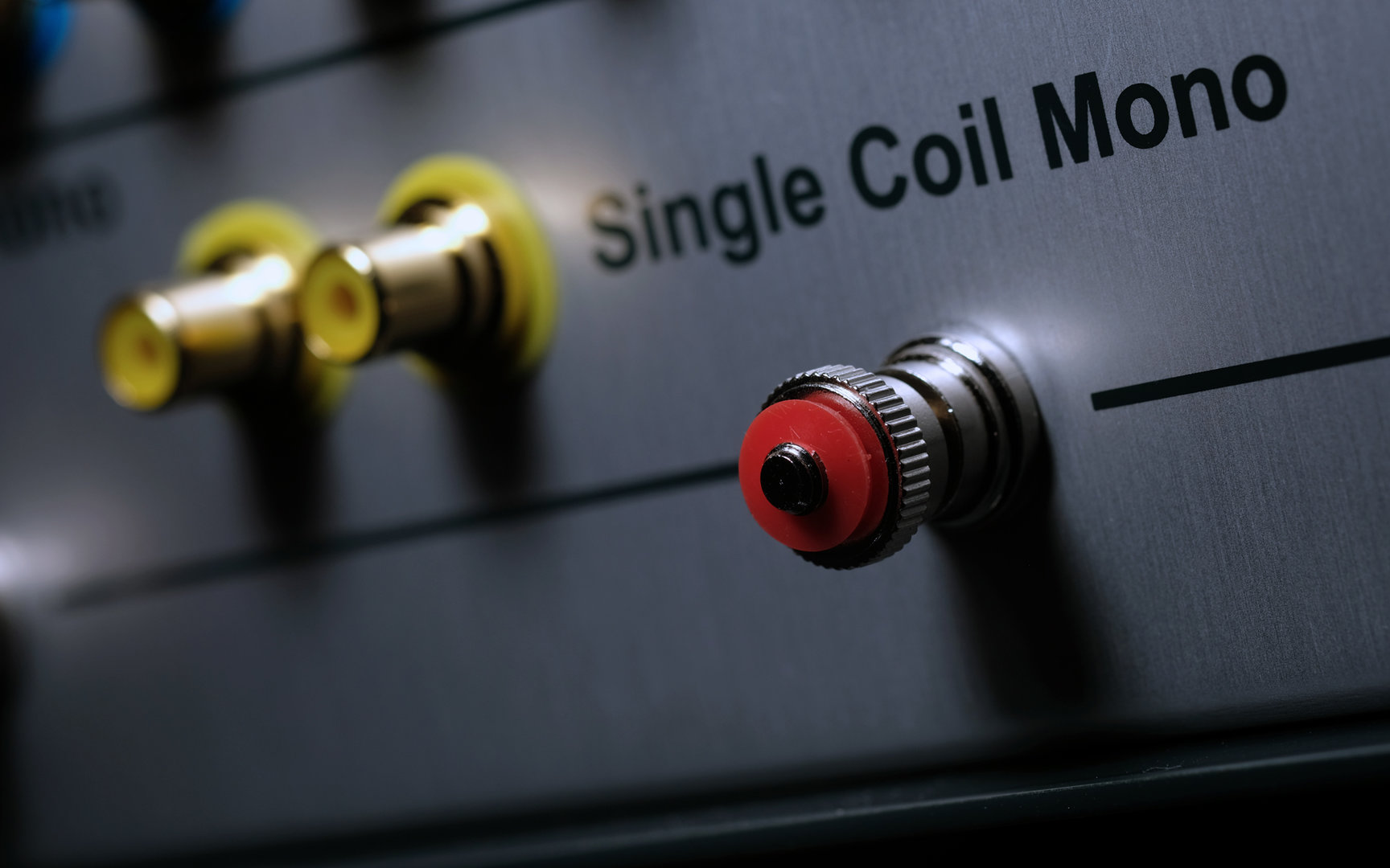

coupling capacitor 3.3MFD). The circuit outputs terminate in 2x3 RCA jacks
connected in parallel. This design choice is usefull for proper (hum-free) dualchannel
mono installation with single-coil cartridges, without involving inconvenient
addaptions. Please refer to the user manual for a detailed description of proper
dual-channel mono installation in the context of single-coil phono cartridges.
(2x12J5GT+2xPC86)
Decidedly ignoring the fact that many music lovers persistently believe in the myth
that balanced technology (and the associated cable configuration with XLR
connectors) is generally superior over single-ended concepts. Readers who want to
learn more about our view on balanced techniques and our general design approach
are encouraged to read the paper (THÖRESS - Behind the Curtain) available on
request.

OUTPUTS
MAINS TRANSFORMER
The Phono Enhancer is equipped with a proprietary mains transformer produced inhouse
to ensure the highest possible quality. This part has been specifically designed
for low body noise emission and low leakage. Nevertheless, it is mounted to the
chassis via isolation elements in order to eliminate even the slightest interference of
residual transformer vibrations with the circuit. Since the mains transformer is

Highly versatile vacuum tube phono preamplifier (phono equalizer).
6 phono inputs with gain pattern (5xMC+1xMM) and cartridge loading (100, 200,
300, 500, 1000; 47.000) ohms. Alternatively, a gain pattern (1xMC+5xMM) can
be implemented on request.
MC gain with state-of-the-art signal-to-noise-performance in purely active
operation mode (without the aid of step-up transformer gain).
Minimalist single-ended zero-feedback schematic with passive de-emphasis
installation utilizing (2x12J5GT+2xPC86) vacuum tubes.
Edge frequencies of the de-emphasis characteristic independently on-the-fly
adjustable within wide limits by means of three 6-position rotary selectors. Realto-
reap tape NAB and IEC equalization settings can be installed on aside the
phono settings on request.
Entire range of phono equalization characteristics used by the prominent record
labels throughout history can be activated by choosing appropriate selector
settings. Equalization settings suitable for 78-rpm playback included. Highly
accurate RIAA equalization with tone selectors in default position.
Subtle yet highly effective tone control facilities for restoring tonal imperfections
of the vinyl program, implemented without the aid of clumsy sound-degrading
conventional tone control circuitry.
3 outputs (RCA terminals) with very low output resistance.
