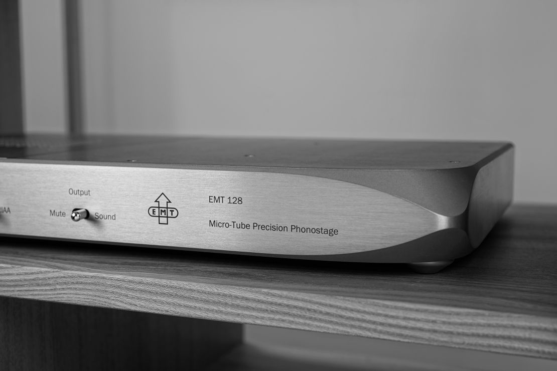

EMT 128
Kan bestilles med RCA eller XLR utganger

- Unique design concepts for best technical - and most musical-performance
- All tube amplification with integrated input- and output-transformers
- All circuits built-in into a dedicated case milled out of one solid block of special aluminum
- Advanced air-flow and anti-vibration control technology

The EMT 128
This new EMT phono preamplifier began life in 1985 as a project to replace the phono stage found inside the aforementioned EMT broadcast turntables. Mr. Huber told me he contacted the now-retired project leader and convinced him to complete the design's electronic component. Huber's team did the mechanical and vibration-control work. The printed circuit board is produced in Germany.
In function and appearance, the $12,830 - 128 is the opposite of the versatile, lab-like JPA 66. As for which is the cooler-looking design, I'd vote for both! The 128's sleek, low-profile chassis is milled out of a solid block of aluminum and utilizes "advanced air-flow and anti-vibration technology." It weighs 26.5lb.
The front panel features four toggle switches, one each for Off/On, Mono/Stereo, DIN 78/RIAA EQ (footnote 1), and Mute/Sound. The rear panel features one pair each of single-ended (RCA) inputs and balanced (XLR) outputs plus a banana plug–compatible ground lug receptacle on the right and an IEC connector and power switch on the left. Apart from a small identification plate, also on the rear panel, that's all there is on the outside.
Inside the chassis is a PCB populated with high-quality parts featuring a pair of Lundahl step-up transformers on the input side and a pair of Lundahl output transformers on the output side, between which are a pair of large Mundorf MCap ZN Classic Tin Foil "Audiophiler" capacitors. In between the step-up and output transformers are one trio per channel of Raytheon 5784WB subminiature, dual-pentode, wire-terminated tubes; EMT says these tubes were developed for "US missile technology."
There's no need to be concerned about tube availability. An online search shows that NOS (new old stock) 5784WB tubes are plentiful and cheap; I saw them for as little as $1.50. Online user reports claim great performance uniformity among tested samples and overall quiet. No doubt, in this critical application, HiFiction extensively tests each tube before soldering its bare wires to a small PCB fitted with pins that get inserted into sockets on the main board. Changing tubes, should it be necessary, is neither difficult nor time consuming and requires no soldering.
The instruction manual says the EMT 128 is "specifically designed for EMT MC cartridges," but it also states a range of useable cartridge impedances (12 to 30 ohms) and output voltages (0.3mV to 1mV). A pair of internally mounted jumpers lets you easily adjust gain to either 64dB (for cartridges with outputs ranging from 0.6mV to 1mV) or 70dB (for cartridges with outputs between 0.3mV and 0.5mV).

| Inputs: | MC, sensitivity 1mV on RCA |
| Outputs: | Line level 1.55 V on XLR |
| Overall Gain: | 64dB nominal / 70dB max. |
| Signal to Noise: | >70dB |
| THD & N: | <-40dB @ 1kHz and nominal level |
| Mode: | Stereo / Mono |
| Curve: | RIAA / DIN 78 selectable |
| Mains: | 230 VAC, 115 VAC or 100 VAC |
| Power Consumption: | 25 Watts |
| Operationg temperature: | 18…25°C / 65…77°F |
| Operating environment: | for indoor use only |
| Dimension: | 480x315x60 mm / 19x12.5x2.3 inches |
| Weight: | 12kg / 26.5 lbs |
