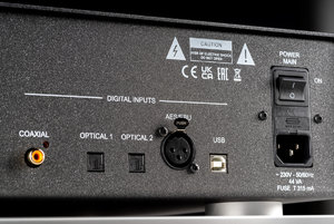

- thanks to used converters, it is possible to play files in PCM formats up to a sampling frequency of 768 kHz and for DSD format up to Native DSD512 via the USB input, thus covering most digital files that you can normally play, buy or stream.
- it uses the dual mono configuration of the ES9038Q2M digital-to-analogue converters from ESS Sabre, which ensure high sound quality.
- the analogue output is a buffer, which is solved by a high-quality electronic connection
- dual converter wiring uses separate signal paths for the left and right channels.
- there are seven digital converter filters for PCM format and one proprietary for MQA format, which is set automatically during MQA playback.
- the last (eighth) item in the digital filter menu “Oversampling Bypass” can be selected. But it’s not a digital filter, as it’s turning off digital filtering for the ability to compare audio without filtering…
- the signal from the digital inputs is processed by a powerful multi-core XMOS microcontroller with an advanced Multi-Core RISC architecture.
| Frequency Response at Fs=192 kHz | +/- 0,03 dB at 20 Hz to 20 kHz |
| Output impedance | < 200 Ω |
| THD+N 1kHz at 0 dBFs | > 0,008% |
| THD+N 1kHz at -6 dBFs | > 0,004% |
| XLR output voltage at 0 dBFs | 4 V RMS |
| XLR: SNR 20 Hz to 20 kHz at 0 dBFs | < 108 dB |
| RCA output voltage at 0 dBFs | 2 V RMS |
| RCA: SNR 20 Hz to 20 kHz at 0 dBFs | < 95 dB |
| Analogue outputs | 2 x XLR / 2 x RCA |
| Supported PCM sampling rates | 44,1k / 48k / 88,2k / 96k / 176,4k / 192k / 352,8k / 384k / 705,6k / 768kHz |
| DSD over PCM support | DoP DSD 64/128/256/512 |
| DSD Native support | Native DSD 64/128/256/512 |
| MQA support | Full MQA decoding by hardware from all digital inputs |
| S/PDIF Optical input | 2 x (24bit / 192kHz) |
| S/PDIF Coaxial input | 1 x (24bit / 192kHz) |
| AES/EBU input | 1 x (24bit / 192kHz balanced) |
| Digital to Analogue converter | 2 x ESS9038Q2M (dual mono) |
| Filter settings | 8 x digital filter |
| Display | LCD TFT |
| Tube complement | 4 x 6922 |
| Power | 230 V / 50 Hz / 44 VA |
| Dimensions (w x h x d) | 435 x 120 x 405 mm |
| Weight (net) | 12 kg |
