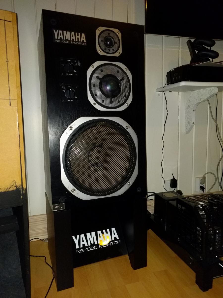

    Mine er monitor, og det finnes de som ikke er monitor.... (uten grill på bassr)
    På bilde står mine på stativer

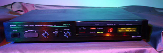

    har en gammel Yamaha dsp 1 liggende som er fra 80 tallet. noen som har vert borti denne før?
    vega jon
    11.03.2011
    1.416
    1.232
    bærum
    The Yamaha DSP-1 was a revolutionary processor of early home theater surround sound equipment, produced in 1985. The DSP-1 (referred to by Yamaha as a Digital Soundfield Processor) allowed owners to synthesize up to 6-channels of surround sound from 2 channel stereo sound via a complex digital signal processor (DSP). Much like today's home theater receivers the DSP-1 offered sixteen "sound fields" created through the DSP including a jazz club, a cathedral, a concert hall, and a stadium. However, unlike today's integrated amps and receivers, these soundfield modes were highly editable, allowing the owner to customize the effect to his or her own personal taste. The DSP-1 also included an analog Dolby Surround decoder as well as other effects such as real-time echo and pitch change.
    Most of the DSP-1's controls are on the unit's remote control. The reason, as mentioned in the manual, being that it was felt that adjustments should be done at the listening position. This can make it difficult for collectors to find a complete functioning unit, although there is at least one provider of aftermarket remote controls with duplicate programming for the DSP-1 if needed. In Dolby Surround mode, only 4 channels are active, with just the front main channels and rear surround channels operating, the forward surround channels being muted.
    Yamaha has kept the DSP prefix for many of its home DSP and audio amp/receiver products.

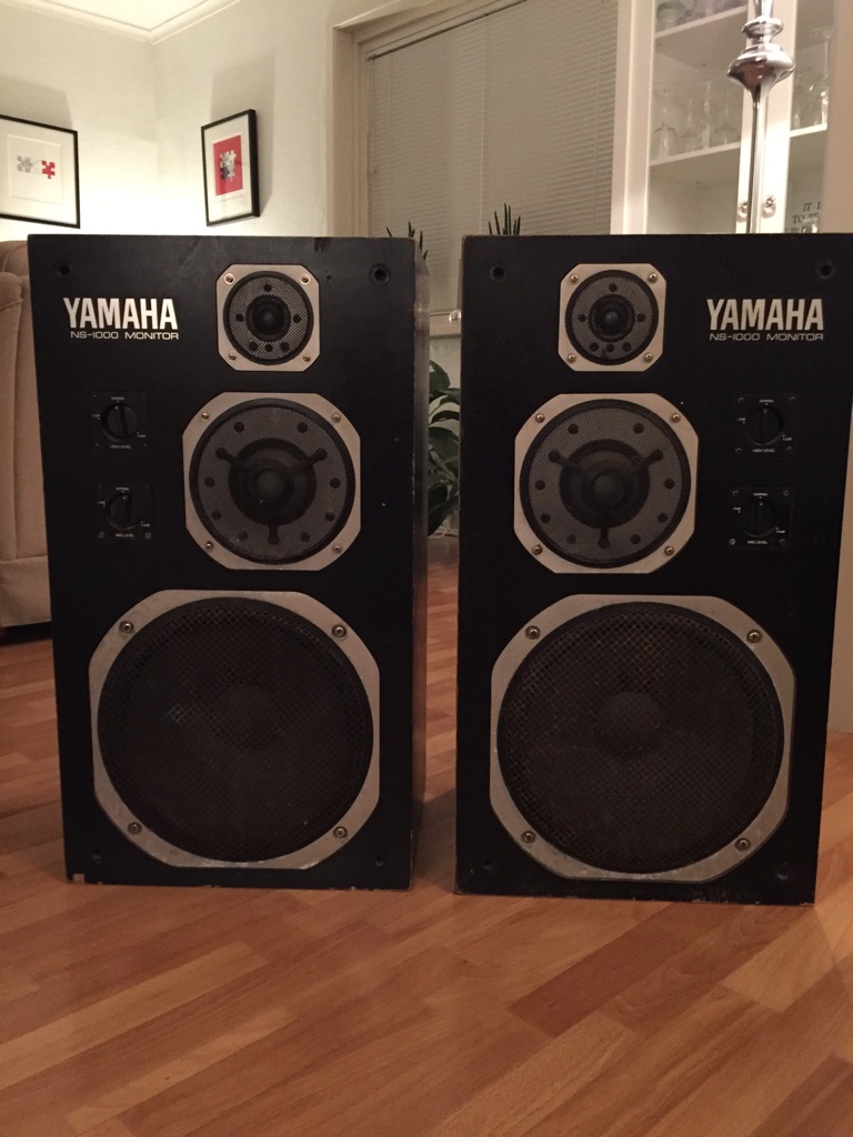

    Ser ut som dei har hatt ein noke fuktig tilværelse. Rust på gitter og skruer. Håper alt fungerer som det skal teknisk og mekanisk. Finnish skal vi altids få orden på.
    Vis vedlegget 358757
    Hei disse får du fint til skall du se.Du ser jo at jeg har fått dette til så da kan du og ;) .Dette er et kupp du har fått deg her ,for den prisen så kan du pusse disse opp og sitte med gooood fortjeneste på dem ,så disse bør du fikse opp.Gratla med Yamaha NS 1000 da.Viss du ikke ser synet og fikse dem opp ,så er det mange her som du kan selge dem til.Da kan di levere dem til meg så kan jeg mulikt få til noe fiks her ;) .Og viss ikke noen vill se synet på dem kjøper jeg dem tvert.;) .

    Ja du kan glede deg til disse ja.Jeg derimot slite med noe silicon dritt som stadig kommer fram på disse ,under lakkering.Veldigt iriternde,jeg skall prøve en gang til og se om jeg har fått bukt med dritten .Salo eller edikk fønker fint .Jeg får håpe det blir bra nå da.Blir dyrt i lengden dette viss må gjøres en gang til dette .Men jeg er villi til og bruke noen kr på disse ;) .
    MVH:Tønnes
    Tønnes
    22.02.2012
    790
    513
    Flekkefjord
    54
    Ja da ble det litt lakk ,og fikk bort silikonen som stadig kom fram,men nå fikk jeg bokt med dette med en del salo i vannslipingengs vannet :) . Her er noen bilder av dagen i lakkboxsen ,testa og den nya lakkmaska med friskluft,helt konge ,og ha alt i belte .Ikke var den billi ,men den fønka helt toppers .
