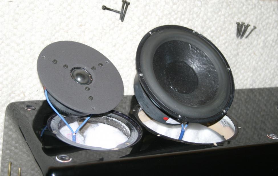

Merlin MMM & MXM Model NewsAugust, 2012
Improved Performance
Merlin speakers have been produced for nearly three decades. During this time there have been many refinements resulting in very sophisticated and mature designs. None of our past upgrades can rival this one because of the Cardas Clear geometry cable that we use to wire the Master speakers, jumpers and RC networks. These products have been raised to a completely new performance level that we never thought possible. There are profound improvements in clarity/resolution, bandwidth, coherence, continuity, focus, expanse and the blackest back ground we have ever experienced. All of this with exceptional musicality and neutrality! We feel that offering varied models that are not the best we can produce just to create a price point, as most manufacturers do, is not in the best interest of our customers. Therefore, from this point on all of our speakers, studio and premium finish alike, will be wired with the Cardas Clear geometry cable…
Nå leverer Merlin et kit for oppgradering som består av Cardas Clear geometry kabel, jumper wires, Zobel network (Duelund capacitor), Cardas loddetinn (Blyfritt) og annet nødvendig materiell.
Elementene må ut. Bakplate med terminaler og delefilter komponenter må også av.
Når kablene er byttet og alt tilbake på plass, trekkes alle skruer til med spesifisert moment.
Ingen tilfeldighet at dette spiller fantastisk!
