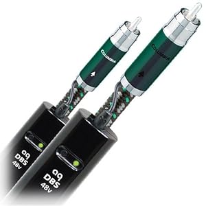

Mellom DAC og pre-amp bruker jeg Audioquest Columbia DBS 1m RCA. Kjøpt på impuls og koblet til anlegget, den gjør jobben helt greit. Audioquest har et patent som de kaller for Dielectric Bias System som lader isolasjonen mellom positiv og negativ leder. Dette gjør etter sigende at støygulvet senkes ytterligere og kablene for overført signalet helt uten forstyrrelser fra utsiden. Det hele skjer ved hjelp av et batteri i en aldri så liten boks på hver kabel.
Skikkelig hightech det her :)
Mer om DBS her:
The Dielectric Bias System (DBS) Difference
A constant 48-volt charge on Columbia's insulation yields a huge performance leap. When insulation is unbiased, its dielectric properties cause different amounts of time-delay for each frequency and each signal level, as if each were a coin dropped in different thickness/viscosity shampoo or engine oil.
Similar to how the earth's magnetic field makes all compasses point north, the AQ DBS system creates an electrostatic field which causes the molecules of the insulation to all point in the same direction. This minimizes the multiple nonlinear time-delays. Sound appears from a surprisingly black background with unexpected detail and dynamic contrast.
Because DBS battery packs are attached when Columbia cables are assembled, Columbia does not require any additional run-in period. Because there is no "load" on the batteries, they will last for years. A test button and LED allow for occasional verification of battery performance.
