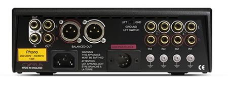

  • Cyrus Phono Signature, fire innganger, RCA inn, RCA/XLR ut, 1200 pund
