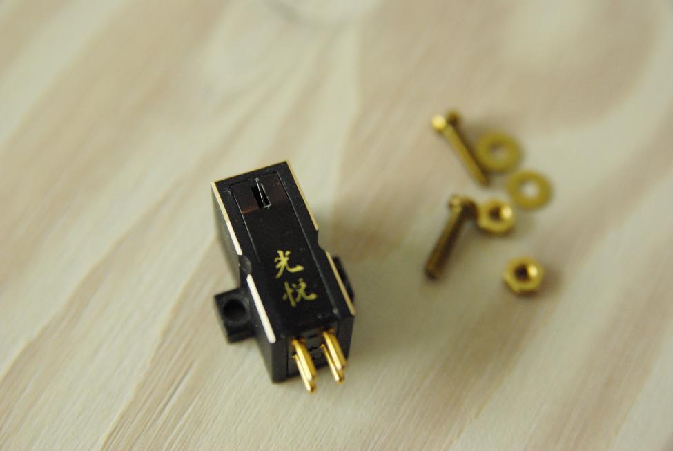

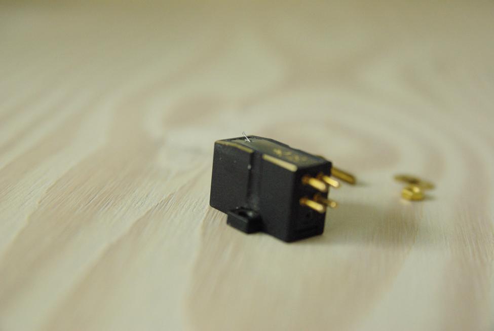

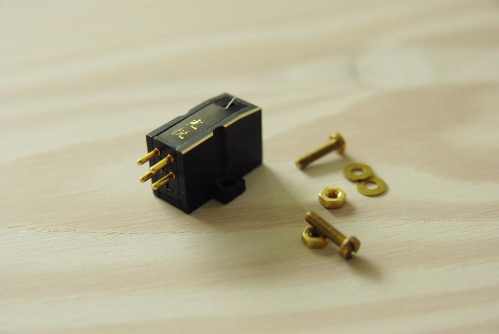

    Kan ju skriva vad de gjort också.
    "Complete overhaul to include examination of coils, suspension, remove magnetic particles about coil former, re-tip boron cantilever with ultra low mass Paratrace diamond and audition."
    "During auditioning a tracking weight og 2,0/2,20 grams was found sufficient and the cartridge performed very well coping with all heavily modulated passages without loss of sound quality. Final checks using the EMI Technical Test Record TCS 101 together with Ortofon TC310 analyser revealed all frequency bands to be stable."
    Prisen kom på £330,00
    Vermin inspirerade mig ikväll:
    tkr
    27.03.2007
    21.745
    34.470
    Nede i fjæresteinene
